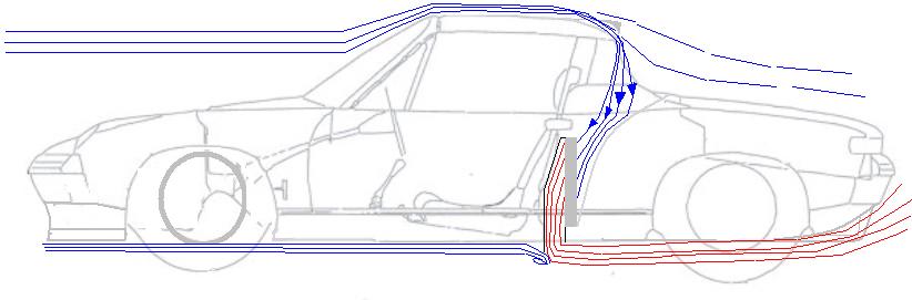

My current plan is not to take air from under the car, but instead from above. I will have some kind of subtle scoop integrated into the trailing edge of the roof line. To exhaust the heated air I am going to suck it out the bottom of the car by means of accelerated air flow created by a flat bottom and rear diffusor. Thats the theory at least (IMG:http://www.914world.com/bbs2/html/emoticons/biggrin.gif)
I really want to develop something for the engine bay that can handle more than just a naturally aspirated EJ25. Someday I may want to put in a turbo motor.

Here's the basic idea... I have no idea if it will work (IMG:http://www.914world.com/bbs2/html/emoticons/wacko.gif)

well hurry then, my plan is for a turbo, and I don't have to be subtle with the scoop.... How about a reverse scoop like the suby hood scoop turned 180???

IIRC the porscheru had a scoop hanging down below the car to grab more air for the radiator... also, why not vent the front firewall and use the heat tubes to carry more air back...

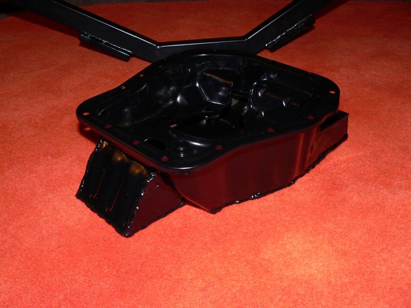

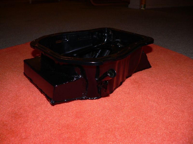

So I neded up doing a water test of the oil pan. I filled the pan with soapy water and let it sit for a few hours. The pan ended up having two small pinholes, which I fixed by filling them with braze. I bought a MAAP Gas torch and brazing rod at the hardware store which worked well. The leaks are gone and so yesterday I did some serious powder coating.
The oilpan will probably need some more powder, as I couldn't get full coverage inside. If I can't get powder to work I'll slosh around some POR-15. The bottom of the pan on the outside ended up a little thin on the powder so I'll add some more and re-bake.

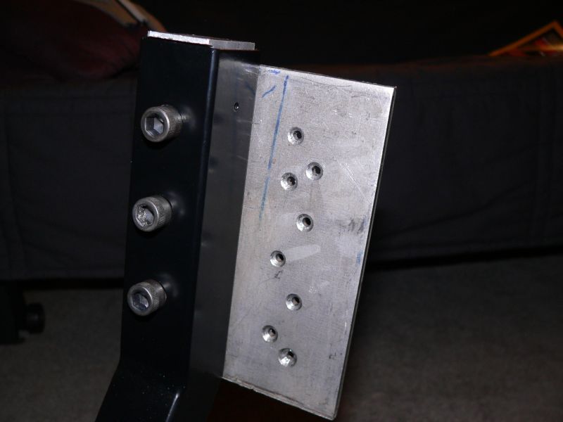

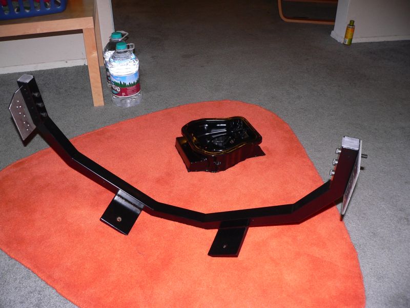

The engine bar came out perfectly, and I drilled holes through the almunim blocks to finish it up. The inside of the bar still needs some POR-15 and a drain hole at the bottom, but otherwise its done.

TonyAKAVW
post Feb 6 2006, 12:01 AM
Post #255
That's my ride.
Posts: 2,151
Joined: 17-January 03
From: Redondo Beach, CA
Member No.: 166
Those are 3/8 inch diameter bolts.
The bare steel plate get welded to the longitudinals near the trunk firewall.

Got some work done tongiht on the engine. I'm starting to get it all put back together. I put the intake manifold and throttle body on, as well as the injectors and runners. Also, the water pipe that conencts one side of the engine to the other. The oil tank is on, as well as the shortened pickup tube. I managed to tighten all the bolts around the perimeter of the oilpan. This was based on a lesson learned from Scott's oilpan where he ran into problems getting a few of the bolts tightened. I put some effort into designing my oil tank mods such that the bolts were accesible, at least by some means...
The pulley on the front needs torqueing down but after that I can install my custom alternator bracket, and the alternator.
Anyway, here's the modified pickup tube. I basically cut out something like 1.5 inches of the tube and brazed it back together. Across the bottom of the pickup tube, Bondo welded a piece of welding rod. This is an idea I stole from Outback Motors. They do this so that if the pan gets bashed in, something keeps the intake opening somewhat clear.
