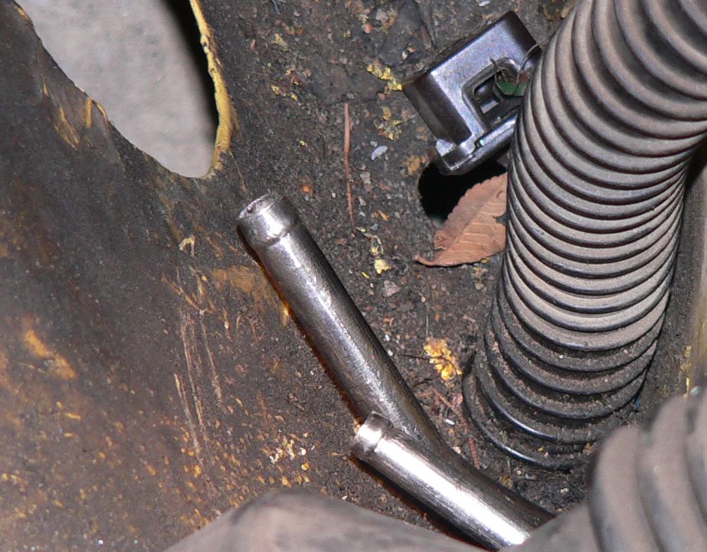

Here are the part numbers for the stainless steel tubing...
8989K48 Type 304 Stainless Steel Welded Tubing 3/8" Od, .319" Id, .028" Wall, 6' Length $8.45 each
8989K46 Type 304 Stainless Steel Welded Tubing 5/16" Od, .257" Id, .028" Wall, 6' Length $7.63 each

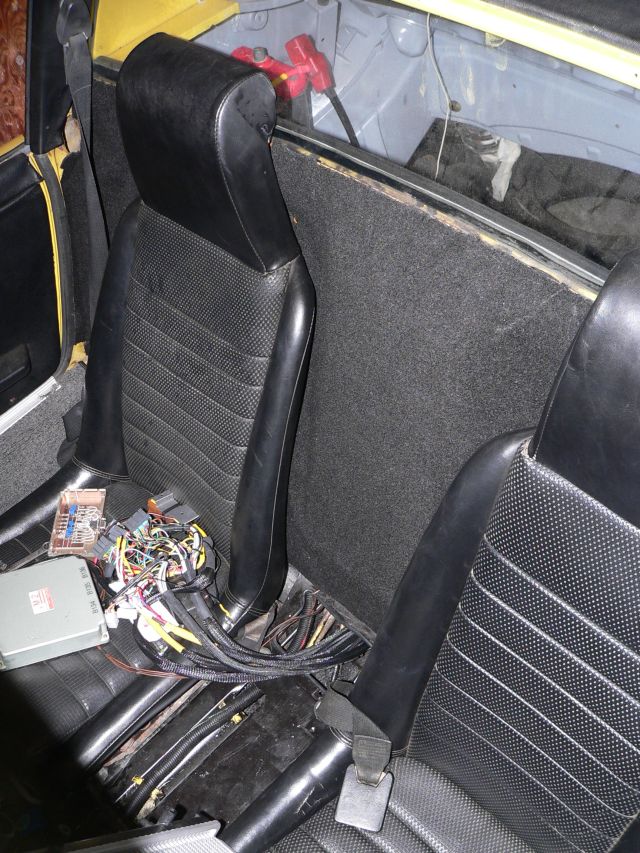

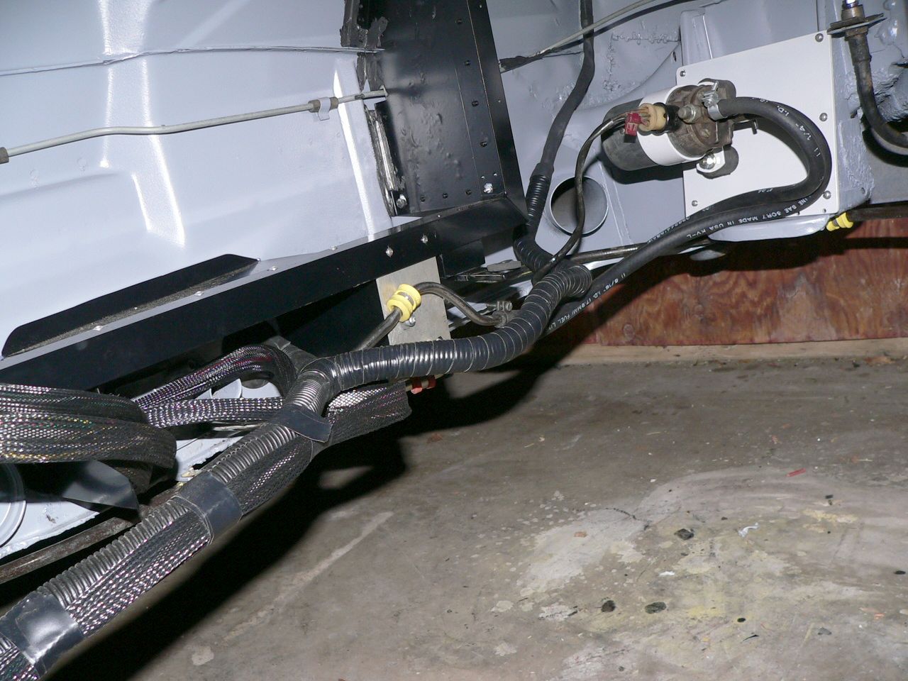

More progress to report.
Gas tank is back in, fuel lines are connected, fuel pump is conencted, ECU is mounted, shifter work progressing.
After finishing the stainless steel tubing installation, I put the gas tank back in, reconected everything including the pump in its new location. It sits below the battery tray, on the old engine mount.

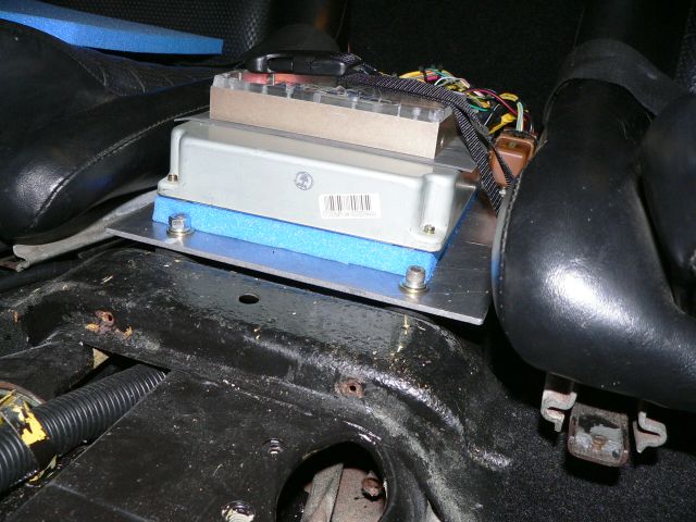

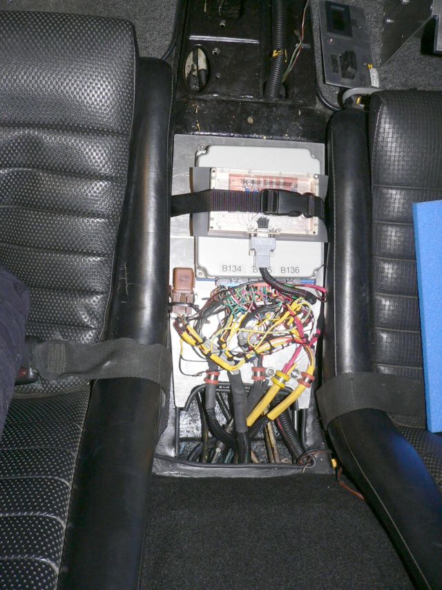

The ECU is now mounted in the car. It is strapped to a 1/8 inch aluminum plate which I cut to fit between the seats. The plate is held onto the car with rubber isolation mounts, much like those used for the fuel pump. The ECU is then strapped to the plate using a compression strap I bought on the way home from work today at REI. The ECU sits on top of a 1/2 inch thick piece of foam rubber which I cut from a "sitting pad" that I also got at REI. On top of the ECU is the sensor simulator box. Sandwiched between the two is a piece of special silicone rubber made for reducing vibration on the inside of submarine bulkheads. (its really amazing what you can get shipped to you as free samples from companies).
So the ECU is now as safe as can be from vibration (IMG:style_emoticons/default/biggrin.gif)
Wiring to the ECU comes in through an enlarged hole to the center tunnel. The cables are then held in place with insulated wire tie-downs. Still left to do is mount the volt meter/OBDII conenctor plate, but that can wait.

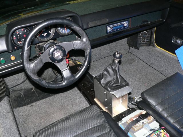

The shifter should be bolted down to the center tunnel soon. As usual I used a lot of aluminum and screws to make the pedestal for the shifter.
-Tony

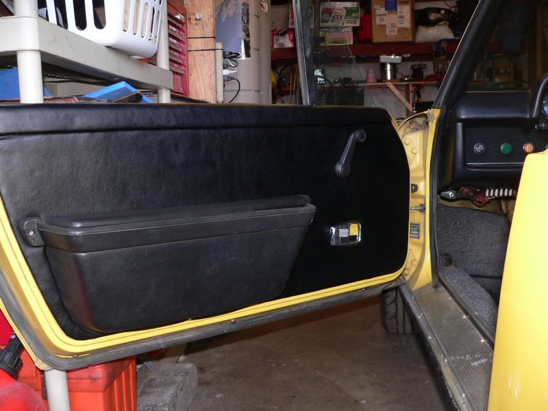

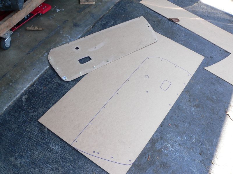

First project this weekend while I was waiting for parts was to recover a door panel. The panel was in bad shape so I bought some new board and cut it out using the old one as a template. Took quite a while to get the board nicely cut out, but it came out decently.

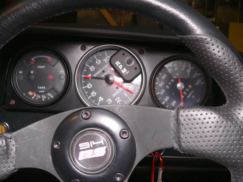

New tachometer sitting in place. not yet hokoed up. I guess now I need to get spunone's guage bezels for the remaining stock gauges.

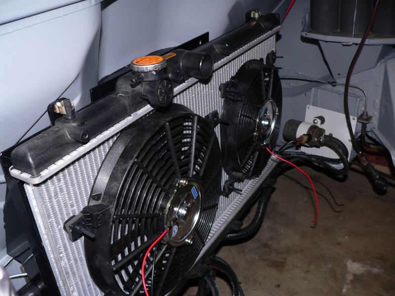

Also got the radiator fans in place. Need to order some weatherpack connectors from Jeg's to wire them up, and put relays in the relay/fuse box.
It looks like I could have fit two 12 inch fans on but I didn't think it would work when I was ordering them. If I have heat problems that will be the first upgrade. I could then use this 10 inch fan on a motorcycle radiator or use it on the engine grill, etc.

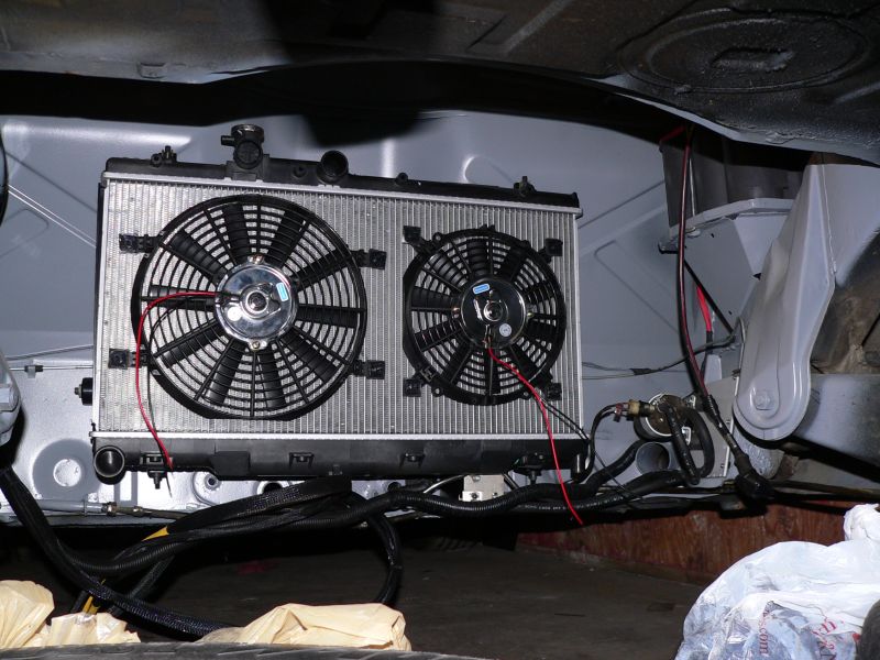

Last one for tonight...

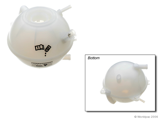

Today I picked up a coolant expansion tank and cap from Importedcarparts.com (who happens to be down the street from me). This tank and cap are standard equipment on most Audis and VW made in the last few years. Its a really well made tank, far nicer than the ones you can get at FLAPS. Mounting may be trickier, but I'm sure I'll figure out something. The best part about it is that its high quality and cheap! $16 for the tank and $5 for the cap.
