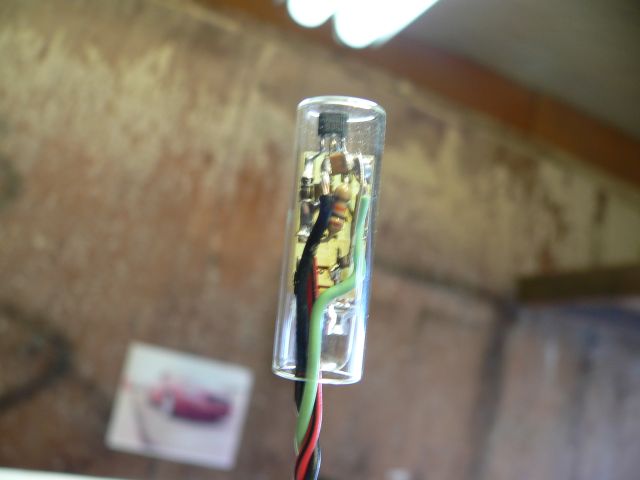

I built a Vehicle Speed Sensor (VSS) this weekend. It uses a Hall effect sensor from Melexis Semiconductor (its a German made part!) and cost me a whole $5 to build. This compares to $80-$100 for the stock Subaru VSS. I still have to figure out where to mount magnets (requires one of polarity, the sensor is a 'latch.')

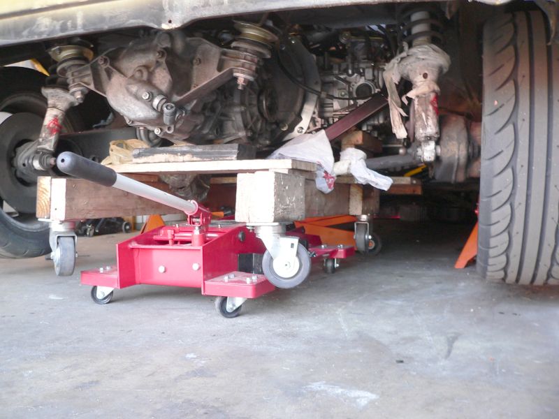

Today I decided to put the engine and transmission into the car to check for clearances and see that things fit. Well, things don't fit (IMG:style_emoticons/default/sad.gif)
Here's a list of issues I need to take care of:
1. Alternator runs into part of the radiator. Need to lower the alternator and get a shorter belt. Easy fix.
2. Radiator fans are too close to the crank pulley and alternator. Need to put fans on the other side of the radiator. Another easy fix.
3. Intake simply doesn't fit. Need to cut some of the tubing to bring it in closer, probably need to redo the bracket I made. Not so easy fix, but not a show stopper.
So thats pretty much it for fitment issutes. I still need to find a good location for my coolant reservoir. Once I have the engine in and mounted up I'll work on making up a bracket for it.
Other things I noticed while the engine was in the bay...
The engine cover shroud will really have to cover the whole engine. I'm thinking a large sheet of thin aluminum will do the trick. This will keep rain off the engine.
Lastly, I picked up a couple more 12 inch radiator fans at an electronics swap meet yesterday for $5 a piece. These are going to go on the engine bay lid to help with cooling. Its going to be cramped, so I might only get one in.
Hopefully the new flywheel and pressure plate, clutch etc. comes in early this week. Once I get those installed, the engine/trans will go together for good (until I realize I need to adjust it). Assuming all that happens and I fix these fitment issues this week I may be ready for a fire-up next weekend. Chances are though it will be two weeks. These issues will all take some time to figure out, and I've never installed a clutch before.

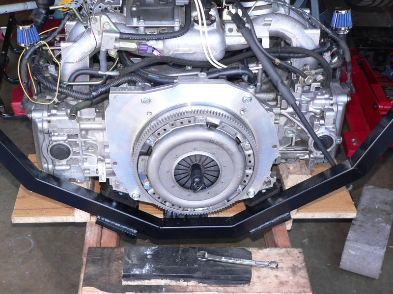

Getting closer! Yesterday I installed the new KEP flywheel, Sachs clutch disc and pressure plate. I was about to install the throwout bearing when I discovered the ball cup bushing is totally wasted (someone should make a bronze replacement) and the piece that holds the clutch arm to the ball was wasted. Additionally I found that two of the bolts I was using to hold the adapter plate on were too short, so I've got to get a couple more of those before putting this thing into the car.
The radiator fans are fixed (re-arranged them) and the alternator bracket is fixed (need new belt still). Intake and coolant tank bracket fabrication began as well.
First picture is my Vehicle Speed Sensor (VSS) that I made. As a troubleshooting aid, I have a green LED inside this thing. This way I can look to see if the sensor is working rather than trying to measure a signal. Still need to seal the thing with silicone. Also need to make a bracket to hold it onto the transmission. If I someday go with an electronic speedometer I wil get rid of the stock speedo drive cable and modify the right angle drive to work with this sensor, or maybe even fabricate a new sensor. I'm all for getting rid of mechanical cables.

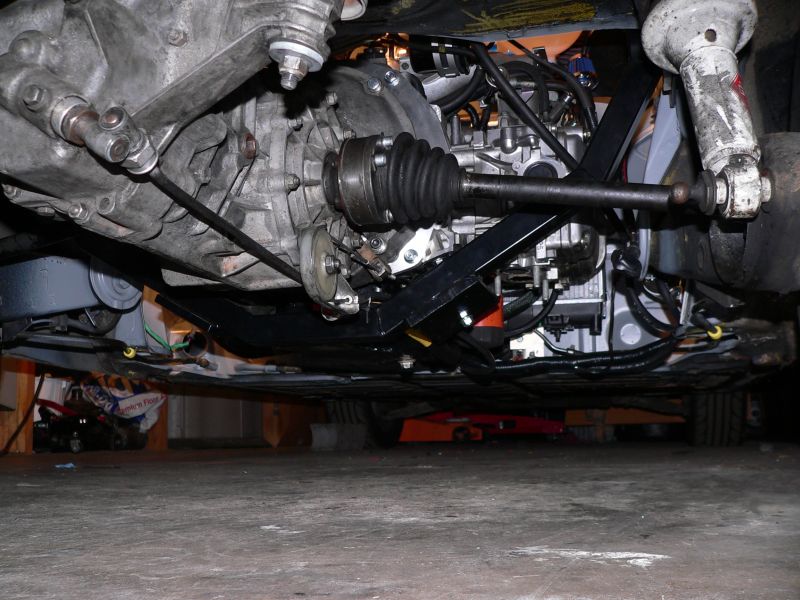

Installed engine and transmission - fixed the mounting plates and installed the aluminum shim.
Installed the starter
Bolted up the CV joints to transmission - new bolts, correct lock washers, gaskets

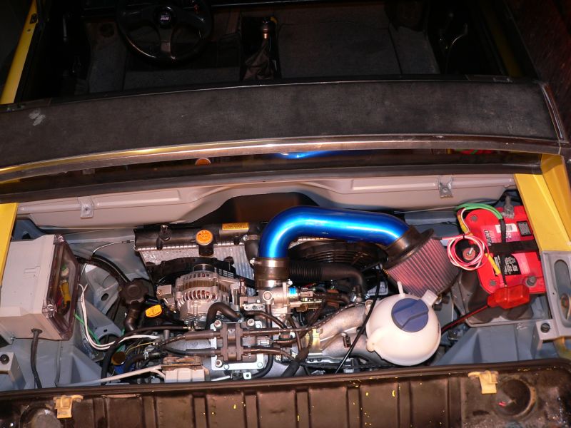

At long last, the moment we (or at least I ) have been waiting for....
IT LIVES!!!! (IMG:style_emoticons/default/clap56.gif) (IMG:style_emoticons/default/clap56.gif) (IMG:style_emoticons/default/clap56.gif) (IMG:style_emoticons/default/boldblue.gif)
Its noisy but it runs great.
Only had a few wiring issues to take care of. There was a +12v line that was connected to ground, and blew a couple fuses. Found that pretty quickly and then discovered I had another short inside my sensor simulator box. Melted teflon smells funny. So I disconnected that wire, grounded the neutral position sensor, and fired it up.
Here's a video.
Engine startup
The sound isn't great, but you get an idea.
-Tony
