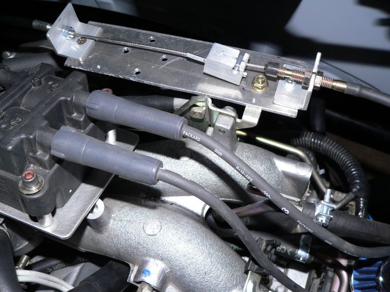

Last night I figured out the problem with the accelerator cable. Turns out that there were two things wrong. First, the throttle cable was wrapped around the clutch cable. As Napoleon Dynamite would say 'FRICK'N IDIOT. GOSH!'
Secondly, the carpet seems to have been causing problems. So I'm going to cut out a couple small areas where it seemed to be binding up. I also lubricated the three ball/cup bushings. With those three things done the throttle works great now.

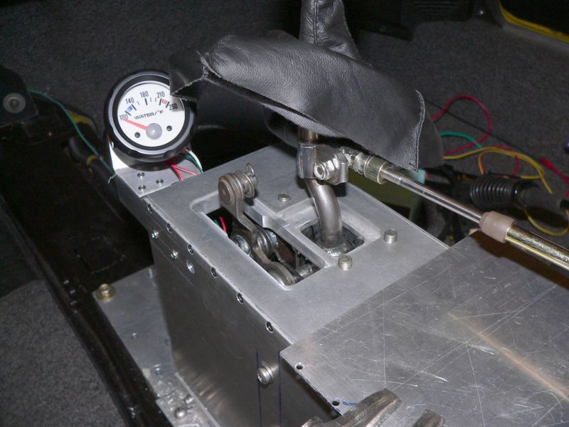

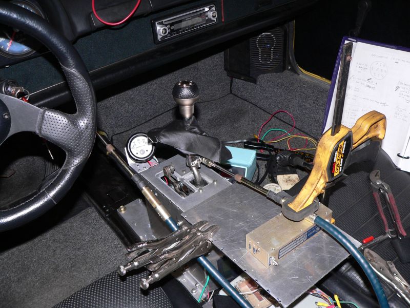

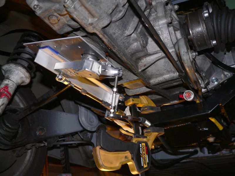

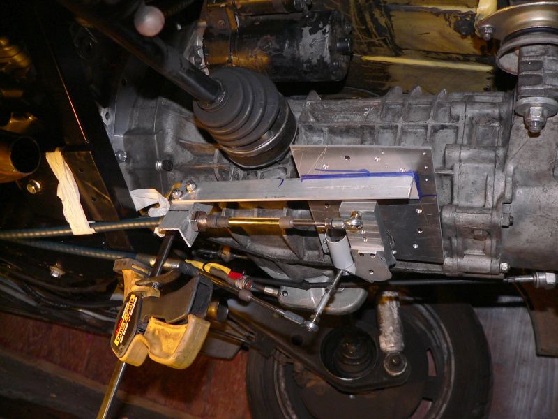

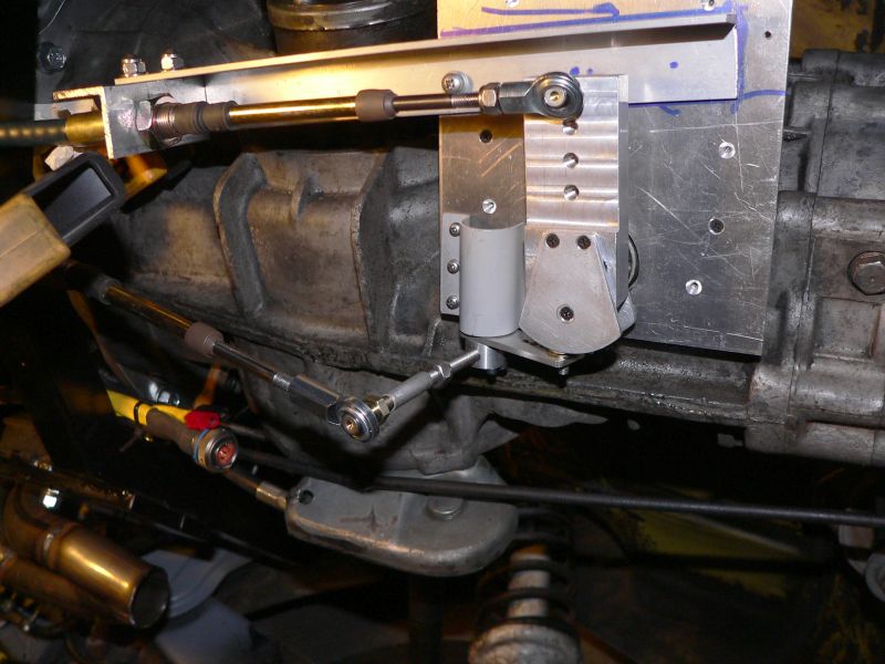

As expected the cable shifter cables arrived today, as well as the last part I needed machined (THANKS PHANTOM914). So right after I got home from work I started getting the parts put together and the cables installed. Didn't quite finish but I got half the gear selection working. I figure another 4 hours and this thing will be fully functional.

Couple more pictures. Also the linkage between the Subaru and 914 throttle cables.

So far the forward-backward action on the shifter is great. The only slop is from the transmission itself. These cables are humongous. I definitely didn't expect them to be as big as they are. However they both fit through the original shift rod hole with no problem. I've still got a couple brackets to make and need to take care of the in/out movement (in the pictures its hooked up but rather poorly). So Saturday I'm expecting to try this thing out on the road. It won't have an exhaust and undoubtedly the ECU will put the engine in 'limp home' mode, but I should be able to get an idea of how the shifter works.

I would suggest smaller quick-grips on the transmission end, otherwise ground clearance may be a problem.
Also, looking at the first picture, I think the RF amp gain may be a little low for this application. Maybe you can find out which amp is included in the Renegade kit and use that one. No sense reinventing the wheel.
Otherwise, good job!

In the first pic, he's using an RF amplifier under the quick clamp, as a spacer. It was a nerd joke. (IMG:style_emoticons/default/biggrin.gif)

Gosh, doesn't everyone have junk bins full of surplus electronics?
Well, its not just a function of gain Andrew. This amplifier has a particularly high IP3 and low noise figure. For my shifter I want to make sure my adjacent channel interference doesn't saturate the front end.
-Tony

OK. I was just trying to save you some trouble, but it looks like you thought this out well enough.
Andrew

quite the tower for the shifter!
