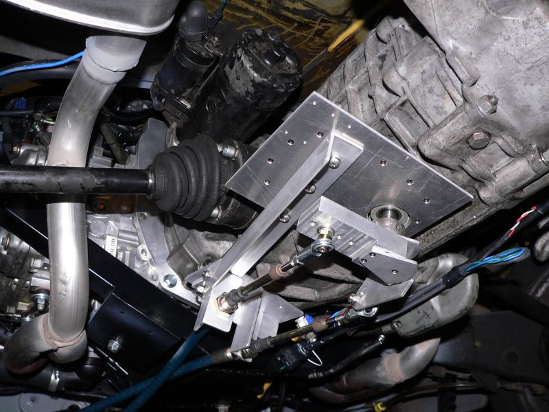

I redid the linkage setup for the side-side movement today and it looks much better, doesn't hang down as far. The other thing is that this shifter stuff sits roughly between the two wheels. Its highly unlikely that a speed bump would affect this stuff.

2. Shifter is backwards! 1st is Rev. 2nd is 3rd, 4th is 5th. The pivot point for the side-side movement is on the wrong side. This is a simple fix, just relocate the bearing and flip over the linkage.
3. Side-side movement is touchy. The range of motion on the shifter is small. I think I need to lengthen or shorten a lever arm somewhere.
4. Getting into 1st is hard. I'm not sure if this is a function of the shifter mechanism or the transmission. At this point its hard to tell. The transmission has been sitting for some time and I don't know its condition other than what I was told (that it was in really good shape). There was no grinding from bad synchros etc., but this is definitely something to investigate.

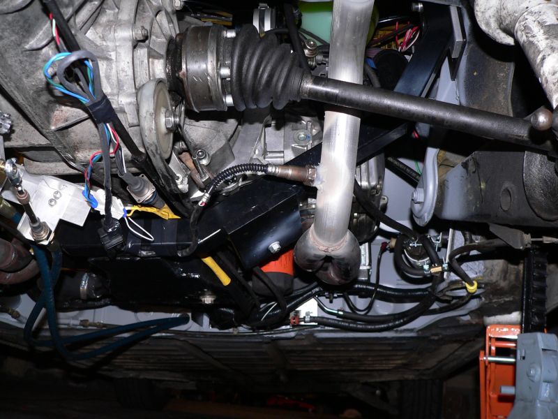

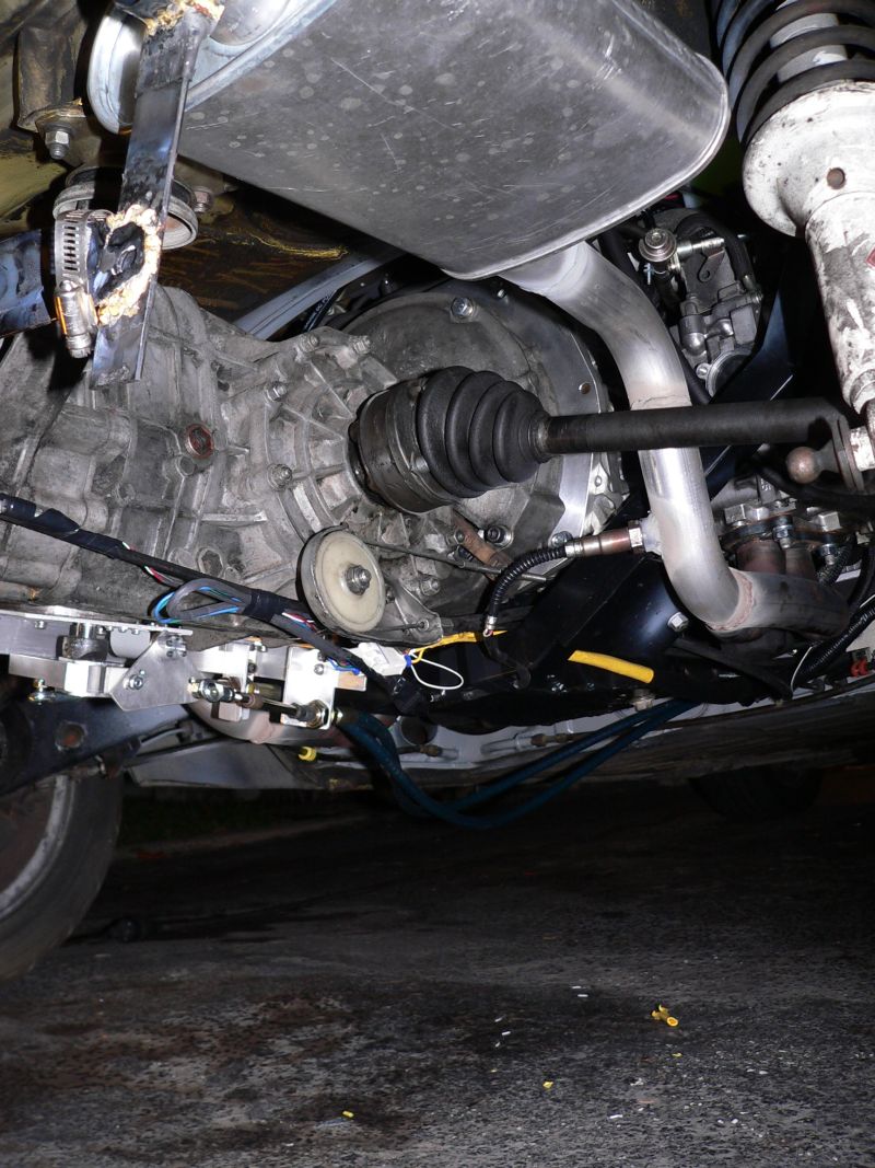

Haven't updated this in a while and I've gotten a lot done.
In summary, I drove the car to work last week and it had several issues. The shifter fell apart, the engine overheated, and it went into limp-home mode. Also the tachometer was showing the wrong numbers, and the alternator wasn't charging.
The cooling problem was fixed by replacing my temp sensor splice with a piece of metal pipe instead of plastic that melted out of shape during the overheat event, as well as bleeding air out of the cooling circuit. I tested the cooling system and it cycles properly now.
I haven't had enough time behind the wheel to see how well it cools, but in anticipation of it not cooling enough I have begun modifying the engine bay lid for a pair of fans to bring in cool air from above.
I cut the two wires on the tachometer for the 4-cylinder engine operation, but it seems to be reading about twice as many RPMs as it should. I'm wondering if I should configure it for a 6 cyl engine. Probalby will check NASIOC or Autometer's web site for this.
The shifter has been fixed in two ways. First, the nylon plastic piece that raises or lowers the shifter bar into/out of the transmission has been lengthened to keep it from falling out. The bolts that hold the shifter arm to the shift rod came loose and I think I need to replace them with cap head scerws and loctite them in place.
The alternator is now charging properly. I ended up replacing the alternator, but when the new one didn't work, I knew I had wired up something wrong. The easy fix was to wire the remaining wire to the generator light on the combination meter.
The remaining biggest isue is the limp-home mode that its stuck in. It refuses to go above somewhere around 4000 rpms. After disconnecting the battery for a while it seems to reset the ECU and I can drive a short while until it comes back. Getting this stuff fixed is one of my priorities this week. Those last 2700 or so RPMs give a LOT of power.

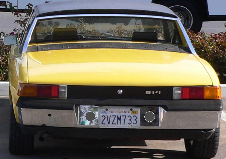

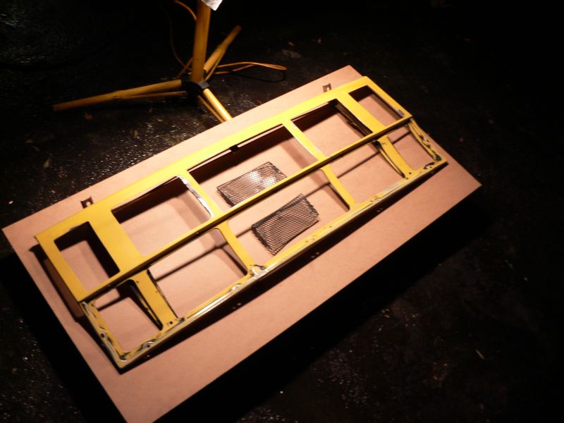

I made a bunch of noise today by cutting holes in the rear bulkhead and the rear trunk for the exhaust S-bends. These S-bends will take exhaust from the mufflers to exhaust tips on either side of the bumper. After I get everything working I'll have to weld u the rear trunk to cover the exposed exhaust pipes.
Its looking like getting to the German Autofest with this car is goign to be a close call. I was hoping that this weekend I would fabricate the diffuser and really get the cooling system workign well enough for the toughest part of the trip, the ascent of the Sepulveda Pass, and back up on the back side.
And now, some pictures.
-Tony

I'm curious about the exhaust. I know you're got the outback headers, and the pic shows the tube going over the axle (nice) and through a muffler. I was suprised that you needed to cut the trunk - was this so you could use stock bends ? I haven't poked my head "down there" for a while, but I thought that there would be room where the stock muffler is located to run to tailpipes w/ no cutting. When you get time to snap more pics, I'll be eager to see 'em.
p.s. Glad to hear that the cooling bugs are working themselves out.

I had to cut the trunk just at the very back because I am having the exhaust exit through the bumper, as in this modified picture...
I'm sure it will look better in real life..

nooooooooo not thru a chrome early bumper!!!

Nonono, the chrome early bumper is no longer in my posession. Thomas has it now. I'm going with fiberglass Getty bumpers. Gotta pick those up tomorrow or thursday.
-Tony
