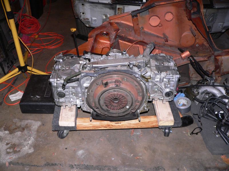

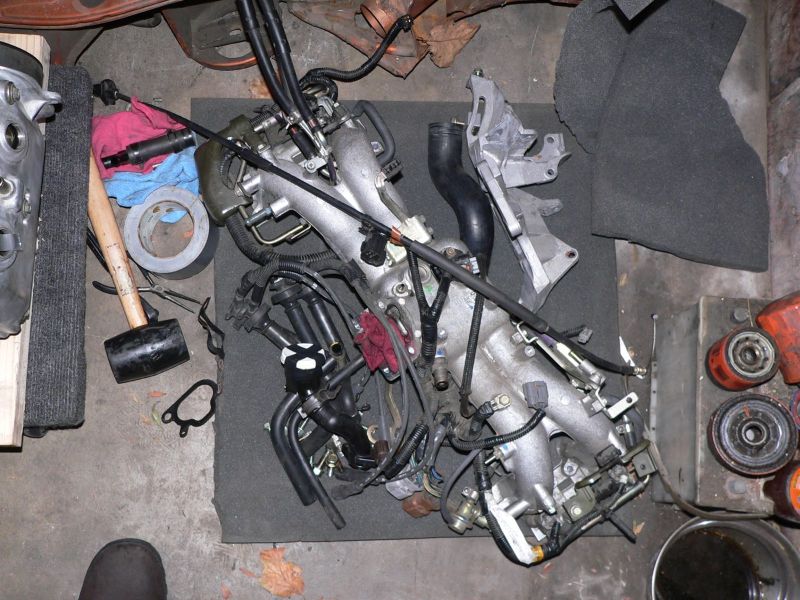

In order to get the engine out of the car's trunk easily I removed the alternator, brackets, and the intake manifold/injector runners/throttlebody assembly aka "baby alien."
Its stunning how much the EJ25 looks like a type 4 engine, albeit 30 years more modern.

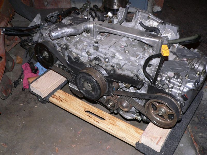

Baby Alien or a Four legged spider??

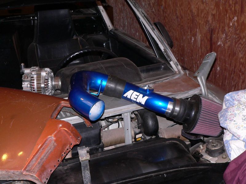

Bright blue powder coated rice. That must be good for like 50 HP.

Needs a new timing belt cover. Probably a good opportunity to put on a new timing belt.

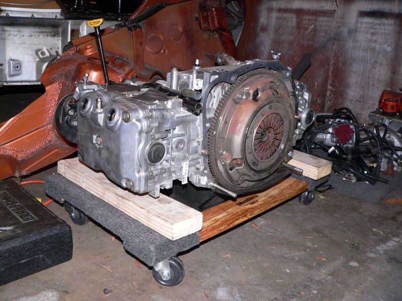

The Business End.

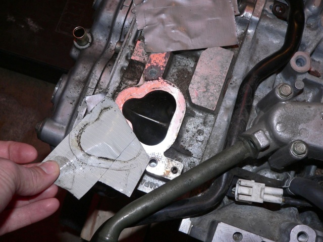

Intake port. Having only ever taken apart a type 4 engine it was interesting to see how the port is split into two and how the injector has two outlets at a corresponding angle as well.

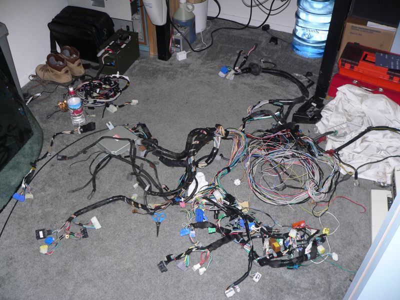

I began the task of undoing the wiring harness tonight. It appears there are basically three sections to it. One that appears to be mostly within the engine bay, one for the dash area and another that I haven't yet figured out. The person who pulled the harness out was good enough to label a bunch of the conectors with what they went to. This was helpful in determining which harness does what (in general). I'm going to have to find a schematic somewhere, but this seems doable. A few conenctors will need replacing and a few wires will need splicing due to a small amount of damage during the acident that killed the car.
Its a bit premature to be doing this, but it looks like its going to be a fairly time consuming task. I believe one of the important things to do is come up with a new schematic for the electrical system of my car, as it appears it will be quite different than stock.

Hey tony, don't forget the timing belt is partly shredded. You definitely want to replace that before you put the engine in the car.

I've just noticed something strange: why does the engine have one plastic timing and the other one metal? iirc the early ej25's had dohc with plastic timing gears, but don't know much about the late sohc...
