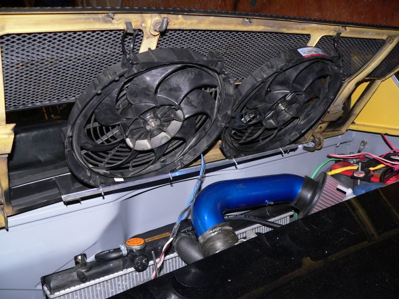

Tonight I picked up the bumpers at Aaron's place. Got a ride in the beast, and WOW. That's a 914!!! The suspension is awesome, the engine sounds great, hauls ass, etc. The array of headlights is truly impressive. Those rally lights are like laser beams.
Got home at 11:30, so no time to try messing with the bumpers or anything else for that matter.

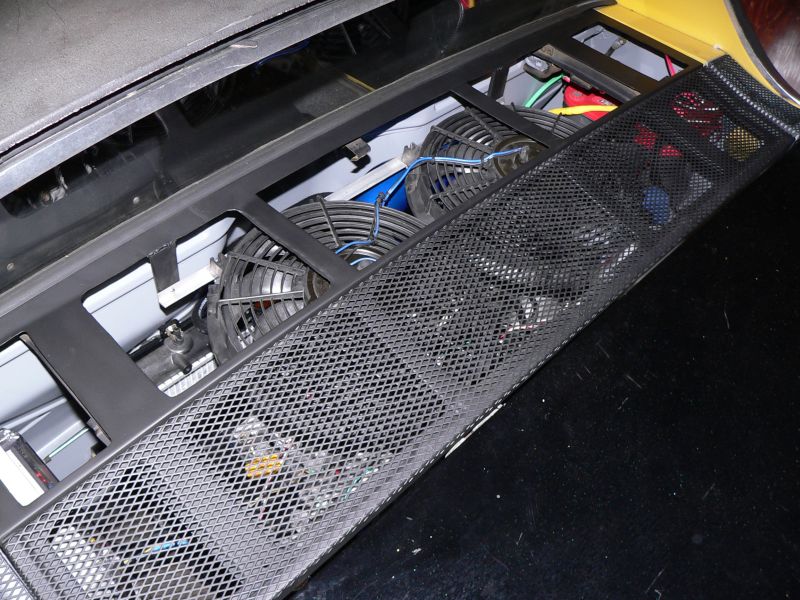

First off, pictures of the modified engine bay lid complete with fans. This lid and fan wiring is far from finished, but it is for the moment functional which is really the most important part as I figure out the cooling system.
For instance I haven't had time to flatten out the second grill section....

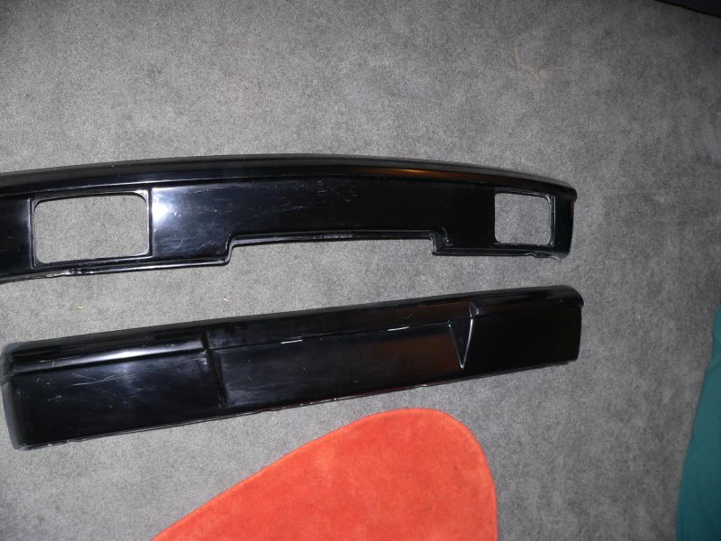

And now the awesome Getty bumpers. These are some fine piees of work. Haven't test fitted them yet, but they are really really well made.

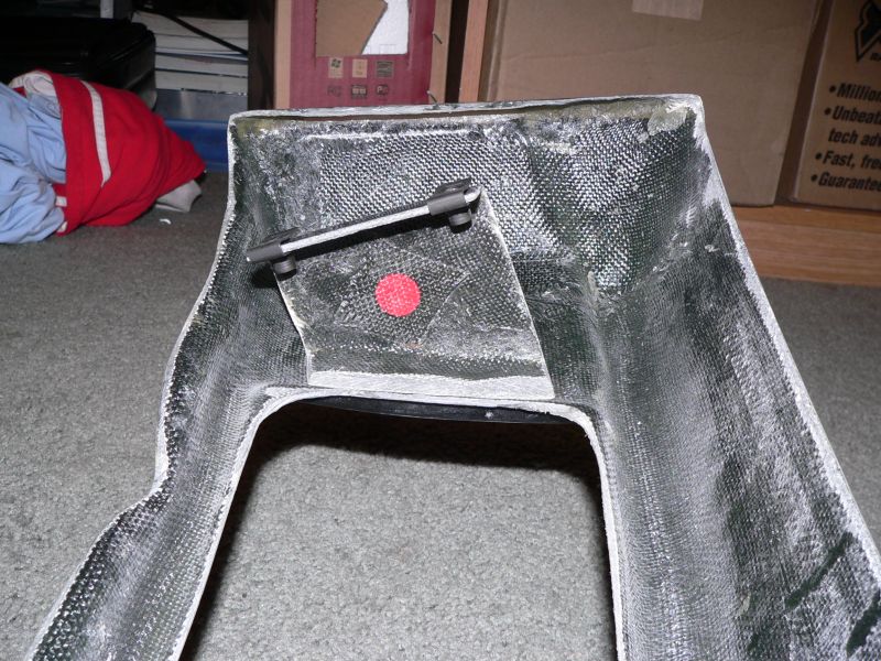

One issue I need to resolve quickly is how to attach the brackets to the bumpers. The bumpers each came with a pair of fiberglass pieces made for attaching to the car, but I'm not certain how to attach these to the bumper with enough stength. Any thoughts?

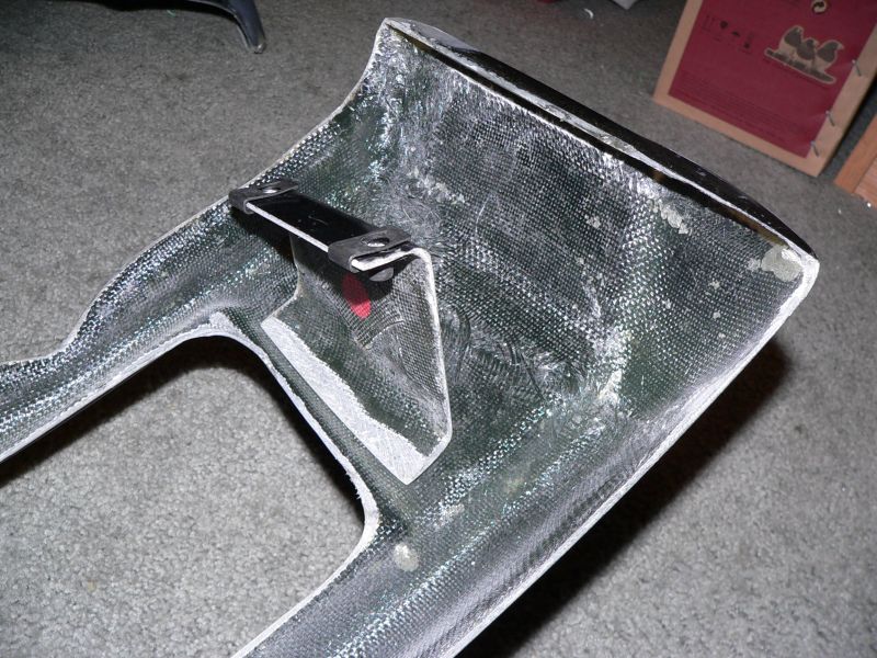

Lastly, more detail of the part that needs attaching to the bumper.

Here's an idea you can consider. Bolt the brackets to the car so that they are properly located. Then put some bondo (small amount) on the front of the brackets where they meet the back of the bumper and position the bumper (hold it in place with heavy tape, etc.) until the bondo sets. Then, take the brackets loose and fiberglass over the bracket/bumper joint to further strengthen it once the bondo dries.
Just a thought.

Post #410

my suggestion was do the same with JBweld and go glass it in later.....

mount the bracket, put bumper in place then drill two holes each side through bumper and bracket, put wood screws in to hold bumper and bracket, then remove bumper and bracket together, then bond the bracket and bumper together off the car, both surface between bracket and bumper and over bracket and bumper, remove screws and fill holes.

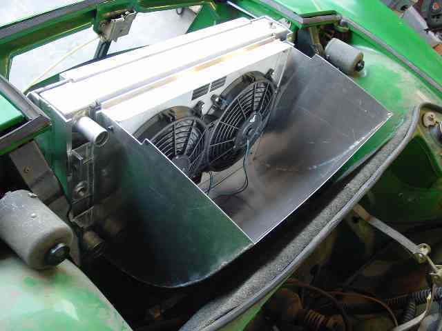

Big thanks to Jeff (Jkeyzer) and Royce (Bondo) who drove down today to help me finish up the car. We finished mounting the bumpers and Jeff fabricated and installed a flap in front of the radiator to attempt to create a low pressure zone at the radiator exhaust.
I gave them both noisy rides around the neighborhood and the cooling system worked fine. Jeff noted that the best part of the exhaust on this car is that at idle it purrs like any normal car, but then when you step on it, its like a racecar. Both commented that they could hear it blocks away.

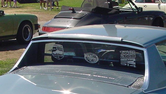

For cooling, it is time to start going through the list of techniques previously posted. First up is a small lip behind the targa bar.
According to T H O M A S, (who spoke with the owner of this car), the addition of this tiny spoiler cooled his 6 cyl Porsche engine by 30 degrees!
(photo taken at 2001 German Autofest)

The finish of the bumpers was quite good. I haven't ever bought fiberglass parts before so I don't really have anything to compare with. The gelcoat finish was really nice, almost ready to get paint.
The rear bumper required justa tiny bit of trimming to get it on. I used a copign saw, a file and some sand paper to fix it.
Royce (Bondo) shimmed the rear brackets slightly to fit, but otherwise it went together fine.
I'm very pleased with the bumpers, I think they are really a good value.

To install the bumpers, we bolted the brackets to the car, sanded both mating surfaces, and used some 2-ton epoxy to hold the bumpers in place temporarily. We then taped the bumpers to the car in the correct posisiton and let the epoxy cure. After a few hours we took the bumpers off the car, and layed some pieces of fiberglass over the joints, slathered with epoxy resin. Royce noted that epoxy resin is prefered over polyester based resins, beacuse it doesn't shrink as much. Its harder to find, but one of the benefits of living in LA is that a fwe miles down the road is Plastic Depot, conveniently open on Saturday mornings. They even had carbon fiber in stock. mmmm. carbon fiber.
Anyway, after the reinforcements cured, I bolted them back up to the car. The exhaust holes haven't yet been cut. Along with the cooling and electronics tweaking, thats one of the last major things to finish.
