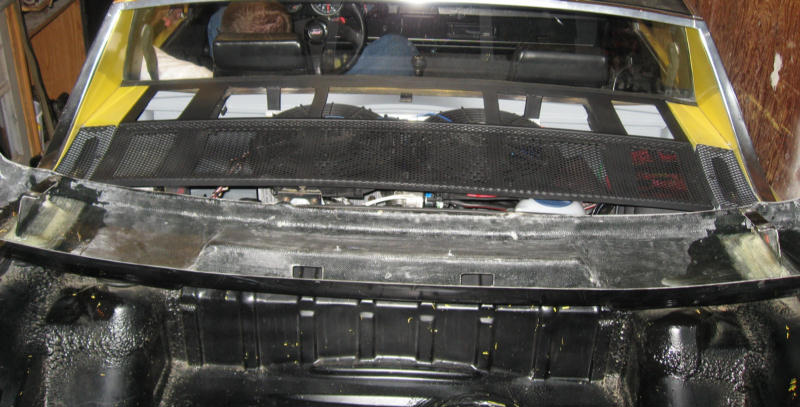

Ok, here are some pictures!

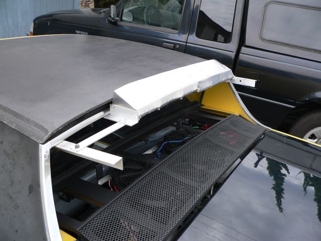

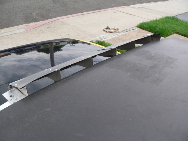

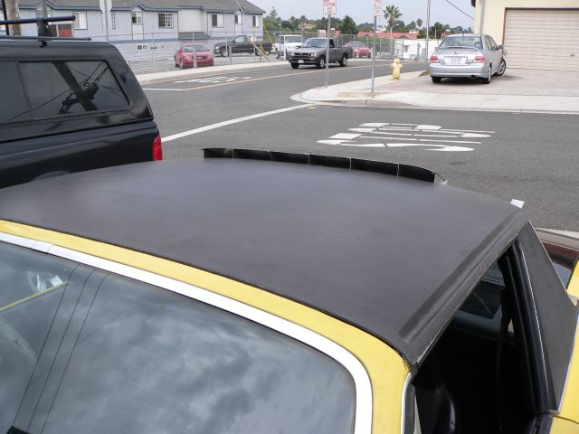

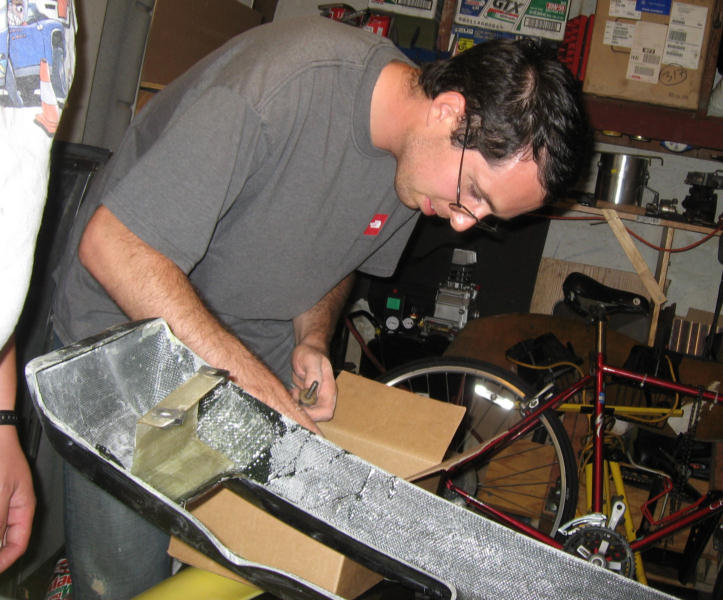

I got back Thursday from Italy (gone almost two weeks) and brought with me a bad cold. Today I finally felt good enough to get some work done on the car, so I built a really cheesy spoiler to divert air from above the car to the engine bay.
TonyAKAVW
post Oct 1 2006, 04:04 PM
Post #437
That's my ride.
Posts: 2,151
Joined: 17-January 03
From: Redondo Beach, CA
Member No.: 166
Testing with compressed air shows that it does effectively divert air in the correct direction. So I have some confidence that at high speeds (say above 40 mph) there is now positive pressure above the engine bay.
I took the car out for a test drive and the cooling is still not sufficient. At freeway speeds the temperature still continues to rise, very slowly, but it still rises.
My impression right now is that I am not getting a real pressure differential across the radiator other than that created by the fans, which is not enough to cool the engine. Without some kind of ducting to the radiator I will not get positive pressure on the input side. My initial design was based on creating low pressure on the output side by means of a leading edge flap (as in the rubber 914 flaps) and a diffuser/venturi. I have still not constructed these, so its possible that those two items combined with the spoiler will be enough.
However there are two other problems I have noticed.
1. The cabin of the car gets really warm. The radiator output is blowing against the firewall ad heating it up a lot. Its like a giant heater behind your back.
2. The brake lines and proportioning valve are getting heated up. This could be solved by rerouting the brake lines, but would be a bit of a pain.
So issue #1 could possibly be solved by insulation but then I'd be adding weight...
I'm beginning to think that trying to push the air from the top to the bottom just isn't going to work. There isn't enough room to put ducting on the radiator unless I move the fans to the opposite side of the radiator. If I do this I still only have a small area for ducting (maybe 2 inches of clearance before I hit the alternator or crank pulley). Then I need to get air into the ducting which could mean a huge ugly enclosed area behind the rear windshield.
So my main concern with the scoop under the car is speed bumps, but I have come up with a possbile solution...
-tony

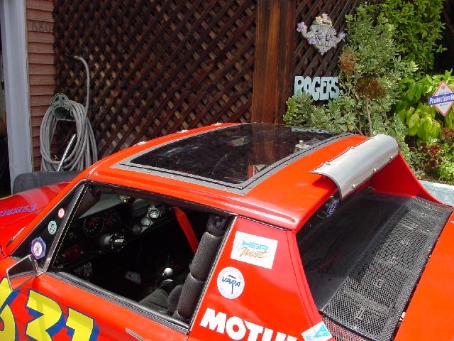

I found a diverter online similar to your proto.

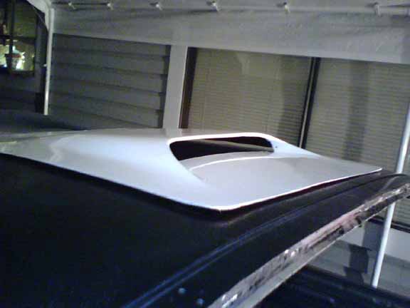

I bought a roof scoop but probably won't use it. I'd have to cut into the targa band, figure a way to duct the air into the engine compartment and make it all weatherproof. I was brainstorming with a friend the other day and a retractible snorkel sounded interesting... (IMG:style_emoticons/default/idea.gif) (IMG:style_emoticons/default/biggrin.gif)
