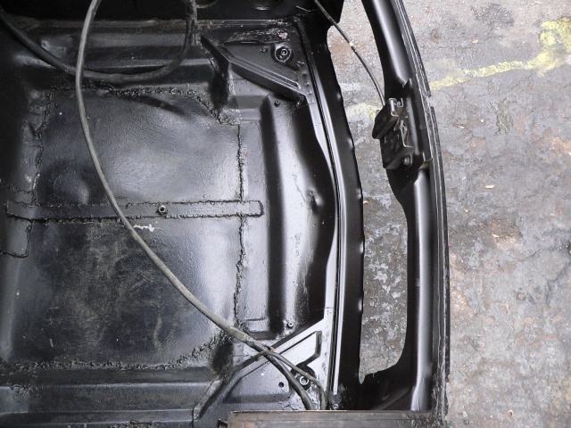

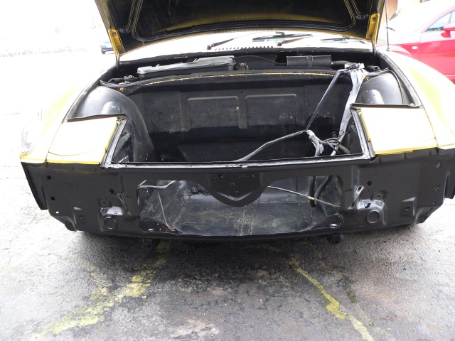

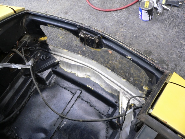

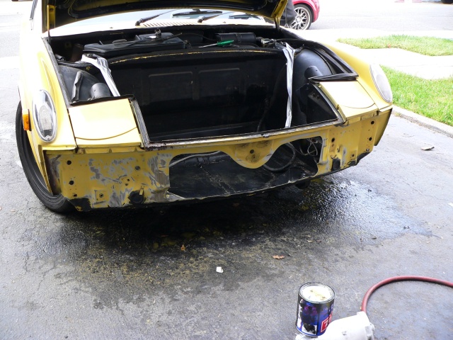

Yesterday I took the first step in placing the radiator up front. Namely, cutting out a hole for the cold air inlet. I painted the front and inside lip of the trunk with Zero Rust partially to clean things up and partially for rust prevention.
-Tony

That's a huge inlet hole! How will the air exit?

I didn't get time to cut the outlet holes, but they will be on the wheel wells as is commonly done. That inlet hole is about the normal size for front radiator isntallations. I probably could have gone with less, but now I have less sheet metal weight (IMG:style_emoticons/default/smile.gif)
Now I'm trying to figure out if I want to make an aluminum shroud or a fiberglass shroud.
-Tony

Add a brace from the latch to the floor.... .5x.125 angle works just fine. Just something to supprot the latch.

BJ: Thanks for the tip about the latch support. I was wondering about that...
-Tony
