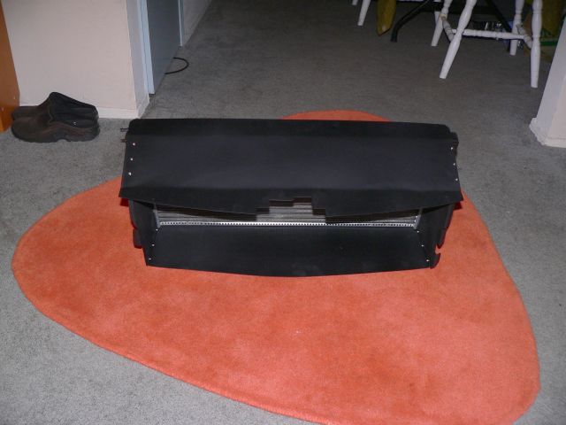

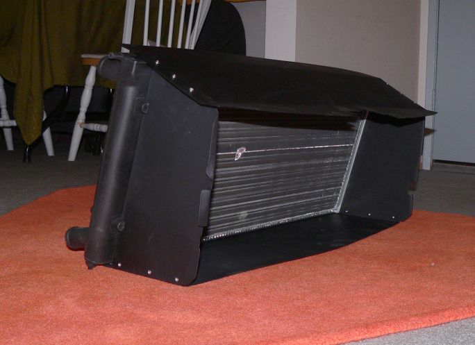

So last weekend I got the front opening for the radiator cut. This Friday I cut the exhaust holes, and today/yesterday I built the radiator shroud. I ended up going with sheet aluminum. Turned out very light weight and fits nicely. It will be riveted into the car and I'll use some silicone to seal the few gaps.
Powder coated flat black.

Aaron Cox
post May 9 2007, 12:28 PM
Post #525
Professional Tinkerer
Posts: 24,548
Joined: 1-February 03
From: Corona, CA
Member No.: 219
we need installed pics!
TonyAKAVW
post May 9 2007, 12:34 PM
Post #526
That's my ride.
Posts: 2,151
Joined: 17-January 03
From: Redondo Beach, CA
Member No.: 166
Maybe by this weekend. I've got to rivet on some angle-stock to the sides so the radiator can be held in place. Right now its just sitting there. Also have to mount the fans and run fan wires to the front.
My plan is to have this new cooling system completely ready to plug in. basically unplug the fan connector to the current system and the two hoses and conenct to the new system.
-Tony

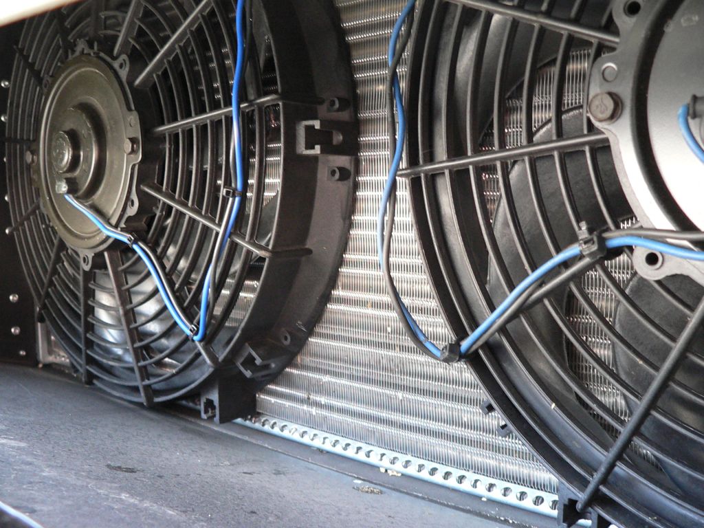

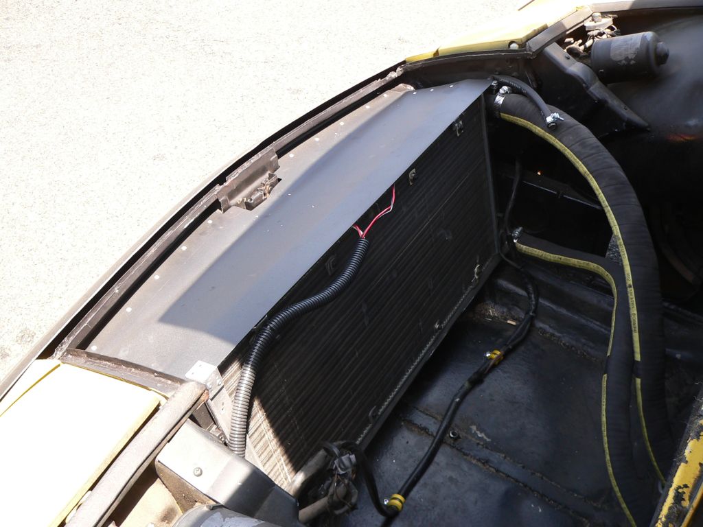

TonyAKAVW
post Jun 10 2007, 04:49 PM
Post #536
That's my ride.
Posts: 2,151
Member No.: 166

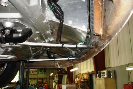

Installed radiator.

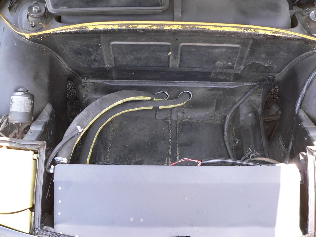

TonyAKAVW
post Jun 10 2007, 04:59 PM
Post #538
That's my ride.
Posts: 2,151
Member No.: 166

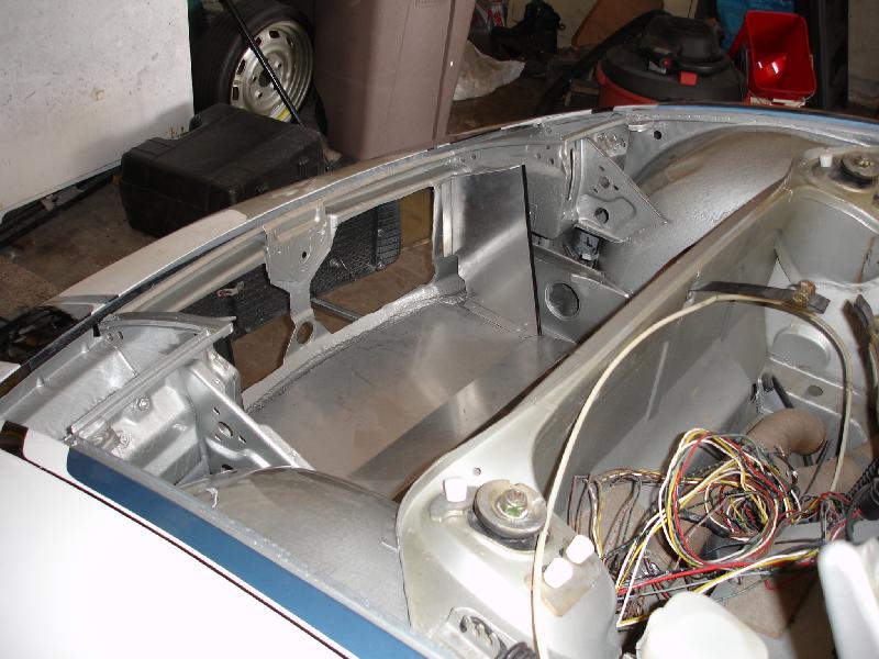

Next step is to fix up the front trunk area for some storage space. I want to at least be able to fit a good size set of tools in there and there seems to be plenty of room.
-Tony
-Tony
As usual, nice work Tony.
I wish I had more front trunk space. I wonder if a couple of sets of 90 degree elbows would be feasible to route the radiator lines over to the right and directly up to the radiator?
Hmmmm.....Probably would work.
Ed aka W9R1

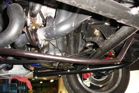

eric914
post Jun 10 2007, 07:19 PM
Post #540
Posts: 384
Joined: 28-January 04
From: Waynesville OH
Member No.: 1,613

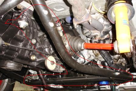

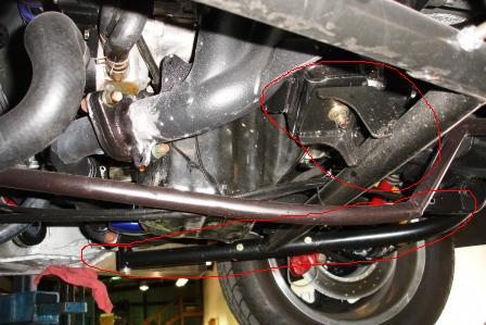

Whose motor mounts are these?
