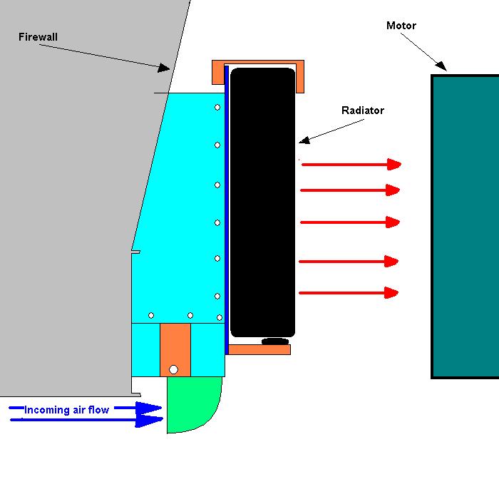

This thread is not dead... I have been working a lot on the wiring harness as well as ordering parts for the engine, and doing some conceptual drawings for the radiator bracket/shroud.
This design is very similar to Scott's radiator shroud/mount but is made entirely from aluminum and bolts on to the car rather than being a weld-in part. It is way more complex and has a lot more parts, and in the end will take about 30 times as long to build. Scott's method is simple and works great, mine is way over engineered, meaning it probably won't work (IMG:http://www.914world.com/bbs2/html/emoticons/cool.gif)
Here's the first drawing giving an idea of what the thing looks like.

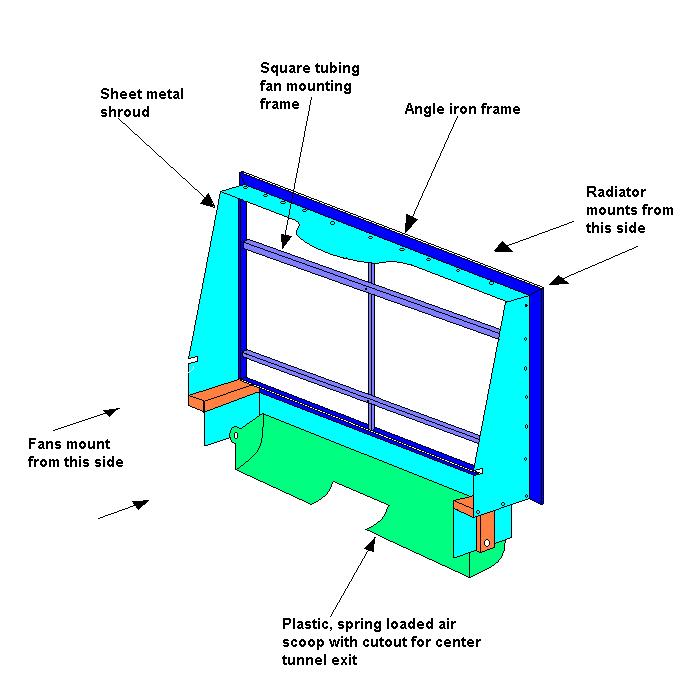

Another drawing to show conceptually how it fits into the engine bay.

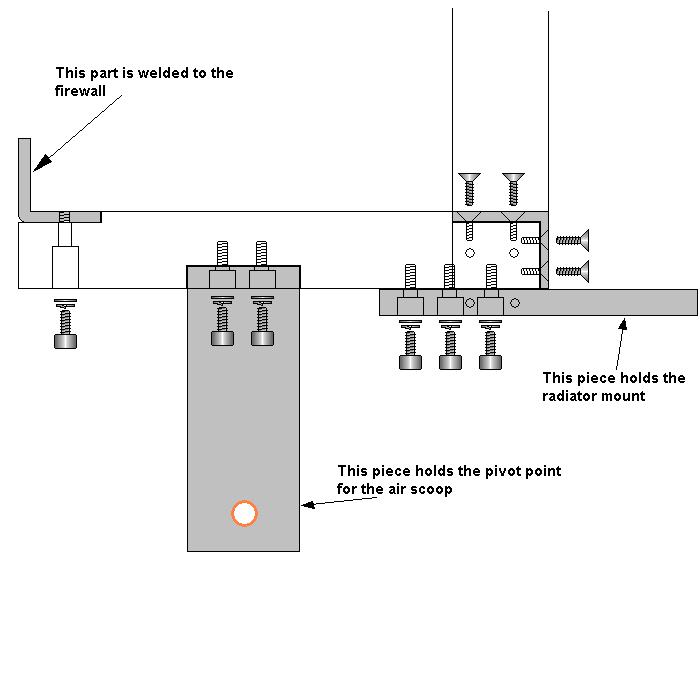

Here's some detail of the orange colored bars at the bottom of the shroud. These will be machined form a rectangular bar of aluminum.

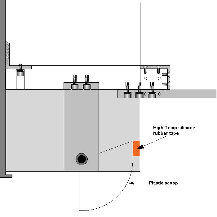

Here's the drawing from above with the addition of the plastic air scoop

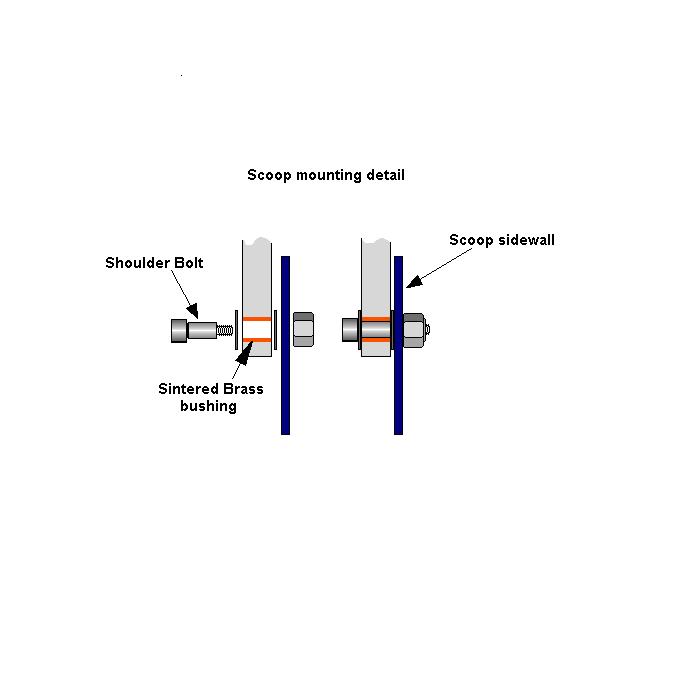

Some hardware detail of how the scoop is mounted...

spring loaded so that if you hit something it rotates up to help minimize damage??

I have a few more drawings on paper that I did by hand, especially for the mounting of the top of the frame. Basically on each side, on the inside corner of the frame will sit a block of aluminum that will both hold the frame together and have an angled hole through which a bolt will pass, coming through the firewall. There's a standoff that will sit between the firewall and the block.
Another detail. The aluminum sheet metal shrouding will have a rubber gasket around its edge where it meets the firewall. This will be made from either a sliced piece of tubing or some standard material for the purpose.
The only welding for this is two small angle brackets on the vertical section of the firewall. These secure the bottom of the frame to the firewall, and welding is necessary because that section of the firewall is not accesible from inside since its double-walled. If you wanted to hack up the inner lower firewall you could get away without welding. It would probably just be a couple small holes.
One detail I have not yet worked out is the clamp that holds the top of the radiator. Probably won't be too tricky, but I need to wait until I have an actual radiator before doing that.
Exactly. It will be such that it can rotate up all the way so that it is flush to the floorpan. I was thinking that a spring _might_ not be necessary if the scooop is heavy enough to stay put at high speed, AND that the bearing point be smooth enough.

QUOTE (TonyAKAVW @ Jun 22 2005, 10:33 AM)
-Tony
Heavy means inertia which means it won't move easily when struck. I imagine it would slam pretty hard when it reaches the end of its travel also. I thought maybe using something flimsy and with flimsy mounting points so it would tear off if hit hard without damaging anything else.

tony that is basicly what i had designed, but here are 2 things for you to consider. one get rid of the fan mount and use the plastic thru core supports, you want the fans as close as you can get them to the radiator ie touching it. also the top of the radiator frame will be touching the firewall so your shrouding will be smaller.
if you want a complete fan set up that should fit perfectly but is not cheap go with this one. from what i saw before it is almost a perfect fit on the suby radiator and it offers very good coverage so you get good flow.

I didn't know that there were fans that mounted to the radiator itself. That definitely seems like the way to go.
As far as the radiator touching the firewall, I have to see how all this fits in the engine bay. I'm sure there will be some adjusting of the design once I have things roughly in place. This is just a first cut at it, nothing is measured. I may end up pushing the mount back towards the engine slightly to get the clearance if I need it, but I'll see when the time comes.
Andrew: I agree. But I also want this thing to be sturdy enough that when I go over speed bumps it doesn't tear it off. I'd like to be able to go over speed bumps (slowly) and have the thing stay intact, move out of the way, and then move back when the bump is over. After time this will wear down the leading edge of the scoop, but maybe I can put a strip of some really hard metal on there, like tungsten or something!!! or not.

Put rollers in the lip of the scoop to help preserve it as it is being deflected up. Why not? (IMG:http://www.914world.com/bbs2/html/emoticons/confused24.gif)
You could also pad the end stops of the scoops travel so it doesnt destroy anhting when you run over the piece of tire in the middle of the road.
