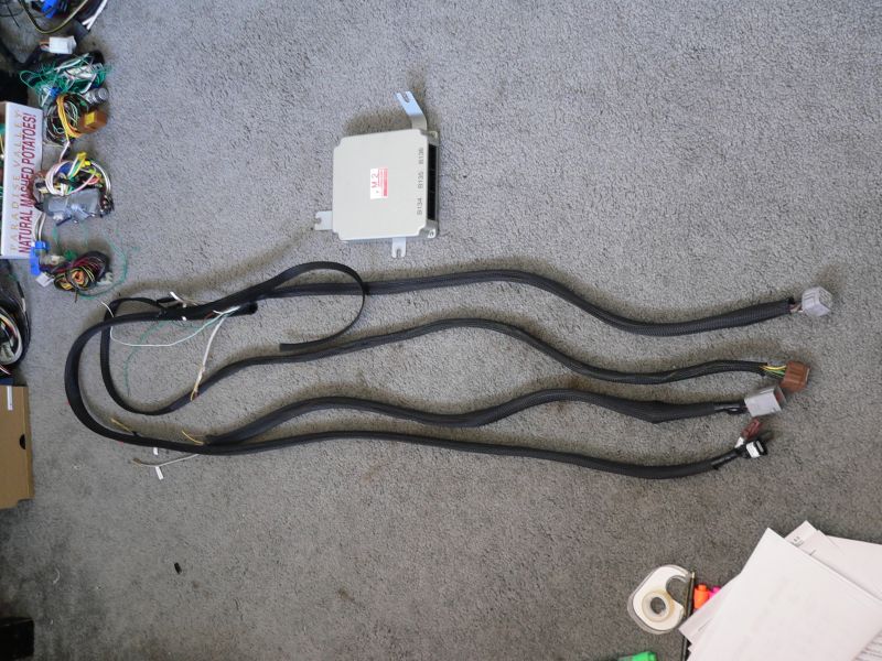

I met a major milestone in the wiring department this weekend. I stripped down the Subaru harness to minimum and labeled and identified every wire going into the ECU. The result is amazing. The original Subaru harness is now down to probably 5% of what it started out as!
-Tony

that looks like you are mising a few plugs, but i cant see it all very well. dont tape it up too much you will probably have to open it up once to fix something.
all the plugs i can think of are :
brain
2 o2 plugs
3 for engine connection
fuel pump relay
main realy
ignitor
obd connector
purge and pressure switching solinoids ( 2 plugs )
connection to relay board
then loose wires are :
power
ground
speed sensor
temp sensor if you go stock
then you need wires from the alt
Dr Evil
post Jun 26 2005, 12:44 PM

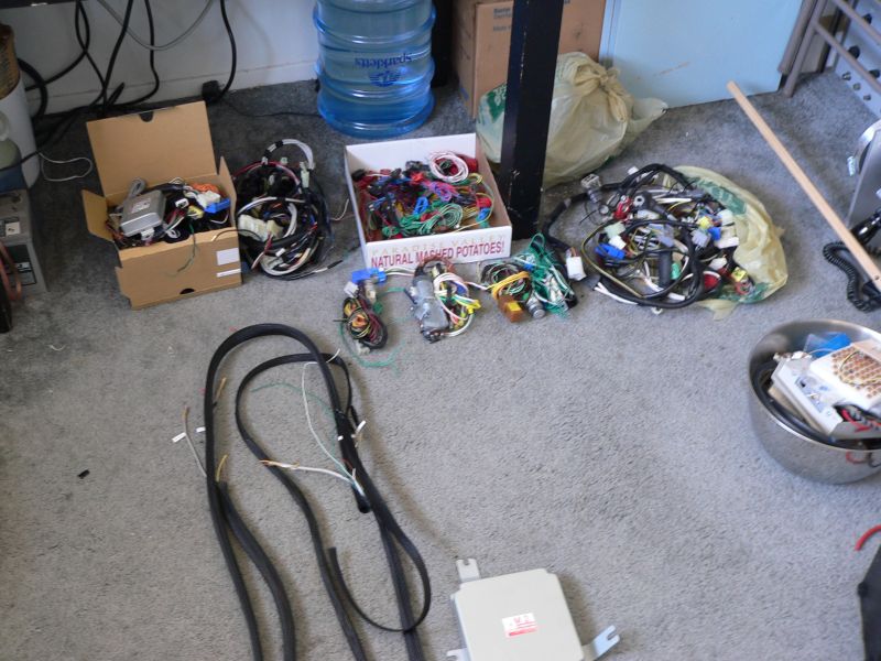

Yes a few things are missing form the picture... The engine harness itself is still on the engine and I believe (though I will have to double check) that the O2 sensors come off of that. The relay connections will be made inside "the box." The OBD connector as well. The ignitor is through the engine harness, as well as the purge valve. I think everything else is acoounted for....
-Tony
Heres the leftovers...
Edit: the black stuff around the wiring is just nylon expando sleeving. Its just there temporarily to keep the wires from going all over the place. I'm nto sure if I will eevn use it in the end, but it just slides off.

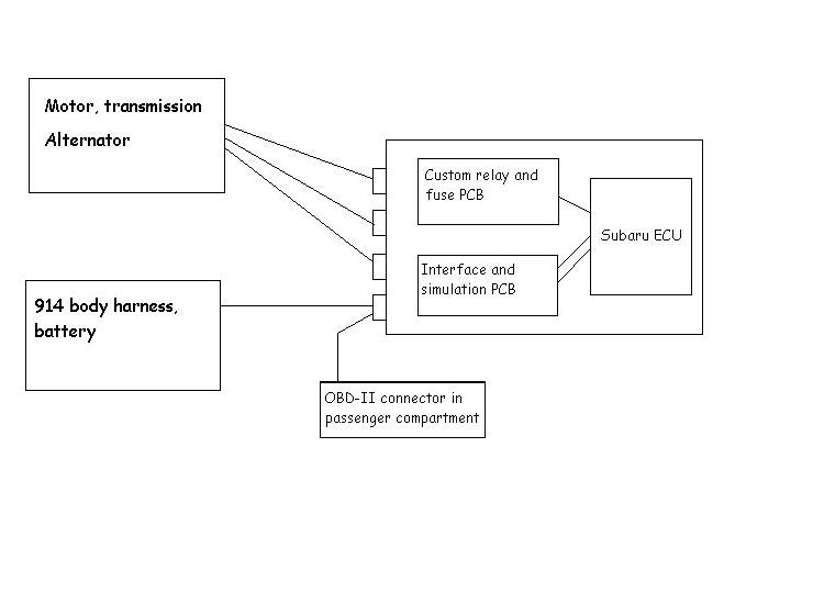

And now for the description of "the box." The "box" is going to be a weatherproof aluminum box that will tentatively go in the engine bay, though it could easily go in the passenger compartment if I find it gets too hot.
Anyway, the box will be the main wiring hub for the car. In essence it will replace the relay board and the 914 ECU. It will contain the Subaru ECU, and one or possibly two custom printed circuit boards (PCBs). One will act as an in-between to the engine harness and the ECU and wil contain mostly resistors and other components which simulate the function of elements I'm not using. These include the rear O2 sensor, fuel tank pressure, fuel temp, etc. etc. It will be fairly generic in that it will allow any wiring harness to be used. I will end up making 3 or so of these boards initially. If there is interest from others I can put in orders for more of them later on. The second board will hold the relays, and fuses for the rear part of the car. It too will be somewhat generic. In fact I may end up just buying one of these since there are places that make them already...
"The Box" will also have some status indicators on it for quick troubleshooting. I may also have a second OBD-II connector on the box for easier access while working in the engine bay.
