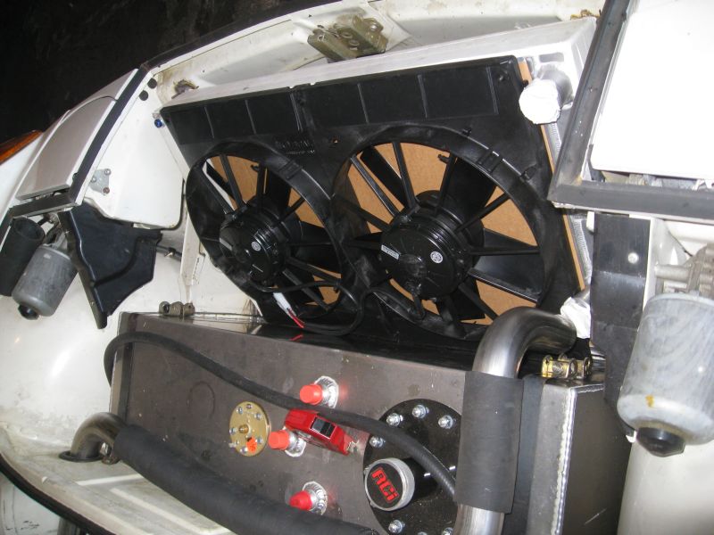

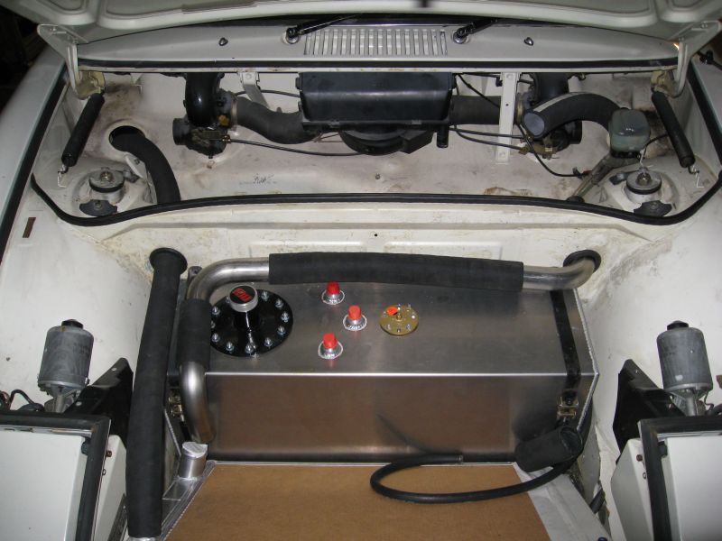

I would really like to be able to post pictures of my radiator plumbing. Unfortunately I have been dealing with rustoration work the past month. Here is the best picture I have of the routing so far. Once past the fuel tank area, the cooling lines will follow the heater ducting into the engine compartment. I really wanted to run them through the center tunnel but was strongly advised not do it by a few people who tired.
I found a cooling fan that fits my radiator perfectly! Bought it here Spal Dual 11

Are you venting the radiator through the hood?

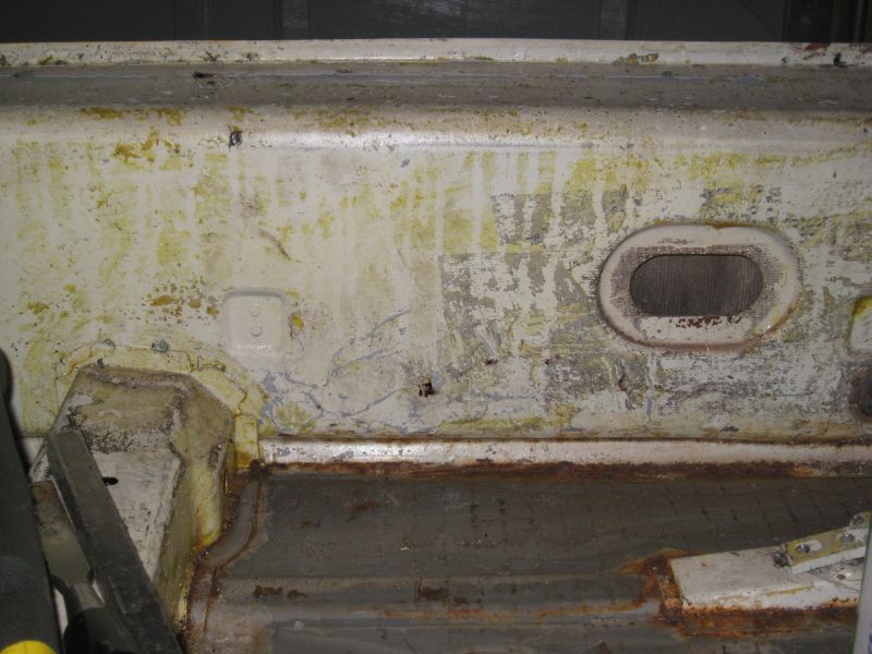

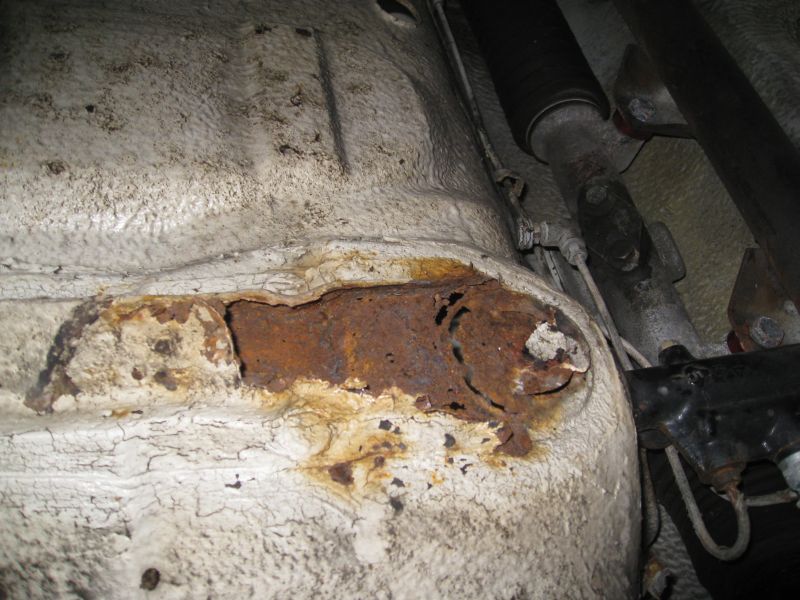

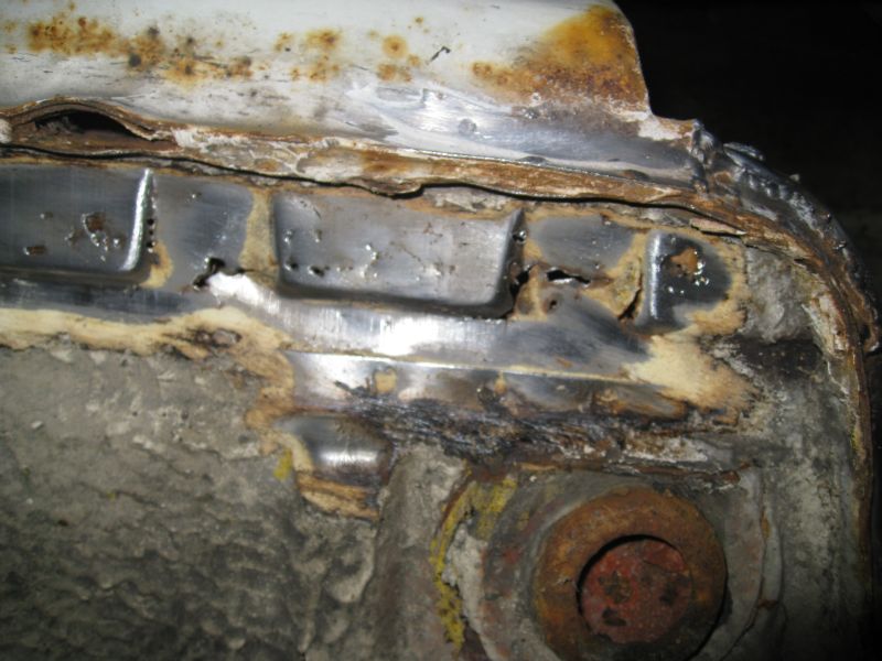

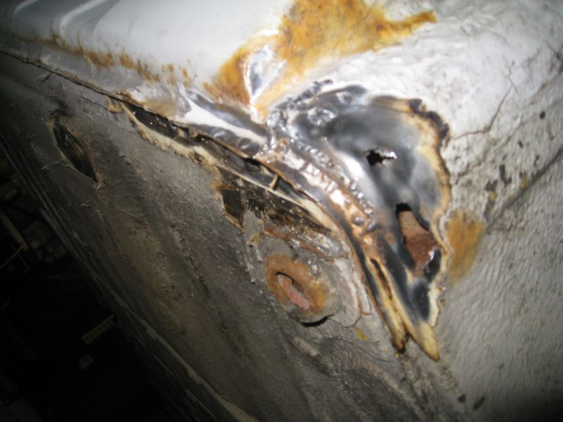

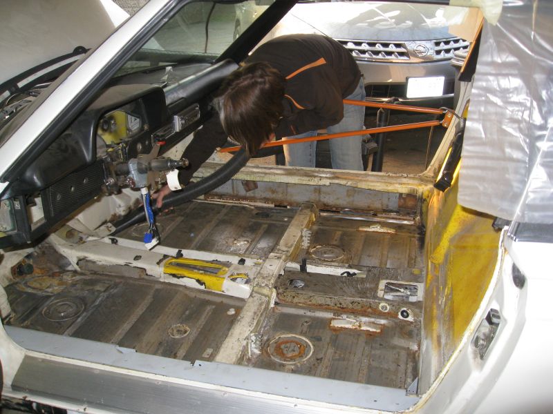

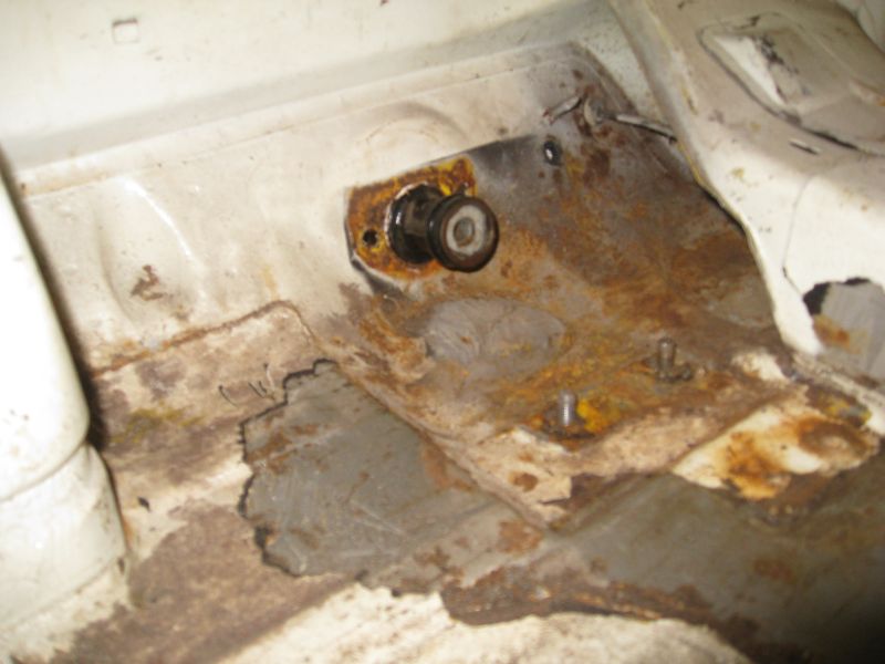

Now on to the rustoration. I think that the past two owners thought that primer, seam sealer, bondo and maybe even JB Weld were great rust encapsulation techniques. I found a few more "soft" spots wile repairing to install the Engman reinforcement kit.
Hmmm, that does not look quite right...
Nope, not right at all...
Get out the angle grinder again.
I know the hole on the right is really crooked. I made it soon after I realized the the lower half of the inner long is going to need to be completely replaced. The hole on the left is so that I can joint the SS bend to the tube.
Amenson
post Apr 21 2008, 06:22 PM
Post #127
That's opposite lock!!
Posts: 645
Joined: 27-May 05
From: Dublin, OH
Member No.: 4,154

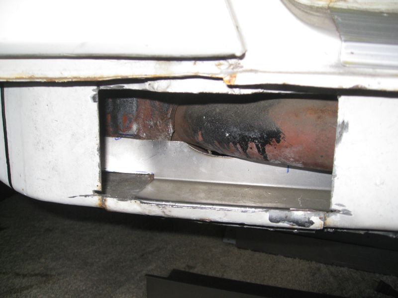

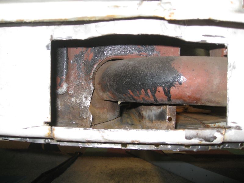

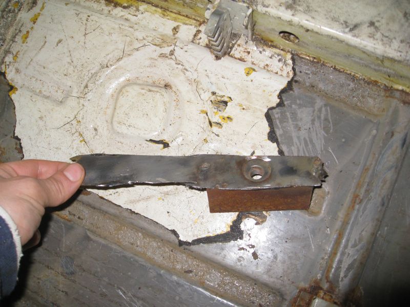

....What in the hell is this? (IMG:style_emoticons/default/ar15.gif)
In case it is so bazaar that you do not recognize it, that is the PO's exquisite use of angle iron to replace the seat belt nut plate.
Hmmm, that does not look good either.
Not much more I can say that will not get censored by the admins.

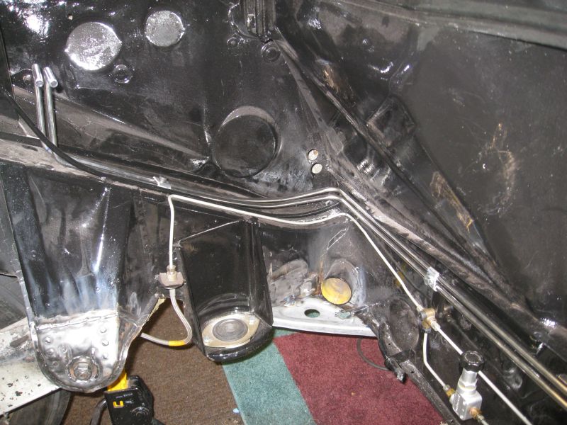

..."I would really like to be able to post pictures of my radiator plumbing. Unfortunately I have been dealing with rustoration work the past month. Here is the best picture I have of the routing so far. Once past the fuel tank area, the cooling lines will follow the heater ducting into the engine compartment. I really wanted to run them through the center tunnel but was strongly advised not do it by a few people who tired."
I'm interested in seeing you the run the lines thru the longs. I thought that would be a good way to go, but didn't have the patience to figure out how to do it.
I did run them thru the center tunnel. No problem yet. Excess heat is not a problem, now that engine temp is under control. But even inside the longs, you will be accumulating the radiant heat. It is tight in the center tunnel, but no interference with the other stuff. I have not run on a hot day yet.

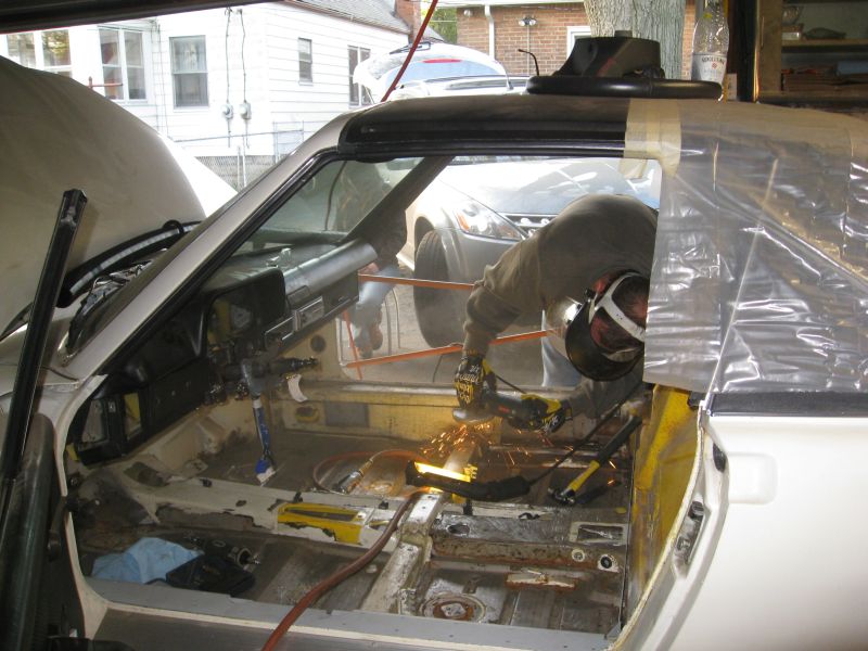

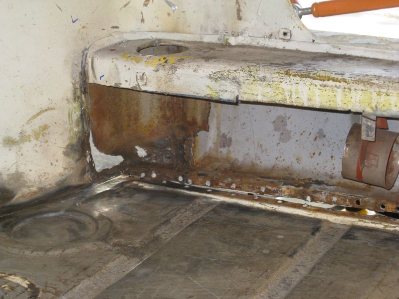

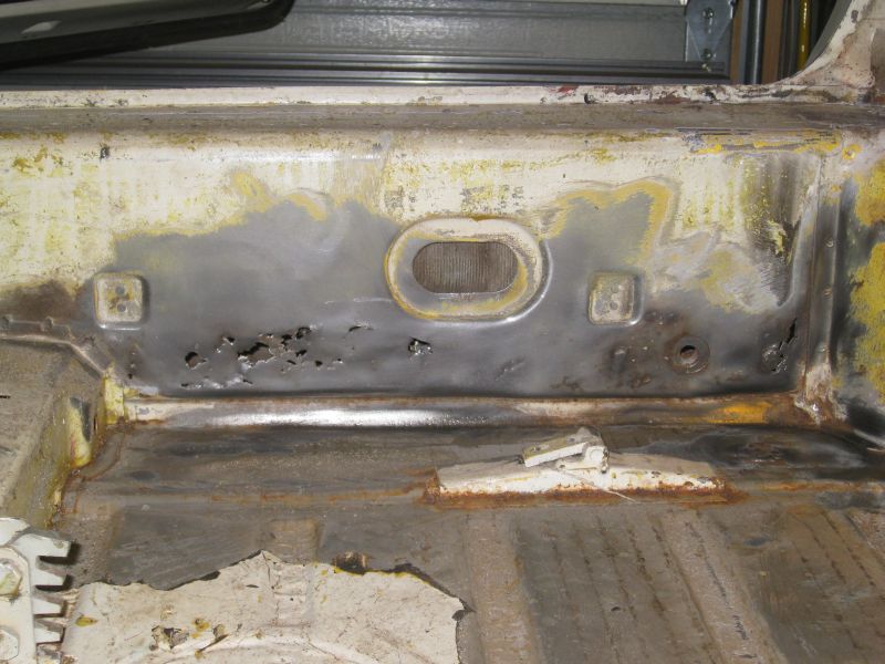

I actually tackled repairing the pedal area.
More work that should be invisible when I am finished.

QUOTE(Travis Neff @ Apr 21 2008, 04:11 PM) *
Yup, inspired by wbergtho's hood.
QUOTE(cobra94563 @ Apr 21 2008, 04:35 PM) *
Will you post or send me some pictures of your installation.
Thanks
Scott

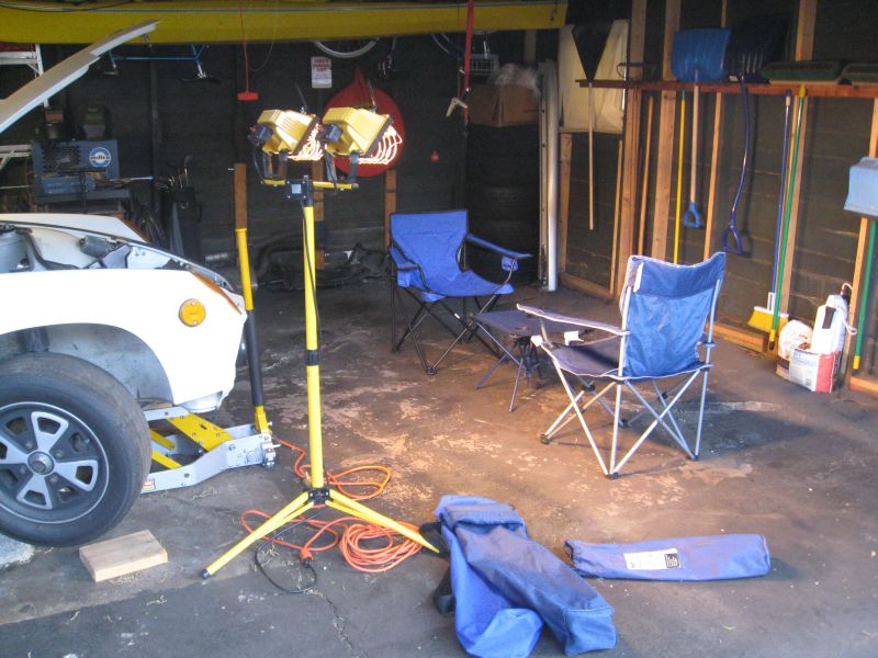

Saturday was the wedding shower and as expected we received a bunch of great gifts for domestic use. We (I;-) also received a couple of gifts for the garage. My future inlaws gave us a really nice cordless tool set with a reciprocating saw, 1/2" drill and cirular saw. I need to pick up some metal cutting blades for the saws and I will be ready for a parts car! My parents gave us a belt sander!
My parents and sister came in for the shower. Most of the weekend was spent entertaining but after we dropped my sister off at the airport on Sunday my parents spent some time helping in the garage. We cut out the lower portion of the inner passenger long. My Father insisted on doing all of the dirty work.

This is my Mother helping:
I still need to finish removing the chunk up in the front. I left it in place for now so that I can use it for measurements and a template.
Thank you to everyone for all of the great gifts and help in the garage!

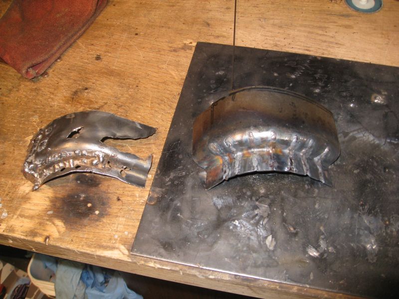

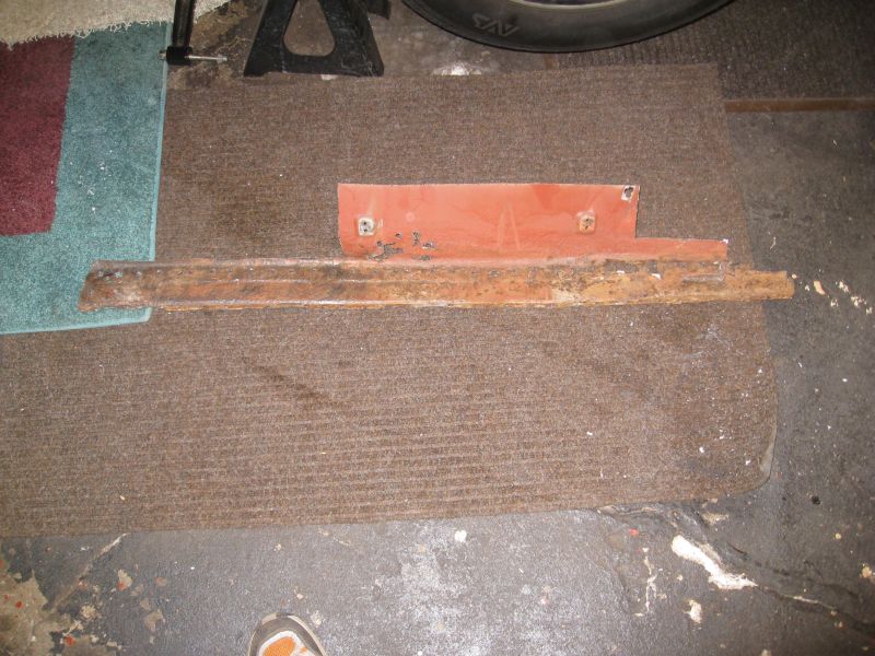

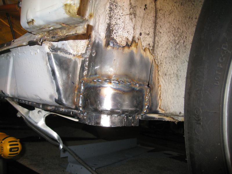

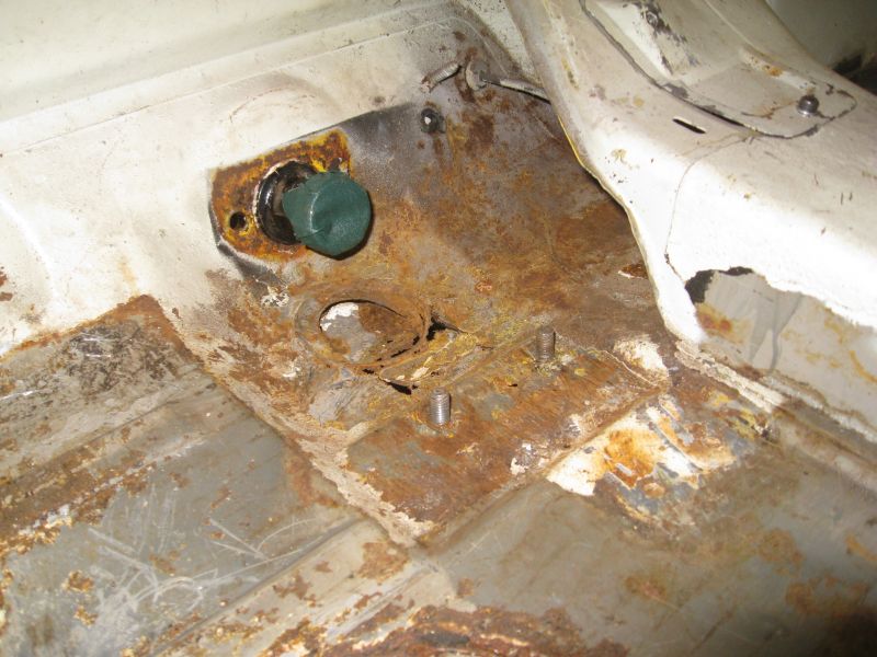

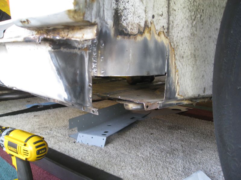

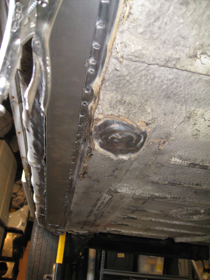

Made some more progress on the restoration work this weekend. Started by tackling this:
Gone!
Working on the new piece. I practiced tig welding by tig'ing all of the shrinking seams. It took much longer than mig welding but I needed the practice and the results are much nicer. It makes me angry ever time I see the previous owner's attempt to fix this area.
In place with much grinding to do.

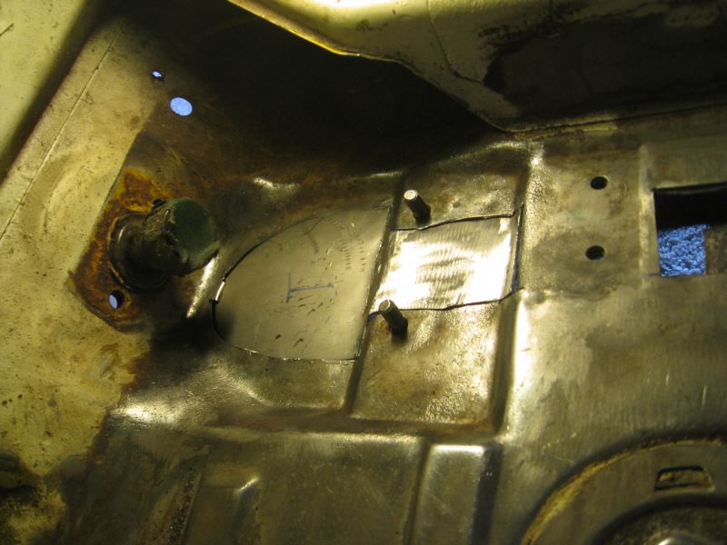

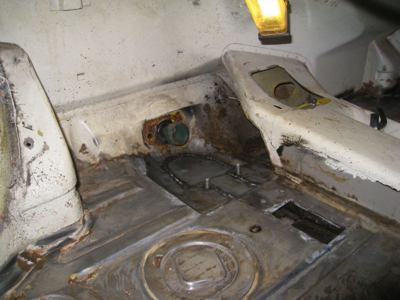

From the inside. Still need to weld the vertical piece in.

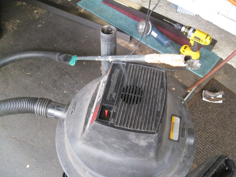

How did I remove the inch of crud that was caked between the firewalls???
Not sure why but I was particularly proud of myself for this simple contraption. Probably because I sat and stared at the crud in the hole for a while before I came up with it.
Hopefully by next weekend I will be done restoring and back to conversion work.

Steel pipe is a good idea. I also use various sizes of rubber tubing to get into nooks and crannies (like the center tunnel).
I used rubber and plastic tubes and compressed air on the other side and in the center tunnel...they worked ok. The wire brush at the tip really loosened up the crud.

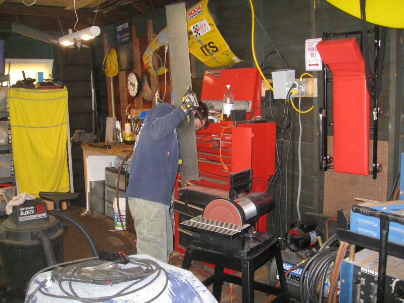

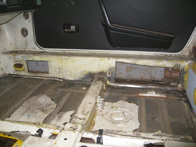

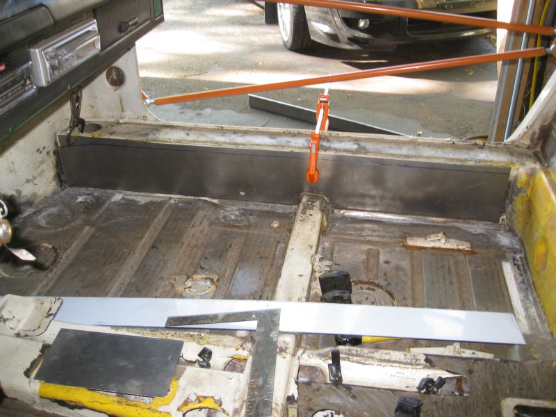

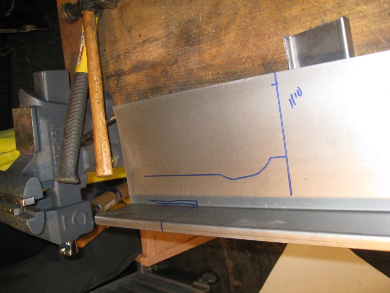

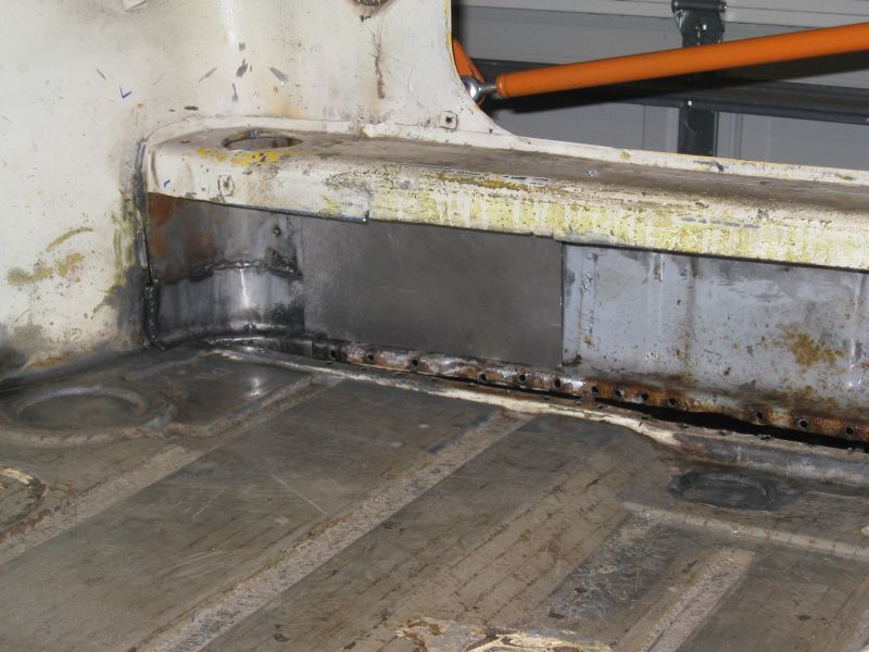

I feel a lot better about the project after today. I mis-specified the size of the blanks for the passenger side inner long replacement panel so the ones my father brought would not work. It looked like I might not get to work on the most critical section of the repair work this weekend. I sent my Father the new dimensions and 2 days later new blanks show up. Thanks Pa!!! Today I made it fit, and did not need the extra one the he sent.
One end of the blank ready for cutting.
Cut and ready to go in:
Some adjustments required:

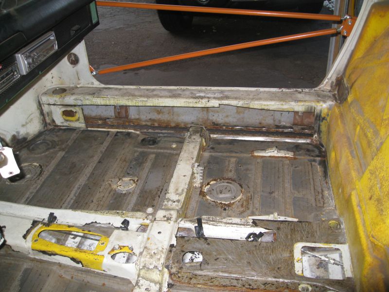

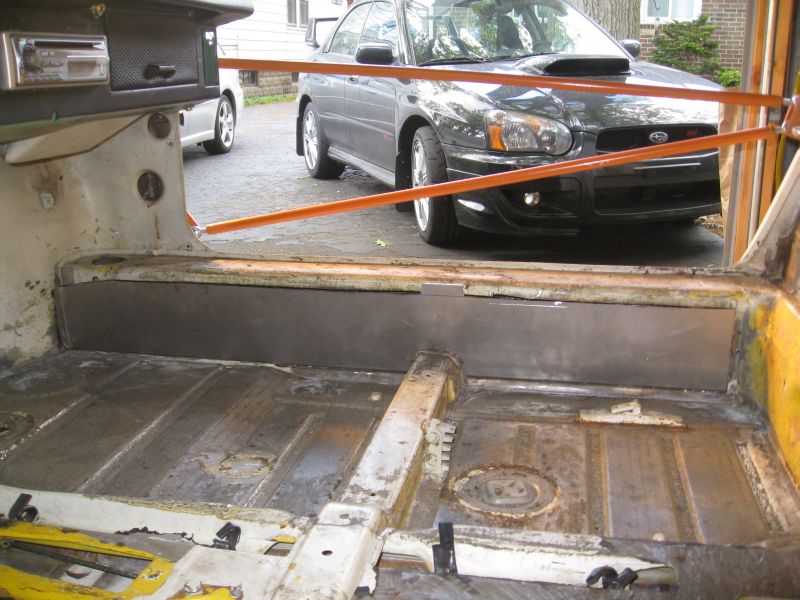

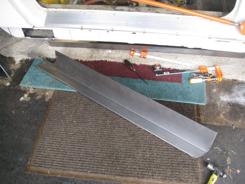

It fits but the top needs to be cut. I decided to cut high enough so that I would cut through the patch panel and the existing inner long metal. Theoretically everything would line up with a saw sized gap between the panels.
It worked!!
Bottom

Inside:
