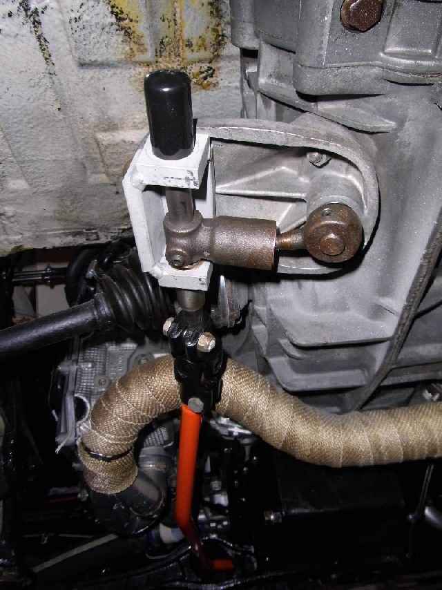

So I ordered the JWest Shift linkage based mostly on the review SirAndy did a while back...if this is as good as it get's then I need one.
I did a search and read through his installation threads and the JWest instructions but have yet to find a picture of what it looks like installed on a stock 4 cyl side shifter. If you have a picture, will you please post one here. I would really like to see the position of the front joint on the crooked rear shaft.
I could probably crawl under the car and take a picture, but i'm using a straight shift rod on the /6 so that might not help you much ...
One thing to note, when you cut and weld the shift rod, make sure both ends are exactly in the same plane!
Meaning, the part that slides into the front coupler needs to be in the same 3D plane as the part that slides into the transmission console.
If you don't get that right, you will get some binding in certain positions ...
I am very happy with my JWest setup. I think as far as shift rods go, this is probably the best shifting you will ever get for a 914.
There are already some really nice pictures in your instillation thread. Very good writeup, thanks for taking the time to make it.
QUOTE(SirAndy @ Jan 17 2011, 09:56 AM) *
This is exactly why I want to see a picture. Taking some very quick measurements of my spare rear bar based on the JWest instructions, the front u-joint would end up almost in the same place as the first bend in the bar. This makes the front splined stub significantly un-parallel to the rear splined stub. I must have messed up the measurements but want to see a picture to prove it.

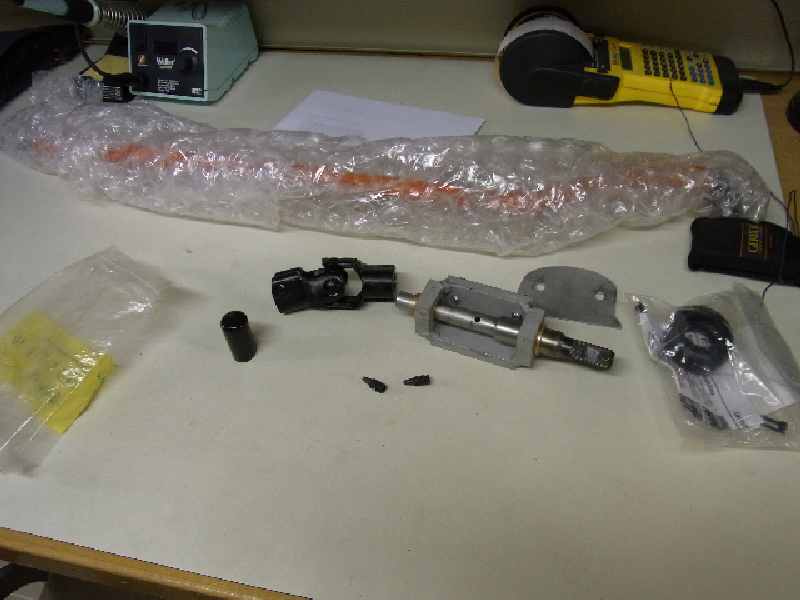

I finally got around to purchasing a new shift linkage. I missed the opportunity to pick up a J-west setup before they discontinued it so I ended up getting the kit from CFR. After fussing a bit to make sure that I got the holes in the shift console in the correct place the kit bolted right in and is nice and precise. The the supplied metal hole location template made the process very straight forward.
Having now eliminated all of the slop between the top of the shifter to the input shaft on the transmission I am still not overly impressed with the shift feeling. I know it is a 30 year old transmission design but with my BMW 2002 transmission, when all of the bushings are replaces with brass, it feels like you have your hand inside the transmission directly moving the shift forks.
I was hoping for a similar feel with my 901, but when when in gear there is quite a bit of movement in the shift lever shaft both in rotation and in/out.
Is something wrong with my transaxle or is that how they all are?
How much movement should I expect to get with "healthy" 901 in gear?

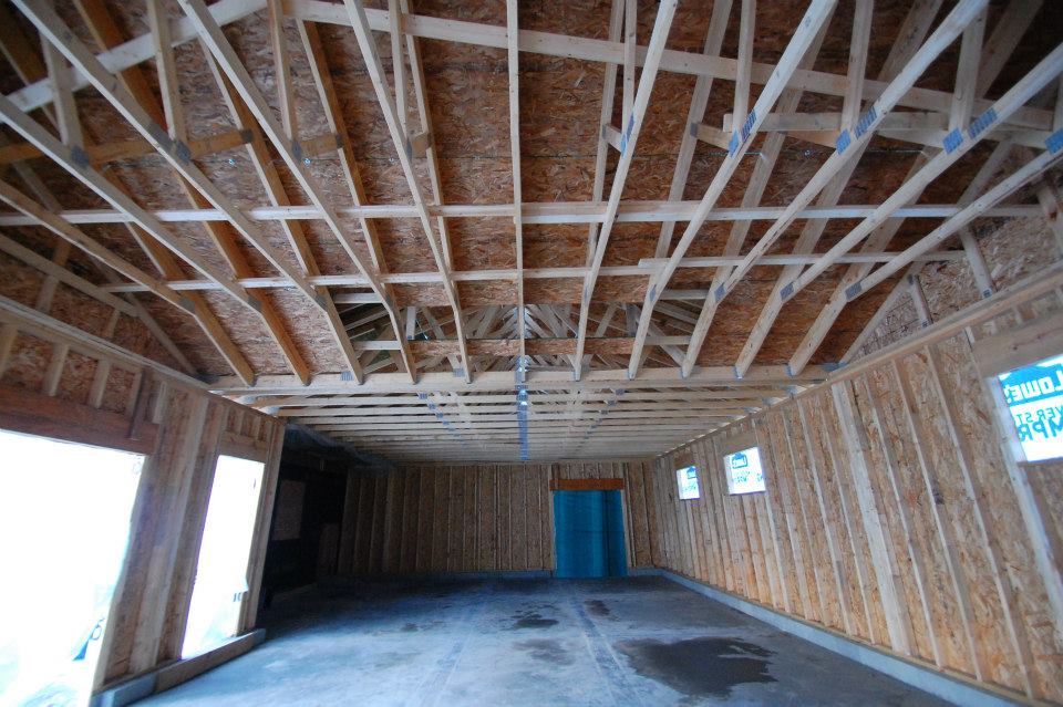

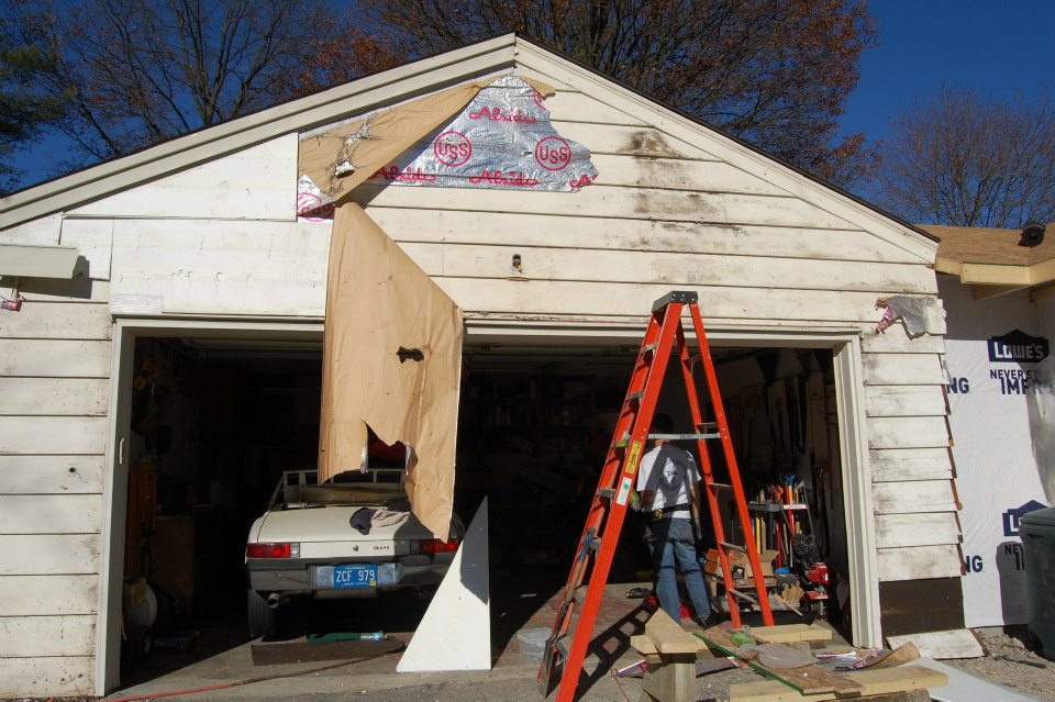

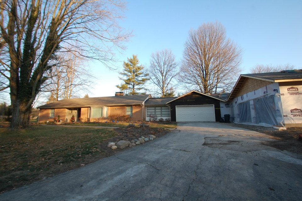

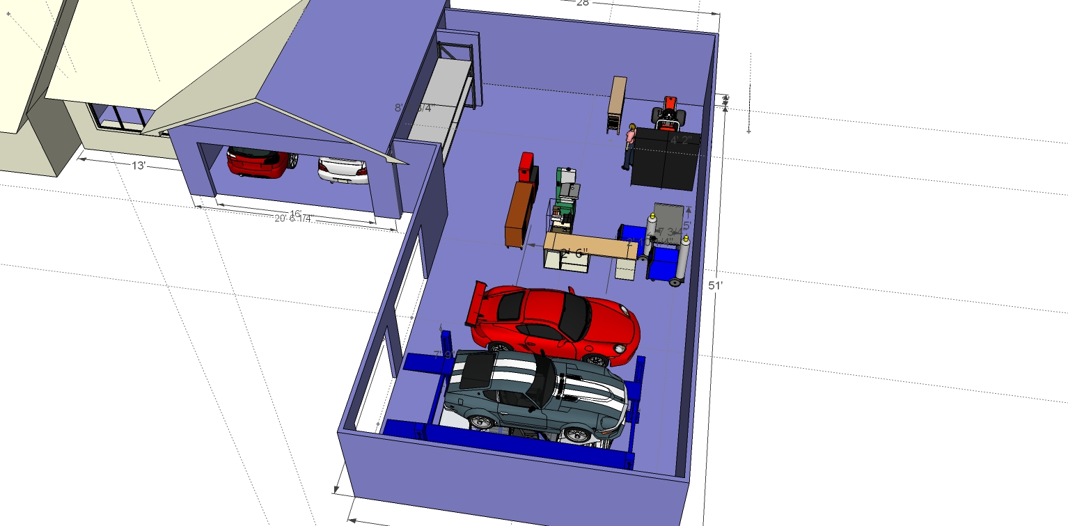

I am finally building my dream garage. Spent the last year designing it and broke ground at the end of October. We (myself, wife, father-in-law and other misc friends/family) are building it ourselves. The only thing that we contracted was the foundation and concrete work.
The new garage shop is 1300 sq.Ft. Daily drivers will live in the two car garage. We are also finishing/expanding the breezeway so that we have an office, laundry room, half bath and mud room.

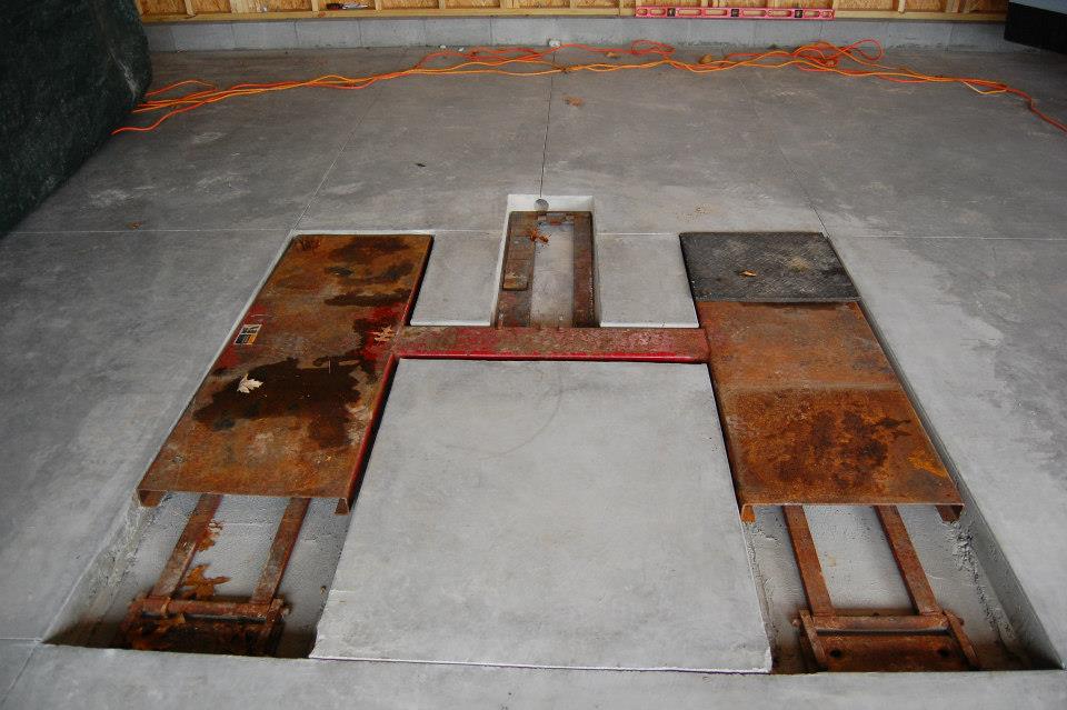

Fish-eye shot of the new space. Ceiling over the parking are is 11.5ft for lift room.
I built in a half lift that I found on Craigslist a few months ago, still need to refinish it.

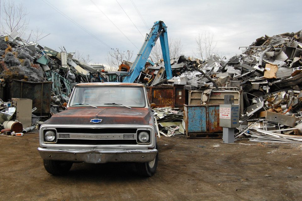

Part of the project was to buy a "work" truck. Picked up a '70 C10 with a modded 350. Total burnout monster...also good for hauling 800 lbs of steel siding to the scrap yard. Already installed power steering/brakes and harvested an 80's C10 front suspension to convert to disk brakes and front anti roll bar. Will be lowering it soon to make it easier to load. (IMG:style_emoticons/default/dry.gif)
It will definitely be a few months until I get back to the Porsti project. I can't even move it into the new shop because the concrete is still curing so I can not apply the stain/sealer.

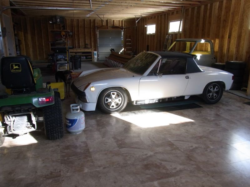

Well, still no progress on getting the PorSti closer to driving but the weather has kept us from working on the exterior of the construction project so we were able to move some stuff to the new garage. The 914 included (IMG:style_emoticons/default/aktion035.gif)
It is really motivating to see it off of the jack stands.
I am not able to install the coating on the garage floor until spring so I can only setup a temporary workspace. Should be just enough to make some progress this winter.

Without a ceiling the main forced air heater mostly just warms the attic area. The induction heater directly over the car helps a bit more but only in a very small area. Better than nothing but far from efficient.

I can't install ceiling fans until I get power installed...which is on hold until the budget has a few months to recover.
