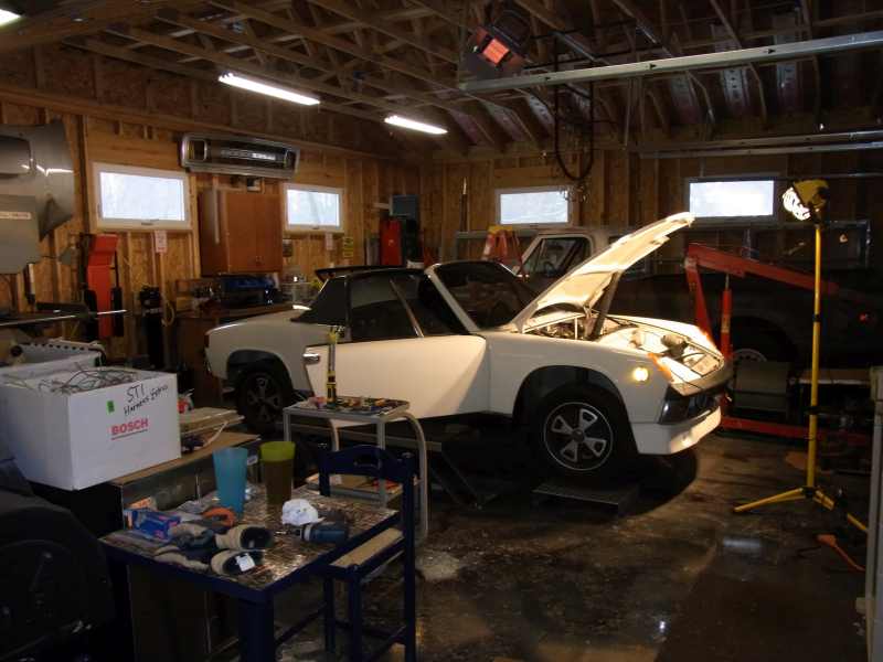

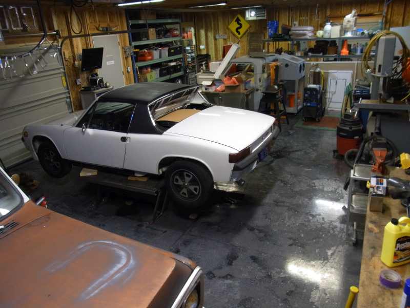

Here we go again….recovering from a long period of project dormancy.
(IMG:http://www.914world.com/bbs2/uploads_offsite/www.digitaldash.org-4154-1392251199.1.jpg)
You might notice that Porsti is proudly perched on top of a fully restored lift, in a nice new shop. The shop while not finished inside, is completely functional. I still need to put up more lights, more outlets, run the compressed air system and insulate and cover the walls/ceiling. That can wait…it is time to get the Porsti running.

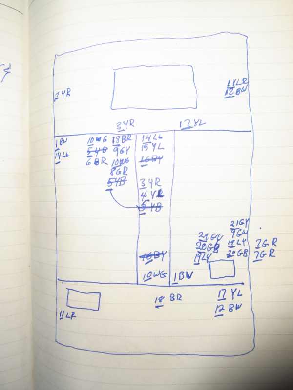

Throughout the week I studied the wiring schematic and got reacquainted with the component locations in the car. Spend a good part of Saturday under the front hood sorting out the power distribution from the main fuse box/battery. I also rework twin two speed fan control do work with the twin singe speed fans in the car now.
(IMG:http://www.914world.com/bbs2/uploads_offsite/www.digitaldash.org-4154-1392608169.1.jpg)
Could only spend a few hours on Sunday but I was able to get a good start reconnecting all of the cut wires. Luckily I took the time to label both sides of the cut as I made them. Now it is just a matter of finding both ends and reconnecting them. I got sick of playing "Concentration" against myself (and losing) so I made a map to record the wire number and color.
(IMG:http://www.914world.com/bbs2/uploads_offsite/www.digitaldash.org-4154-1392608169.2.jpg)
Underline means that both ends are on the map and crossed out ones have been connected.
I was kind of disappointed that I did not get far enough to try to turn the key but decided to be happy that I had a very productive weekend and had a great time doing it.
