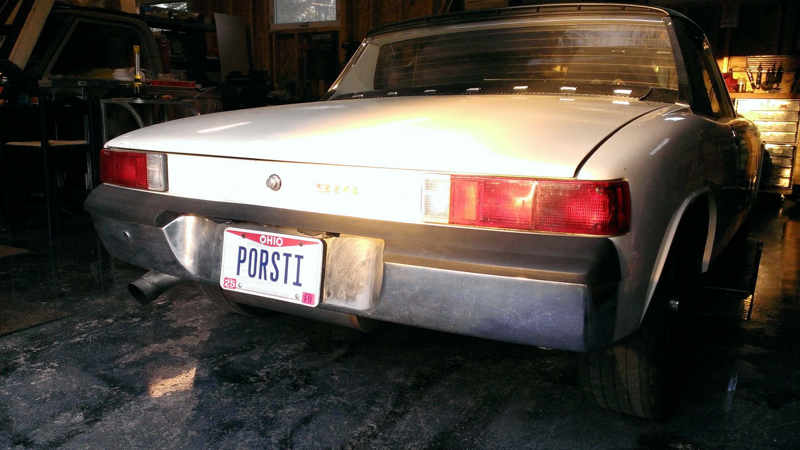

With the car running I had a chance to drive it to get the required out of state vin inspection so that I can register it.
My plate idea was still available!
I actually received the plates last weekend but I have been too busy following CptTripps build thread to update my own!! (IMG:style_emoticons/default/blink.gif)

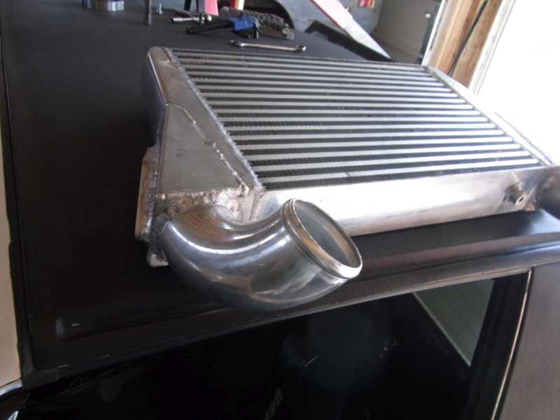

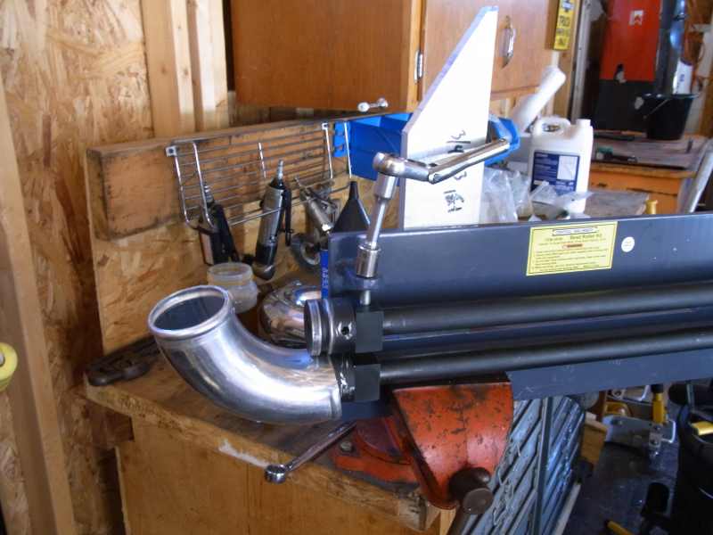

I also hooked up the brake lights and blinkers so the car is legal to drive. Unfortunalty when I took it to go on the madden voyage to the gas station, the car started bucking again...apparently when I was doing burnouts in the driveway earlier in the day I blew a IC hose off again.
Anticipating that this would continue happening I purchased a Harbor Freight Bead Roller during the last super sale.
It does a pretty good job but I had to clamp a reinforcing bar on the back side to keep the rollers aligned.
I even put a bead on the input/output of the IC.
Talked the wife into powering the rollers while I rotated the IC.
Unfortunately I must have something mis-clamped because I am still getting a hesitation. Sucks, I was planning to drive it to work tomorrow.

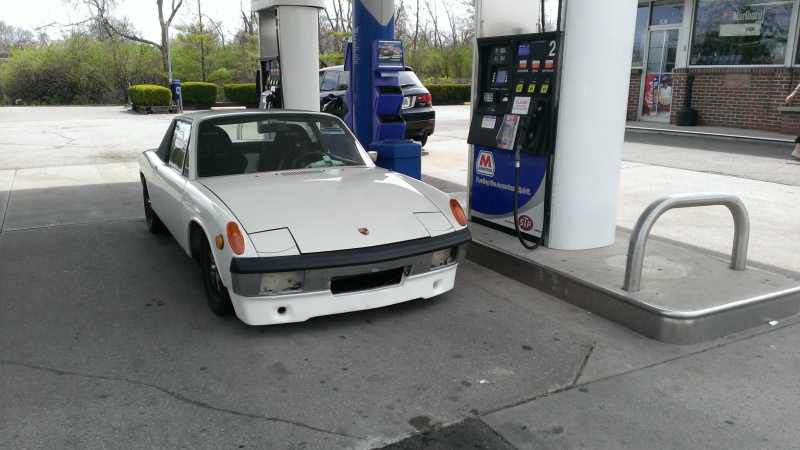

I sorted out the issue with the boost and it is running great again. So great in fact that I decided to drive it to work today.
Took the opportunity to fill it up at the pump for the first time.
I did find that with a full tank, fuel will slosh out of the vent. It is so fun finding issues like this finally!
