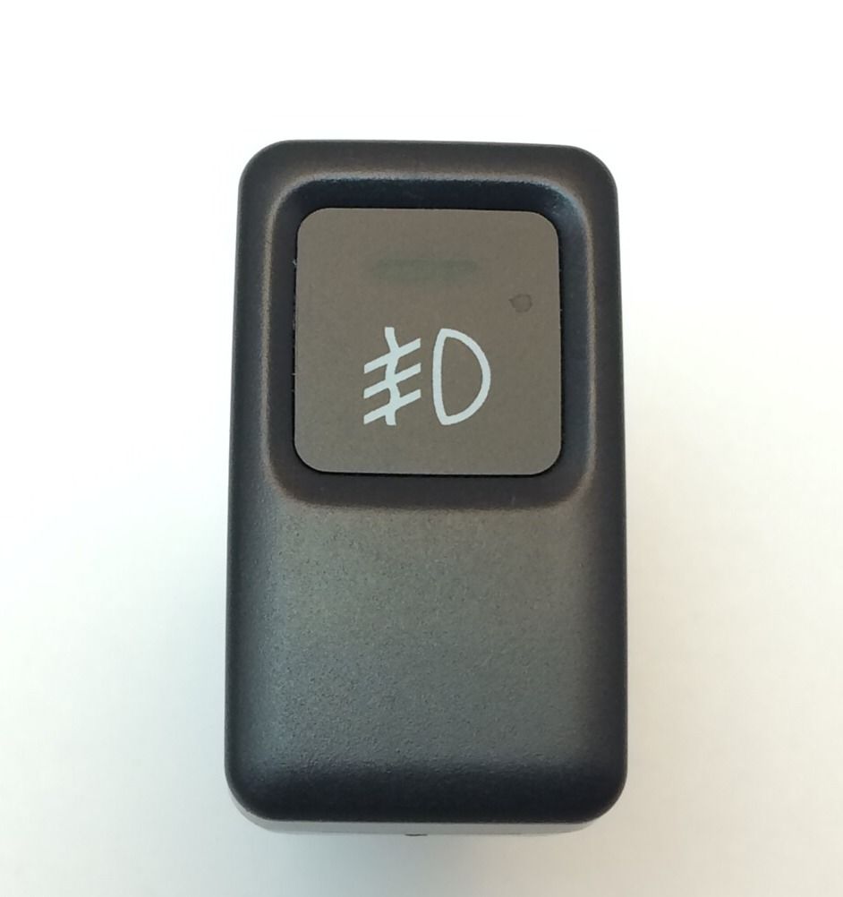

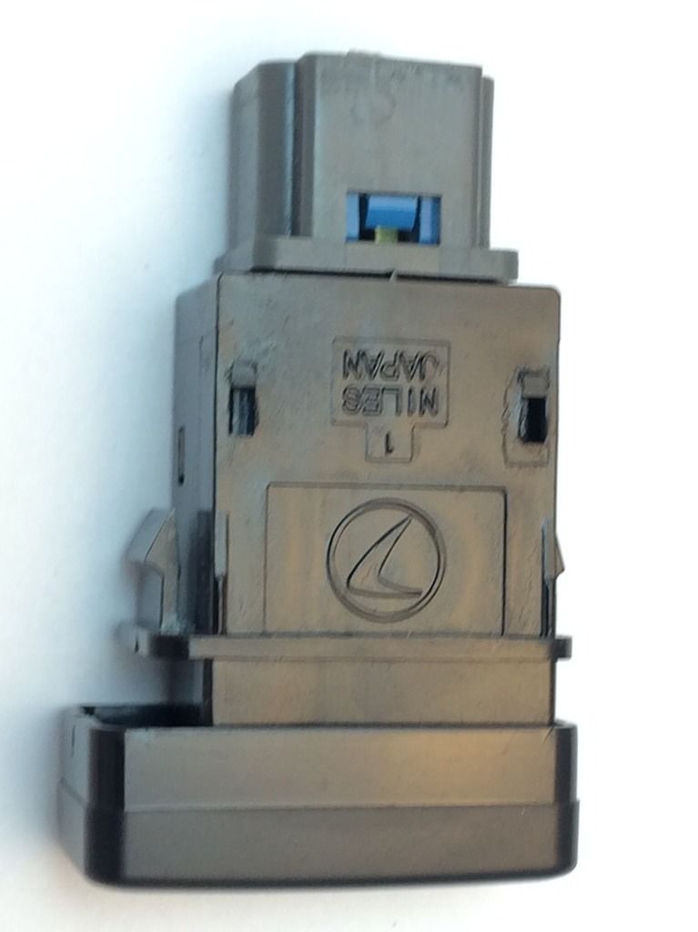

Looks like I lost my Subaru fog light switch. Anybody have one left over from their harness that they want to sell?
It should look like this:

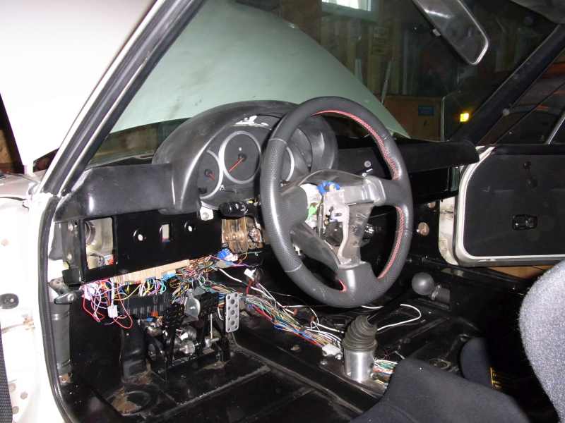

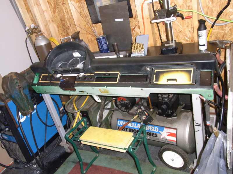

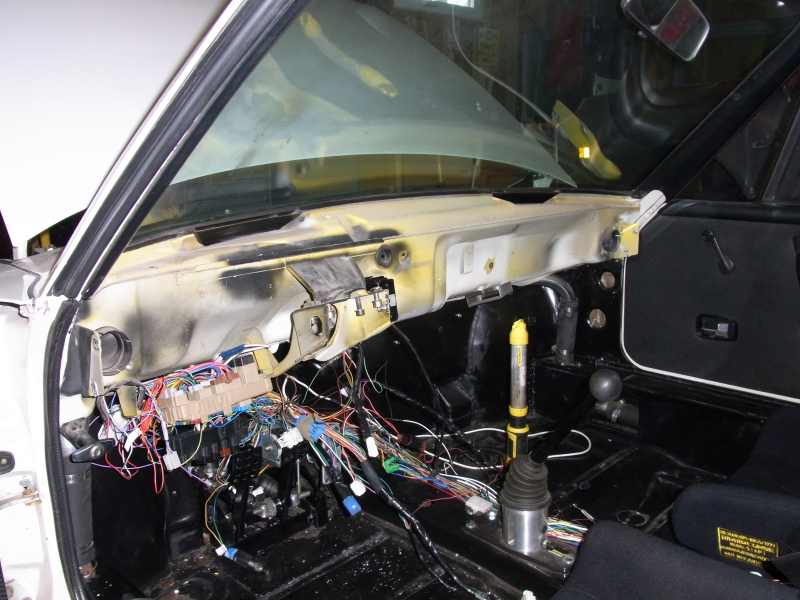

Had another pretty successful weekend in the garage. Spent a few hours cleaning up some unused or poorly routed wires. Then I tackled installing the upper dash.
The metal support dash came out pretty easily.
Mocked up the assembly on the bench so that I could weld up some cuts make to fit the Suby IC.
Many hours of welding, grinding and painting later...it is ready to go back in.
Installed! The paint job is crappy but much better than is was previously.
Now I can accelerate without having to hold the IC in place!

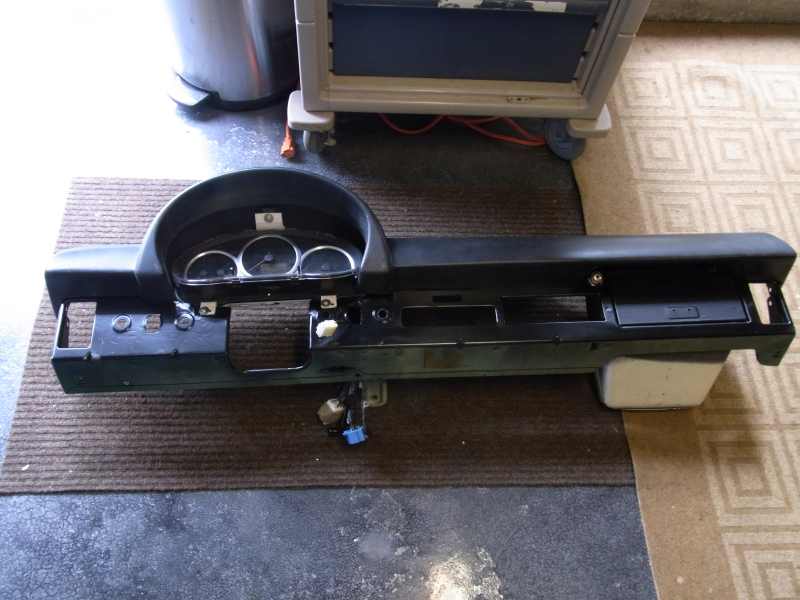

With the dash in and some of the wiring tidied up the car feels almost like a real car. So much so that I have been driving it a lot...apparently too much for the unvented radiator. (IMG:style_emoticons/default/dry.gif)
The engine temps have stayed almost ideal but after a half hour drive through traffic and highway speeds on a beautiful 80 deg day the thing started sputtering and quit on me. Sort of started up enough to get onto a side road where I could check things out. After poking around for a bit I noticed that the fuel pump was not making any noise. Went to touch it and damn near blistered a finger. Apparently containing all of the heat from the radiator in the same area as the fuel cell and heats up the fuel so that it no longer cools pump causing the pump to seize. I did not like the external pump anyways so I picked up one of these:
In Tank Pump
I am also going to apply some adhesive heat barrier to the fuel cell and finally put the hole in the hood so I should be ok.
I found it to be very irritating that the fuel gauge reads backwards so I ordered a new sender.
Sender
I also noticed that the radiator fans were running all of the time and that the ECU was commanding them to do so. After a bit of reading the ECU considers speed when turning on the fans so I guessed that the vehicle speed sensor disconnected fault was causing this. Temporarily hooked up my sensor and the fans work properly. While messing with the sensor I considered that there was no way possible for the speedometer to be correct so after some searching of the internets I found and ordered this wonderful device:
Speedpuls Tachotronic
I was still struggling with a fuel/boost cut type feeling as boost started to build. Again I had convinced myself that it was indeed fuel/boost cut. In preparation to have my car tuned next week I made a quick boost leak tester to confirm that everything was OK. Well, it was not. I had a few small leaks that were together causing a huge loss of air under boost. Welded up a few pinholes and adjusted a few clamps and it is making power again. When I took it out for a test drive last night the roads were a bit damp so I had a load of fun boiling the tires with any moderate throttle apply. (IMG:style_emoticons/default/happy11.gif)
I also found that all of the wheel bearings need to be replaced. I read a number of different explanations on how to remove the rear bearings and would like to try it while on the car w/o the spendy tool. Anybody want to convince me that trying to "tap" them out is a bad idea? I have a press so I could do it that way but really do not want to pull the trailing arms. (IMG:style_emoticons/default/confused24.gif)
I have to say again just how cool the custom dash is that I picked up from ruby914. If you want to use the suby IC you really need to convince him to make one for you.

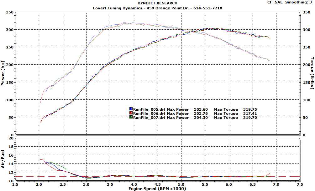

Pretty standard stock turbo results. I had him be a bit conservative so that I can put pretty much any quality of premium and still beat on it w/o any fear of detonation.

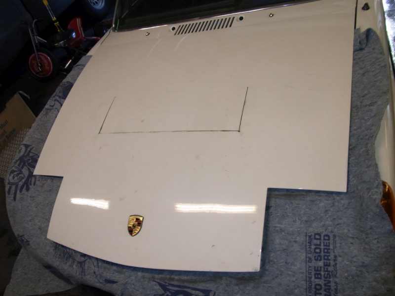

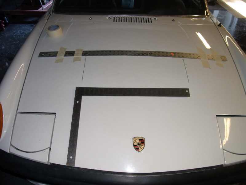

Had a productive day in the garage today and ticked off some major items.
The biggest but least interesting thing was to fill the access holes in the outside of the longs. I always hate doing things that when complete just make it look the way that it should have in the first place. So boring that I did not even take any pictures.

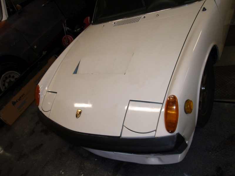

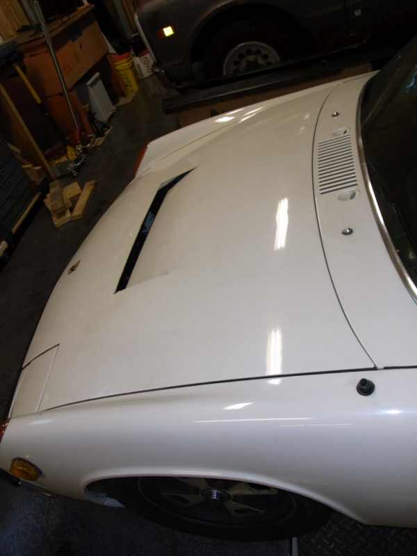

The other thing is something that I have been avoiding....cutting the cooling scoop in the hood. Lots of measuring, marking, measuring, and more measuring...
..then finally some cutting.
Cuts came out almost perfect, wobbled a bit on the longitudinal cut but can't really tell.
Still have to bend it open further and fab in some sides but it should be fairly discrete.
The opening will be about 12cm deep. The cut out is 60cm x 20cm.
Eventually I will fab up ducting to the radiator but that can wait, too many other things to do before the start of HRPT on the 6th.
