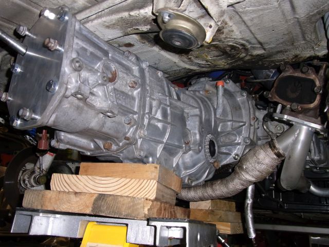

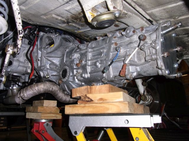

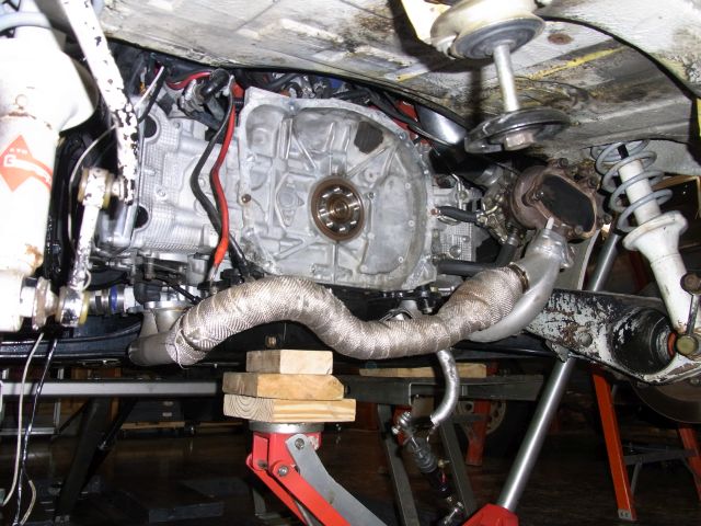

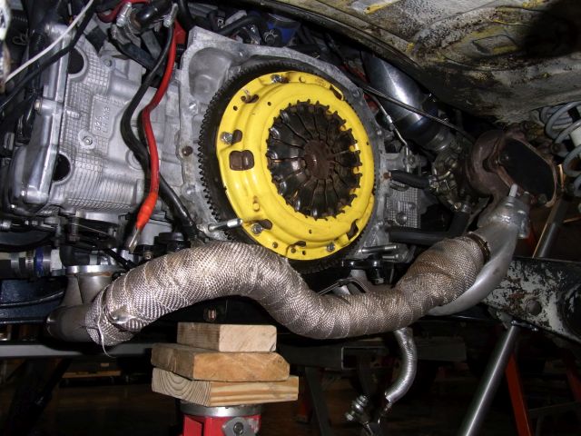

I couldn't stand looking at the suby trans sitting under the bench any longer so I pulled the 901 and bolted up the 5mt after work today. (IMG:style_emoticons/default/smash.gif)
Liberated from the 901.
The clutch assembly feels like it weighs half as much as the KEP parts!
Looks pretty good in there.
Going to have to remake the exhaust cross over.

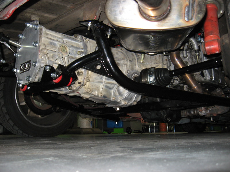

I have the parts and material to make a transmission mount similar to DBCoopers.
Can't wait to start making parts again (IMG:style_emoticons/default/welder.gif)

Eventually I will make a cradle to move the engine/trans back to align the axles better using a hybrid of the back of DBCoopers mount tied in to the trailing arm ears like Ruby914's mount.
Making the transmission side mount now will save a step when I make the new cradle down the road some time.

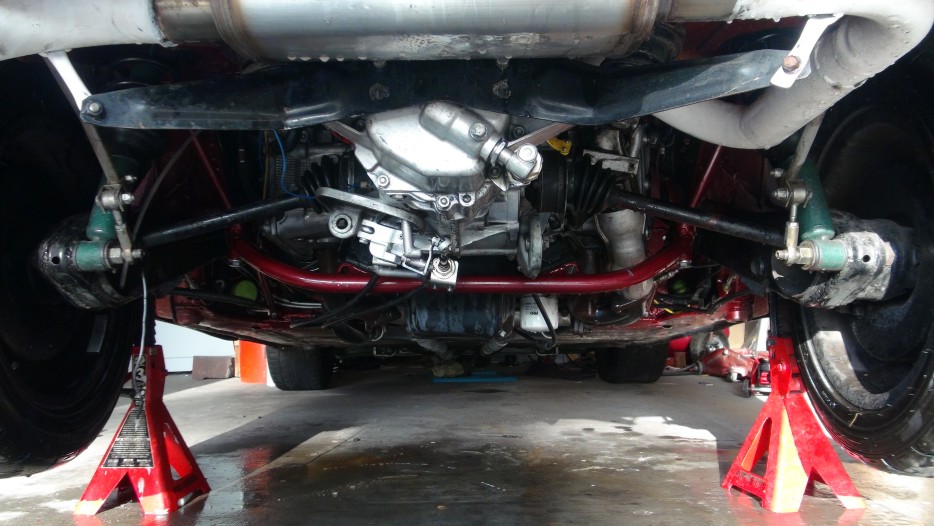

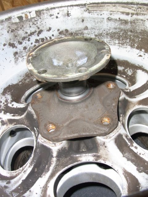

I think that I just stepped on a mid-mue slope...not supper slippery but slick enough. (IMG:style_emoticons/default/rolling.gif)
I have been agonizing over what to do about the CV's. I eventually want to run 108mm CV's but that requires a 5 lug setup, which I really do not want to do now. I can run stock 914's with Ian's conversion axles and then jump to 944's when I do the 5 lug...but then I am stuck with the smaller CV's unless I want to change axles again.
So...I just happen to have a '83 SC Boge front suspension...complete. I did some looking and it seems like the 914 strut inserts will fit the 911 Boge's and the ball joints seem like they should be the same also. Can I really just pop the current struts off of the ball joints, swap the inserts into the SC struts and bolt them back onto the ball joints?
Assuming this is the case, anybody have an 23.3 ET 7x15 phone dial or two laying round that they want to get rid of. I have a set of three, but one is marked as being repaired.
Then I can use my "new" tires (well, at least three of them, one is already on the wear bar for some strange reason (IMG:style_emoticons/default/confused24.gif)) and get this done reasonably inexpensively.
Cheers,
Scott
DBCooper
post Dec 13 2014, 08:21 AM
Post #427
14's in the 13's with ATTITUDE
Posts: 3,079
Joined: 25-August 04
From: Dazed and Confused
Member No.: 2,618
QUOTE(Amenson @ Dec 12 2014, 01:21 PM) *
Ha ha ha, you are SO screwed! Grin and bear it, though, when you're through it it will all be done and good.
Yes you can. I think mine's an 87 so a little different and I think we used the 911 inserts and ball joints, but that's how it's done.
Have fun.

The back of one of the spokes will say "7x15 ET23.3"
I tried to take a picture but they are too dirty to show the numbers clearly.

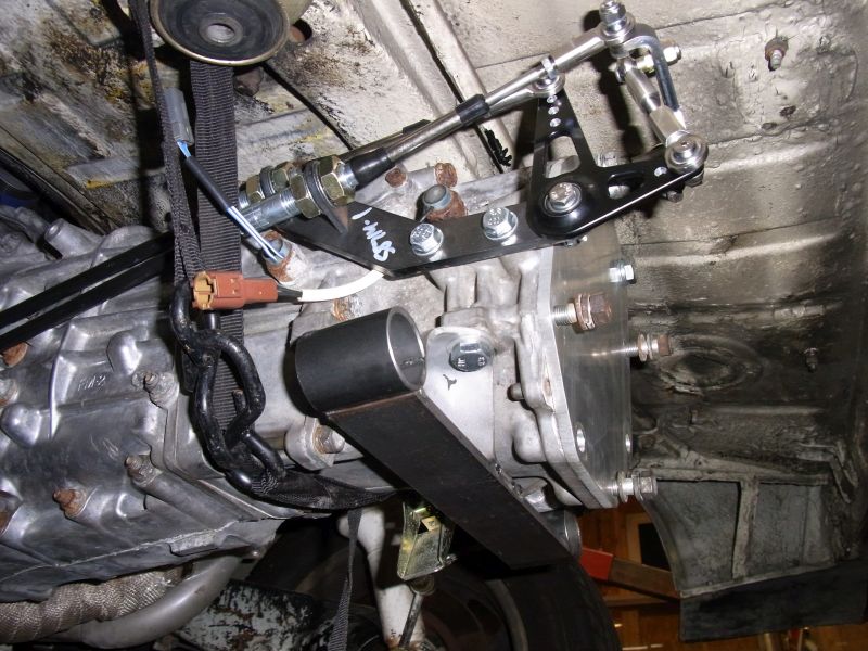

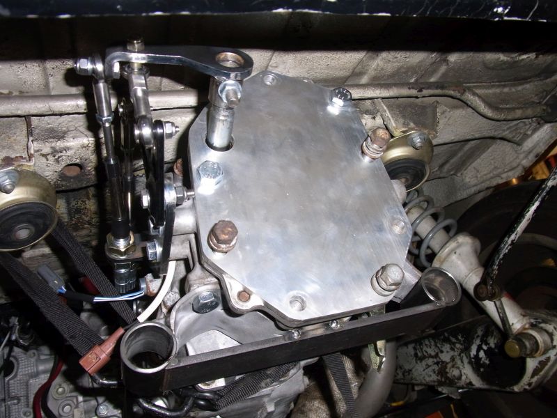

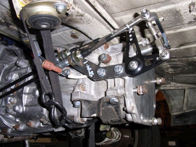

I finally received my cable shift setup from Ian! Also started mocking up the transmission mount. Should have it mostly made tomorrow.
I picked up a pair of 108mm CV stubs and a boxster hub. The base of the hub centric ring has a raised edge that interferes with the phone dials. Should be easy to turn down on a lathe...good incentive to get mine up an running finally. This is not correct...the wheel fits fine with a brake rotor in place (IMG:style_emoticons/default/headbang.gif)
I started pulling apart my SC front struts. I picked up one of Doug's strut wrenches and even using it the nut does not want to budge. Any recommendations?

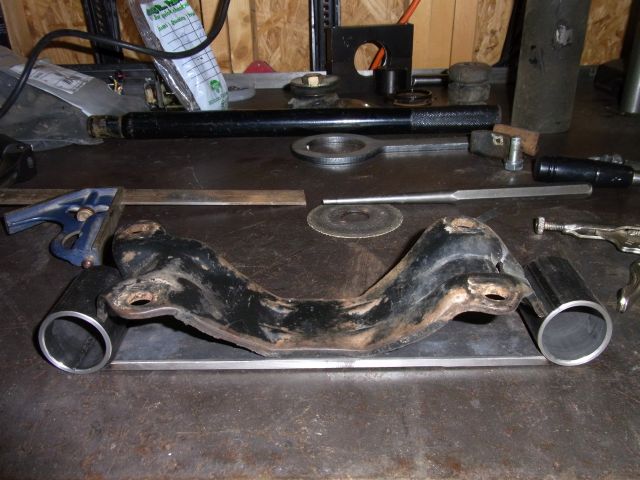

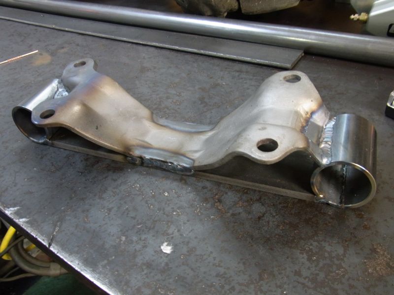

It was great to spend a few hours fabricating today, even got to use my huge new (to Me) anvil to tweak the ears of the stock suby mount into place.
A quick trip through the sandblaster and it will be ready to weld. I was planning to use the MIG but the gaps are tight enough to TIG.
Cheers,
Scott

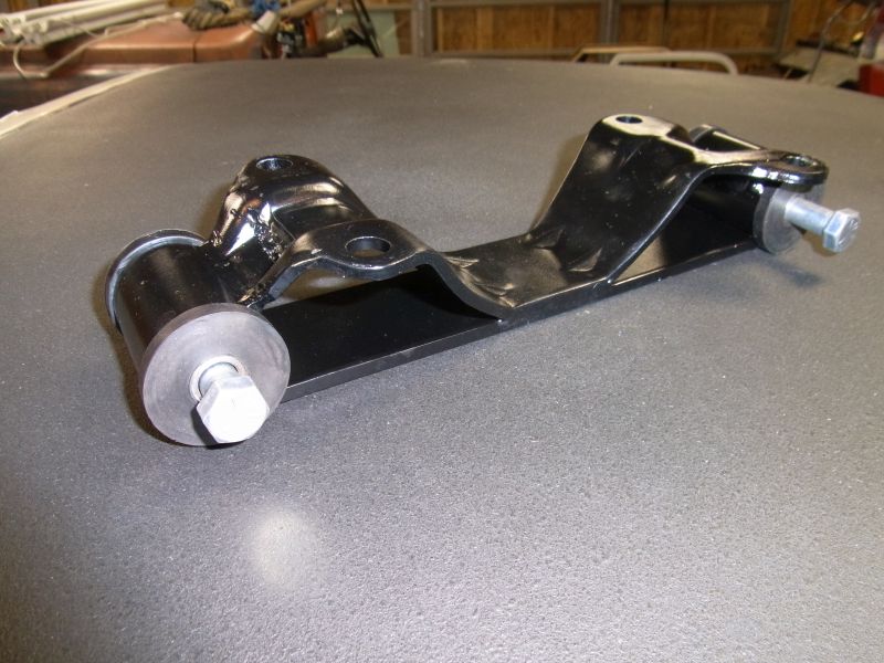

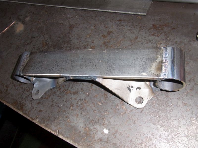

I finally got the transmission side mount cleaned and tacked. The remaining rubber on the half of the mount would not come off. I eventually used a wire brush on my plug in grinder, sandblasted it, more wire brushing, and then more sandblasting.
Now to make the body side part of the mount.

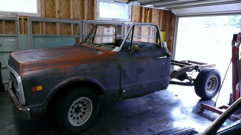

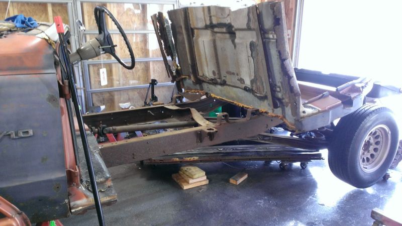

It was a beautiful winter day in Ohio (above 40F) so I took the opportunity to work in the garage.
Welded up the transmission mount.

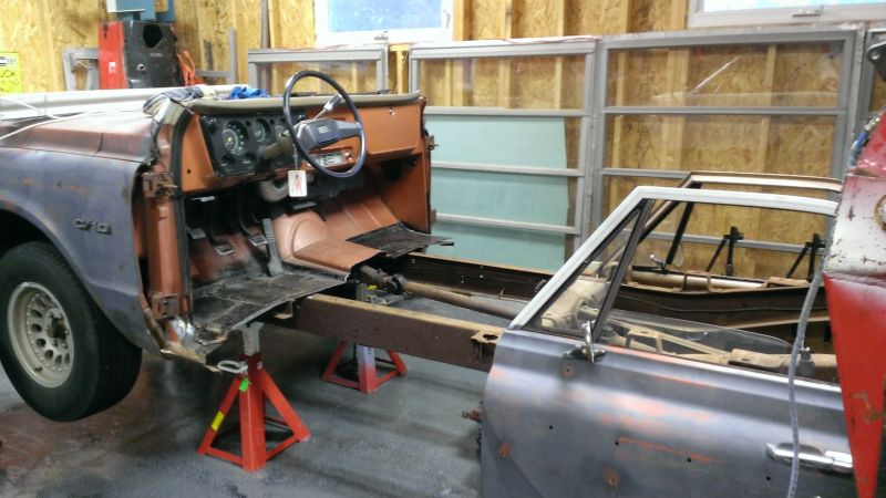

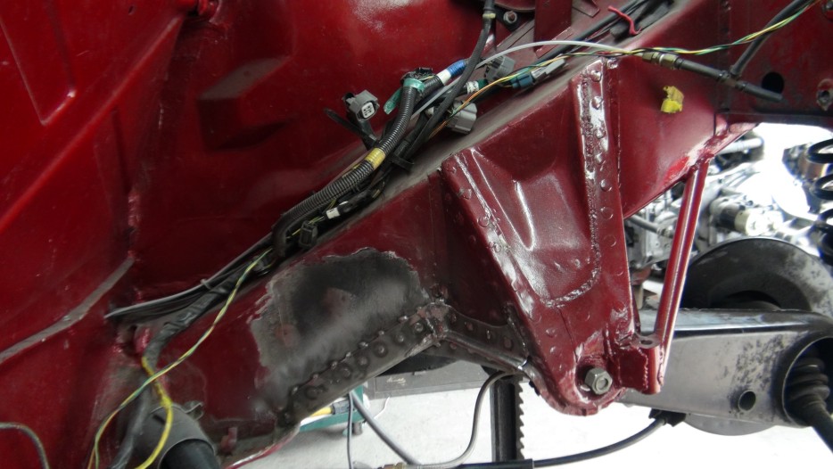

While I was waiting for the paint to dry I jumped over to the other project. Cut the roof off and drove it around at Thanksgiving.
Today I remove the doors, seat, fuel tank and other random stuff from the interior. And started cutting (IMG:style_emoticons/default/sawzall-smiley.gif)
Ready for stage 3, 12 inches out of the center of the frame!
Mmmm, perty:

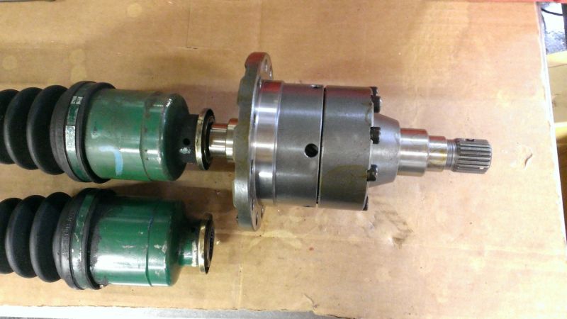

I finally found a set of '04 STI DOJ's for the drive-shafts. Lined up with 108mm cv's, stubs and Boxster Hubs. Should be as strong as I can get with OEM parts.

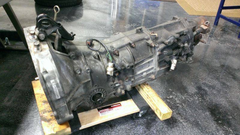

I was shopping for a busted early 2000's suby trans to scavange the VSS assembly from. This what I found:
US Impreza 2.5RS MY99-01 TY754VCAAB
Seems to be in really good condition, was apparently removed from the car to do a STI swap. If anybody in the area is looking for one let me know, I will let it go very cheap once I get the VSS parts removed. 914forme...you know you want to replace the old one you have, all it will cost is your set of tube beaders (IMG:style_emoticons/default/KMA.gif)
On the topic of old 5mt's I would like to share a link to a good overview of the differences between the different generations of Suby 5mt's.
THE-Transmission-Thread-2.0
Apparently the internal oiling of the early transmissions requires the oil slinging off of the center diff to work properly. It is not recommended to use that style in 2wd configuration.
