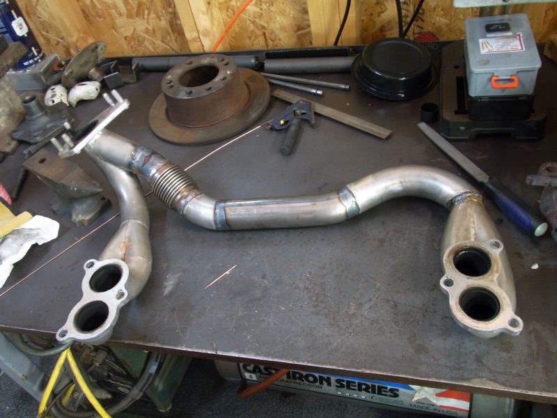

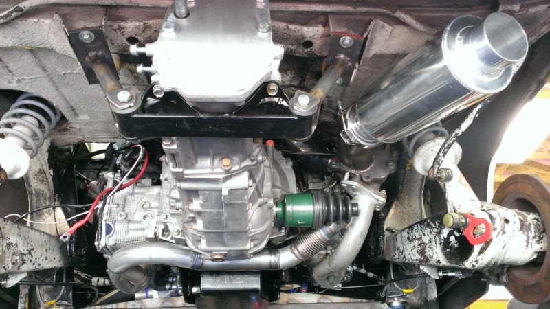

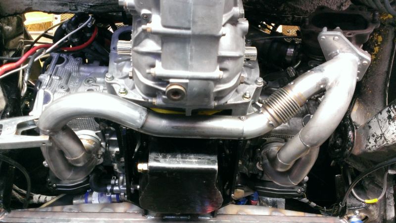

Banged out some big projects this weekend.
Rerouted the header around the new trans and DOJ's. The exhaust get's a bit close to the boot on the passenger side, special measures will need to be taken to keep it alive.
Welding is so much fun with no gaps, some of the joints were so tight I was able to fusion weld them (no filler)!

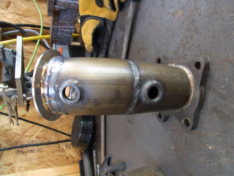

Also hacked the post turbo exhaust to the bare minimum and installed a v-band joint...
...so the rest of it can be done in aluminum. Simplify and add lightness.

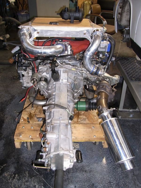

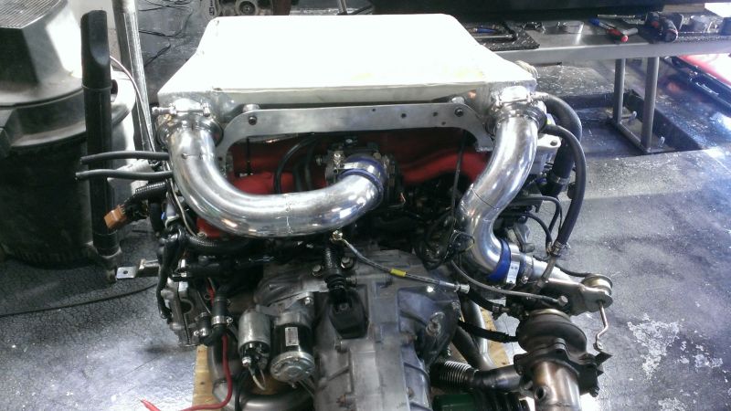

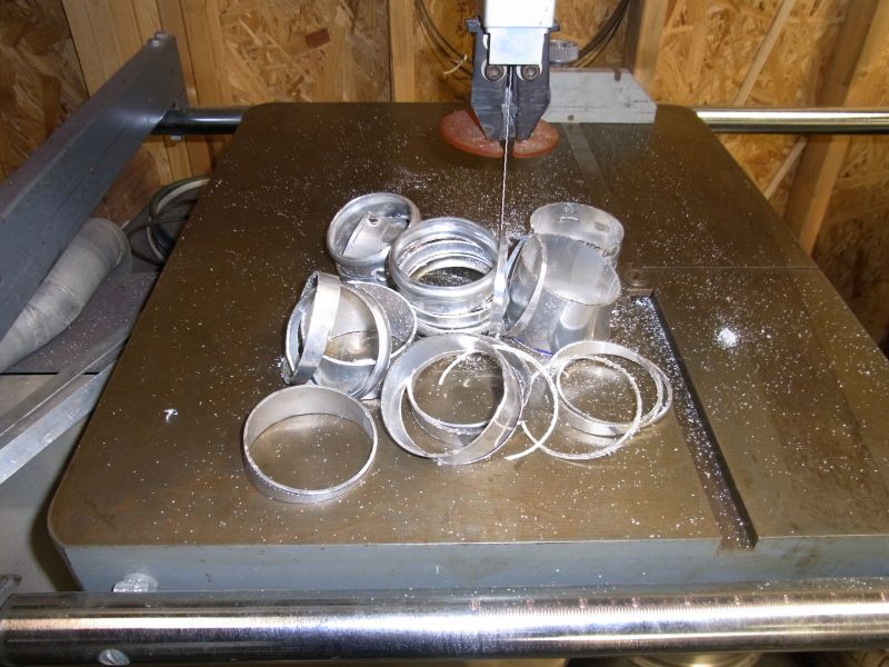

Next on the list were the pesky silicon/clamp joints on the IC plumbing.
Gone...took a lot of cutting.

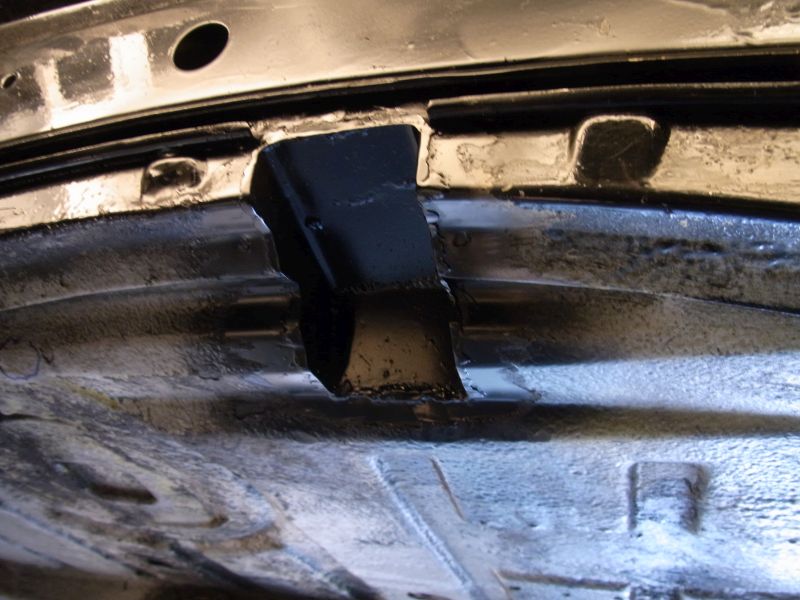

Also made clearance for the clutch fork.
Ran out of argon after tacking the IC tubing so I had to use the mig. Man do I hate grinding welds.
Total package, see if you can pick out all of the other little modifications.

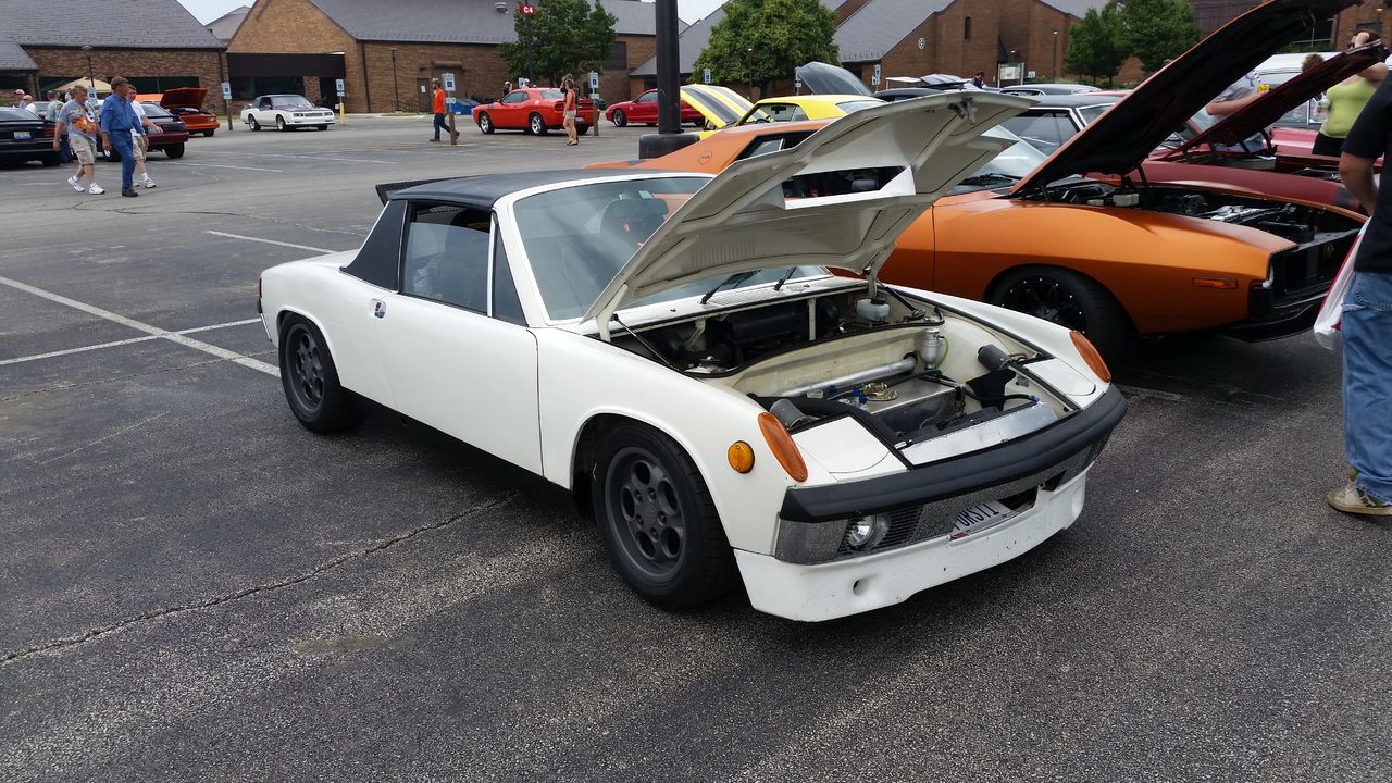

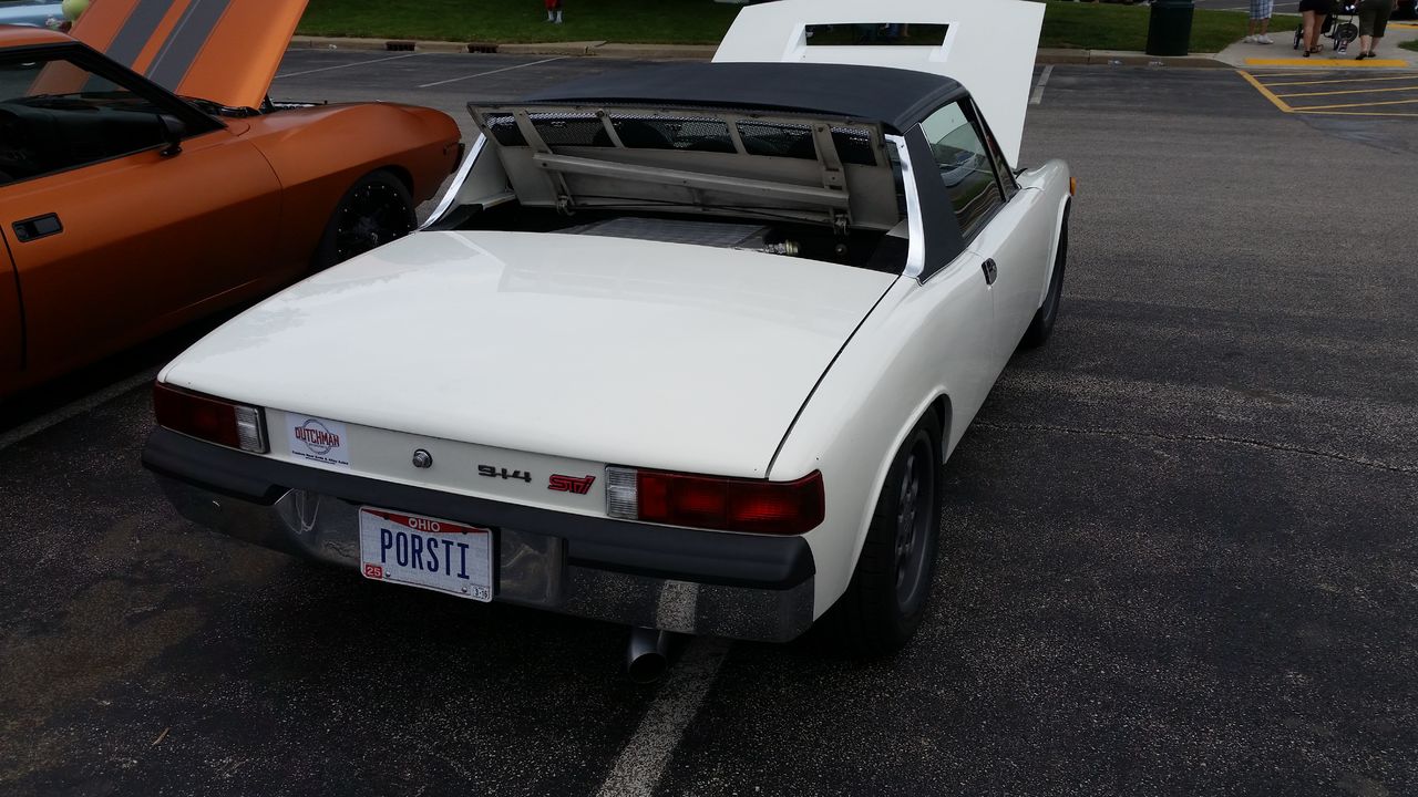

Very nice!
(IMG:http://www.914world.com/bbs2/uploads_offsite/s17.postimg.org-18820-1433817087.1.jpg)
Hello there Mr. Snail. The old Familiar
(IMG:http://www.914world.com/bbs2/uploads_offsite/s17.postimg.org-18820-1433817087.2.jpg)
Very Clean and well done!
(IMG:http://www.914world.com/bbs2/uploads_offsite/s17.postimg.org-18820-1433817087.3.jpg)

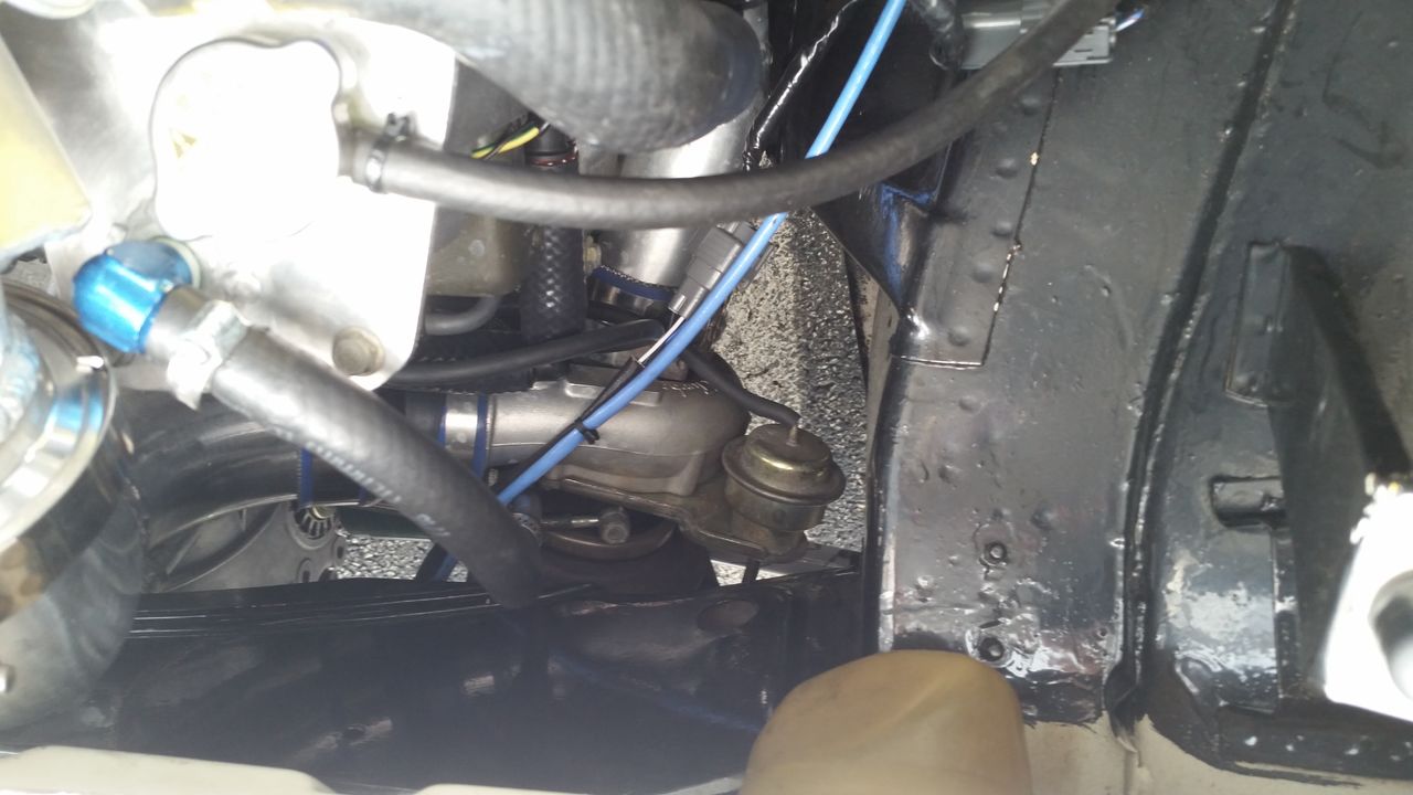

Its hard to tell from the many pics you have posted so I will ask. How much room do you have between the Suby valve cover and the Porsche rear suspension console. (I suppose the threaded stud would be the first point of interference) In a few pics it looks really tight then in others it appears to be a few inches. Could you take a measurement for me?
Amenson
post Jun 24 2015, 06:43 AM
Post #496
That's opposite lock!!
Posts: 645
Joined: 27-May 05
From: Dublin, OH
Member No.: 4,154
QUOTE(Tyler E @ Jun 22 2015, 08:16 PM) *
I've just finished reading 25 pages of a really well thought out and beautifully executed build. Damn!
Thanks for the very kind feedback.
There is a generous 3.5cm clearance between the valve cover and the suspension ear (IMG:style_emoticons/default/dry.gif).
