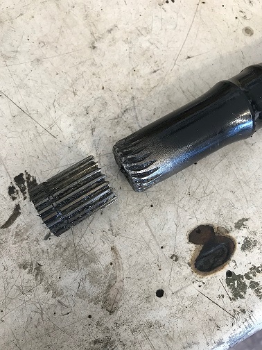

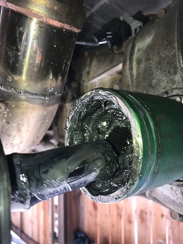

I was really enjoying the added power at a Vapor Trails Corvette club autocross today, and even with street tires I was hanging with some very fast cars. Unfortunately, I never got around to borrowing my daughter's GoPro, so no videos. On my fourth run, I decided to launch a little harder... big mistake. I usually launch at 3,500 rpms, but thought I could amp it up a bit and I launched at 5k. Bang! I pulled to the side of the track and quickly realized that things were not right on the transaxle end of my passenger side axle.
Below is a pic of the Subaru "tripod" joint after peeling back the rubber boot, followed by a pic of the failed part. These are stock 1976 911 axles that I had shortened and resplined by Dutchman for the Subaru joint. Major twistage failure.
I honestly thought the inner Subaru tripod or outer 911 CV would act as the fuse, but obviously I was wrong. I will call Dutchman on Monday to see what my options are. I might spring for a set of 4340 Cro-Mo or Hy-Tuf custom shafts, depending upon price.

Bummer on the failure, but now you know.
Did a V8 swap into a Olds Bravada once, the AWD SUV, it was hast as hell! But you would fix one thing and the next would break. Took pieces to the drive line guys and they said what are you building a rolling dyno. And I guess he was 100% correct. I was building a torture test device for each part of the driveline.
What I am shocked about is you generated enough shock to shear the axle like that on street tires. That is pretty impressive
Are you running an LSD? I forget (IMG:style_emoticons/default/confused24.gif)
BTW, your harder launch was most likely the driving force to nail in the coffin. I am beating that you twisted it a bit on each run. And that axle might not have been hardened again after the splining process. My engineering curiosity would love to see the other side, especially if you have an LSD. You should see similar damage to the other axle unless one side is defective.

The AXLE broke???? Wow. First one I've heard of. At least it broke on the trans end. Otherwise it could have gotten loose and beat the crap out of everything around it.

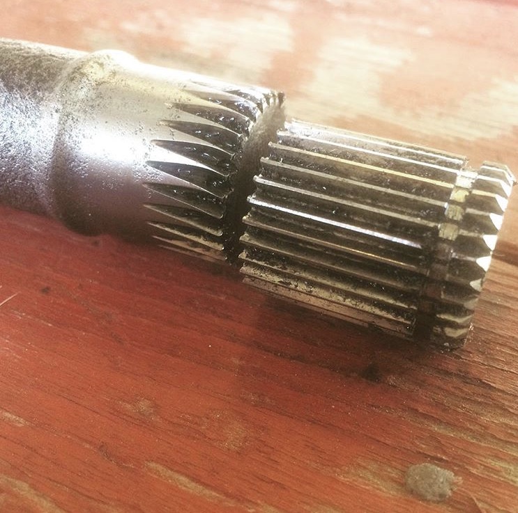

I had the exact same problem, broke the axle in half on the suby side, but it also blew up the Porsche joint at the same time (IMG:style_emoticons/default/WTF.gif) I just had another axle resplined and i live on and slip the clutch on. One day ill get some 4340’sAttached Image

I just got off the phone with Derrick at Dutchman Axles. I will be sending in my mock-up axle (see post #179) and the two "female" CV pieces in the next day or two. I'm going with Hy-Tuf material for $585 for the pair; turnaround is about a week. Stay tuned!

Looks familiar (IMG:style_emoticons/default/beerchug.gif) Did your axle break due to a hard launch? Dutchman recommends their Hy-Tuf material over the 4340s. I didn't ask about any price differential...

The problem is likely that they did not re-heat treat after the cut. The OEM axles are only treated to a certain depth and the new spline roots are likely far below that depth.
I had the exact same failure on a car with recut splines on an open wheeled racecar a few years ago. It was actually a little worse in that the axle longitudinally split to relieve stress at the same time. The next time we sent them to heat treat after cutting and never had another failure.

Yep, a hard launch on a dragstrip with sticky 245s, I talked to dutchman a while ago but I didn’t end up buying (yet) i will someday. As for the material I have no idea about the material strength of either or price. I just know that 300m isn’t exactly ideal for my axles (that i do remember)
