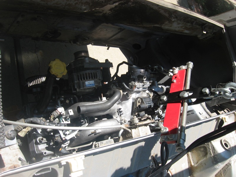

I'm reversing the intake on my EJ22T engine to permit a bit more room between the throttle body and trunk firewall. It also will permit fewer bends for the intercooler connections.
First off, the 2.0, 2.2 and early 2.5 engines feature the intake-to-head bolt holes in a line, which makes this a relatively straightforward modification. In short, the intake manifold bolts on facing backward or forward, but it ain't quite a bolt-on and walk away affair...
Reversing the intake points the throttle body right at the backside of the alternator. Since I won't be using the air conditioning compressor or power steering pump, I relocated the alternator to where the AC compressor used to sit. Here is a pic of the factory bracket, modified to clear the Idle Air Control solenoid. You can also see where I welded on the alternator mounts and support crossbar.
This took a lot of measuring, cutting, more measuring, grinding, more measuring... you get the idea. But it lines up perfectly with the crank pulley. Here is a pic of the alternator as mounted (I still have to fabricate a top mount).
Here is the front and rear views of the engine, not including the wiring harness, coil or fuel rails/injectors.

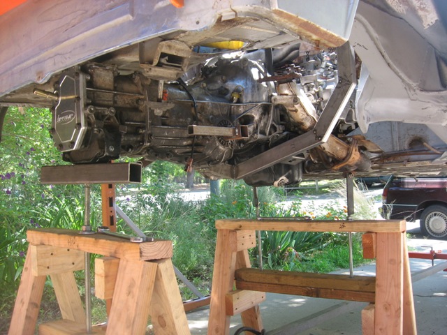

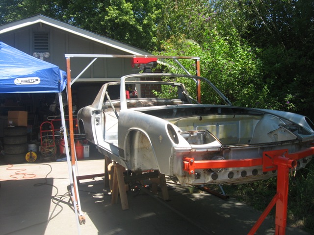

Over the past few weeks, I've been cleaning up and working on the engine, getting it ready to shoehorn in. Suby engines are cheap (especially if you buy a whole parts car and sell off the leftovers!), but it ain't so cheap to buy gaskets and ancillary parts. I replaced all o-rings and assorted gaskets, the water pump, belts and hoses, and had the injectors cleaned/blueprinted by Witchunter. All told, this effort required about $400, but it should ensure a leak-free engine.
I picked up some scrap metal and an electric hoist on Craigslist to build a gantry, as presented below. It is ugly, but it works great for lifting up the engine up to the height of the rotisserie'd tub. However, the rear firewall gets in the way to effectively position the engine exactly where it needs to be, so I built a couple of sawhorses with adjustable-height mechanisms to get the engine where it needs to be. In this scenario, I set the engine at the desired angle and then move the rotisserie'd car where it needs to be. Take a look at the pics:
