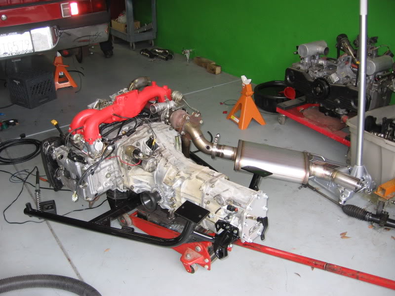

OK, I’ve been traveling so haven’t posted, but some serious progress has been made.

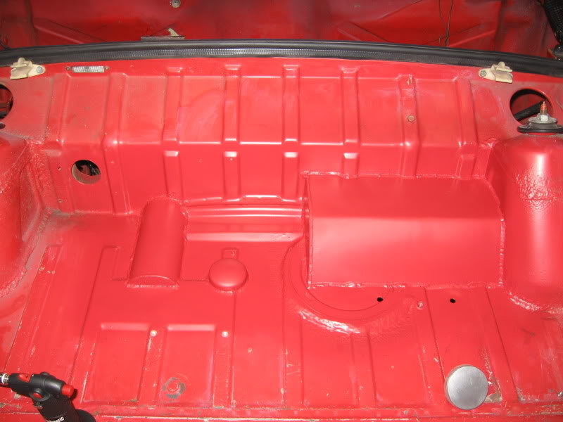

We’re now officially past the jack stand stage. Those boxed in areas in the trunk are now painted.
(IMG:http://www.914world.com/bbs2/uploads_offsite/i255.photobucket.com-2618-1269179830.1.jpg)

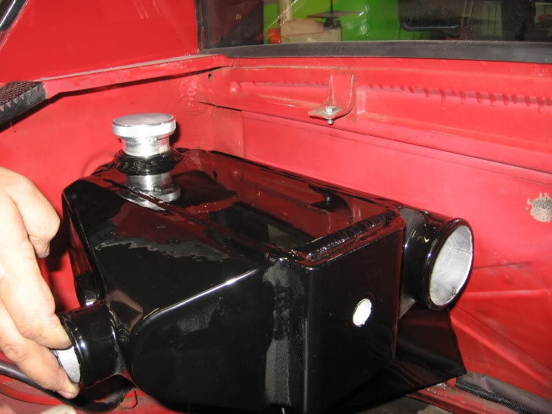

And the intercooler powder coated:
(IMG:http://www.914world.com/bbs2/uploads_offsite/i255.photobucket.com-2618-1269179831.2.jpg)

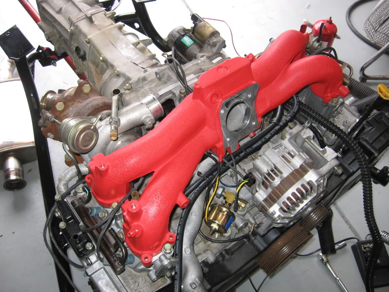

It will look good with all the stainless steel inlet tubing. The manifold was re-painted after the bosses were removed:
(IMG:http://www.914world.com/bbs2/uploads_offsite/i255.photobucket.com-2618-1269179831.3.jpg)
How the flipped manifold will look on the engine, pretty clean:
(IMG:http://www.914world.com/bbs2/uploads_offsite/i255.photobucket.com-2618-1269179832.4.jpg)

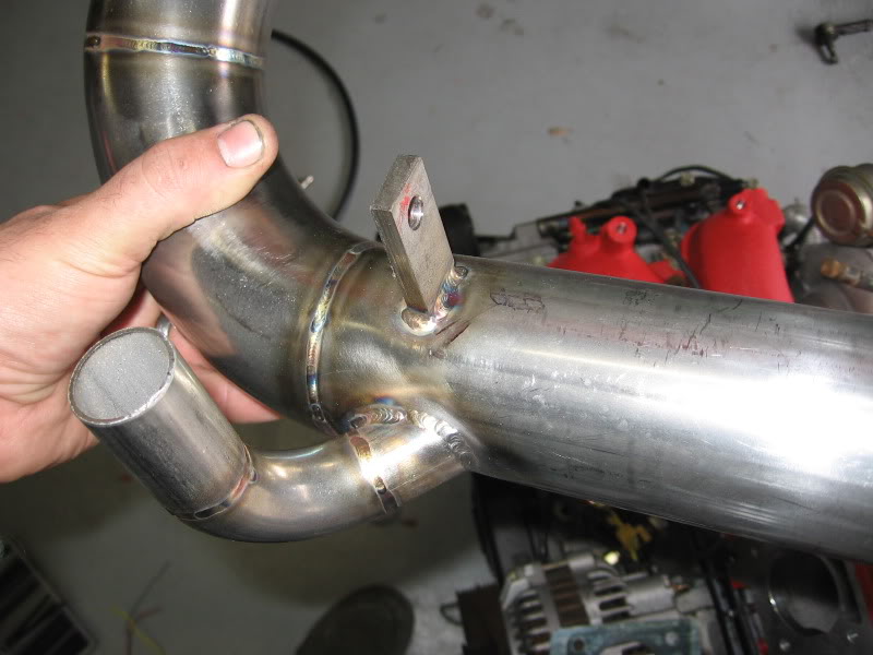

The inlet pipe so we’ll recirculate instead of dumping it out:
(IMG:http://www.914world.com/bbs2/uploads_offsite/i255.photobucket.com-2618-1269179833.5.jpg)

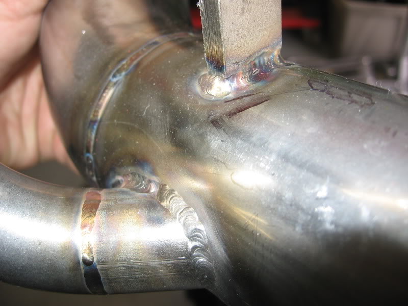

Nice welds. I grew up in vineyards so when I was younger and thinking about what I wanted to do with my life one of the ideas was to be a cooper. Honest work with good people around good wine. I still think about that sometimes, what if, but if I’d known about welding stainless steel I would have had other ideas. This is extremely cool and I wish I could do as well myself:
(IMG:http://www.914world.com/bbs2/uploads_offsite/i255.photobucket.com-2618-1269179833.6.jpg)

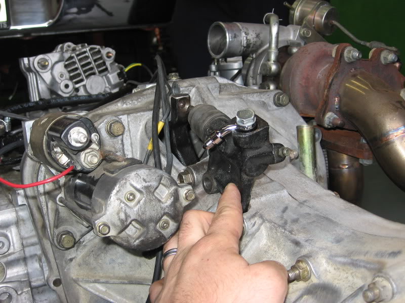

The Tilton fitting for the clutch slave:
(IMG:http://www.914world.com/bbs2/uploads_offsite/i255.photobucket.com-2618-1269179834.7.jpg)

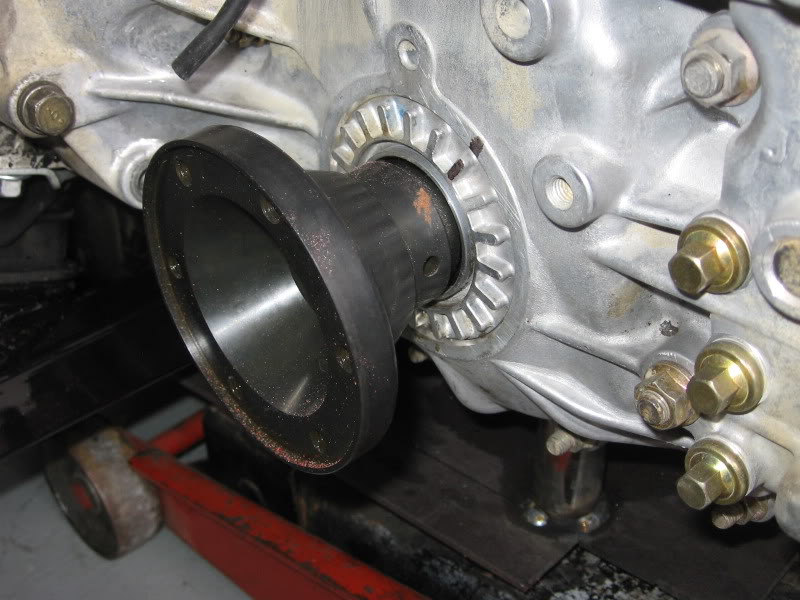

One of the adapter flanges. A little concern here because it fit a bit loosely on the splines compared with the stock Subaru. We’ll see. Hopefully we won’t break them (my son is a specialist in destructive testing) but if we do we may have to try custom axles:
(IMG:http://www.914world.com/bbs2/uploads_offsite/i255.photobucket.com-2618-1269179835.8.jpg)

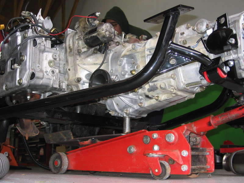

A broad view of the cradle:
(IMG:http://www.914world.com/bbs2/uploads_offsite/i255.photobucket.com-2618-1269179835.9.jpg)

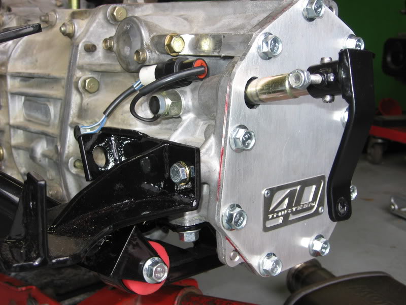

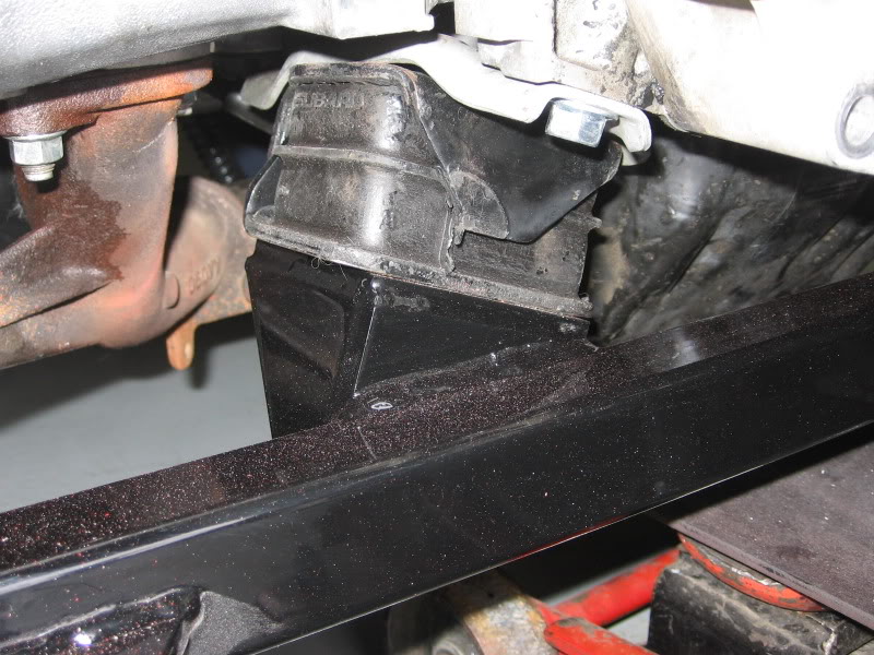

Genuine OEM Subaru motor mounts ought to keep things in place:
(IMG:http://www.914world.com/bbs2/uploads_offsite/i255.photobucket.com-2618-1269179836.10.jpg)
The rear of the cradle on the transmission end, with the cable shifter brackets:
(IMG:http://www.914world.com/bbs2/uploads_offsite/i255.photobucket.com-2618-1269179837.11.jpg)

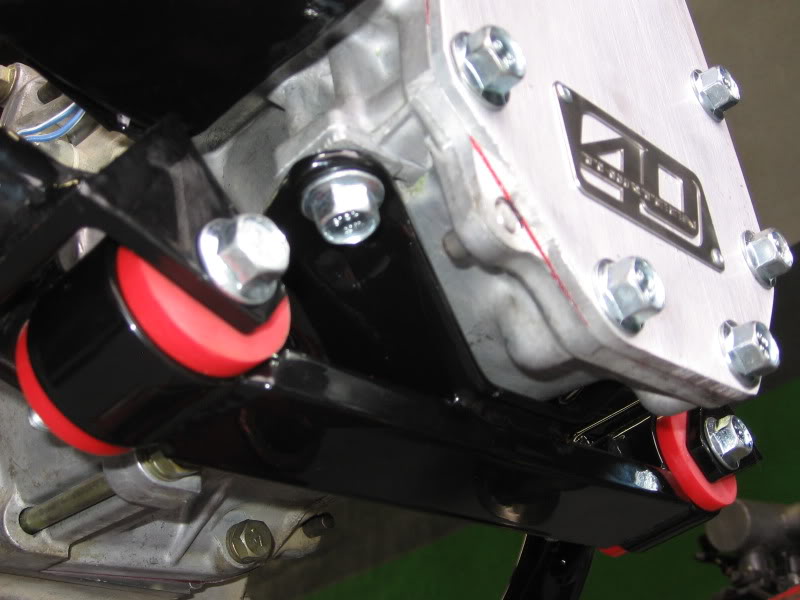

And the rear mounts, looking really good with the black powder coating:
(IMG:http://www.914world.com/bbs2/uploads_offsite/i255.photobucket.com-2618-1269179837.12.jpg)
What’s nice about using a cradle is how easy it is to remove the whole assembly. Not that we intend to do that a lot, but when necessary it’s nice to have thought ahead. Quick waterproof connectors on the wiring looms:
(IMG:http://www.914world.com/bbs2/uploads_offsite/i255.photobucket.com-2618-1269179838.13.jpg)

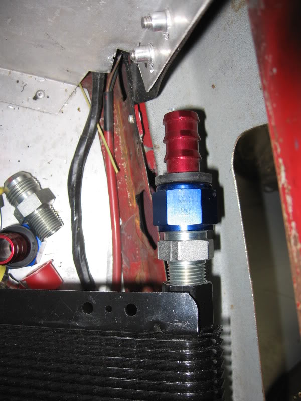

And the water connection in the front:
(IMG:http://www.914world.com/bbs2/uploads_offsite/i255.photobucket.com-2618-1269179838.14.jpg)
Then the axles, throttle cable, clutch hydraulic, gas lines, and the whole thing drops as a unit. Almost as easy as it sounds. I know Jeff ought to be pretty good at it by now, he’s aready had the thing in and out so many times.
(IMG:http://www.914world.com/bbs2/uploads_offsite/i255.photobucket.com-2618-1269179839.15.jpg)
It looks a little weird, but the exhaust should outlet in the “normal” place in the valance, if we use one. I don’t think we will. Normal on the right hand side anyway. When the turbo gets through chopping up the exhaust sound it’s actually pretty quiet before it even gets to the little Magnaflow. I describe the sound as the healthy half of a V8, pretty quiet to 5000 rpm’s but then it begins a seriously nasty howl.
Like I said before, Jeff does some really beautiful work. This is going to be fun.

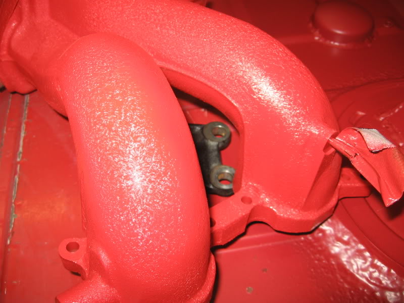

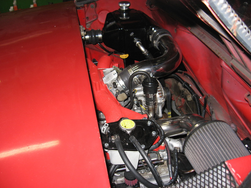

Engine bay seen from the other side, with the de-bossed and now re-painted manifold. We'll leave the stock overflow tank on the aircleaner side of the manifold, so those bosses are still there.:
(IMG:http://i379.photobucket.com/albums/oo234/paulillick/polished023.jpg)

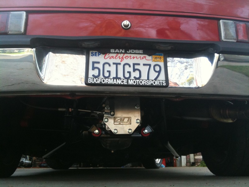

And how the muffler fits under the rear, with the new exhaust exit:
(IMG:http://i379.photobucket.com/albums/oo234/paulillick/polished007.jpg)

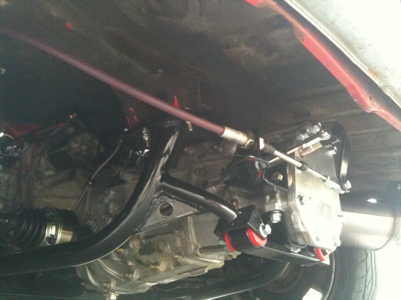

Underneath, the shifter and cables.
(IMG:http://www.914world.com/bbs2/uploads_offsite/i379.photobucket.com-2618-1268855709.2.jpg)

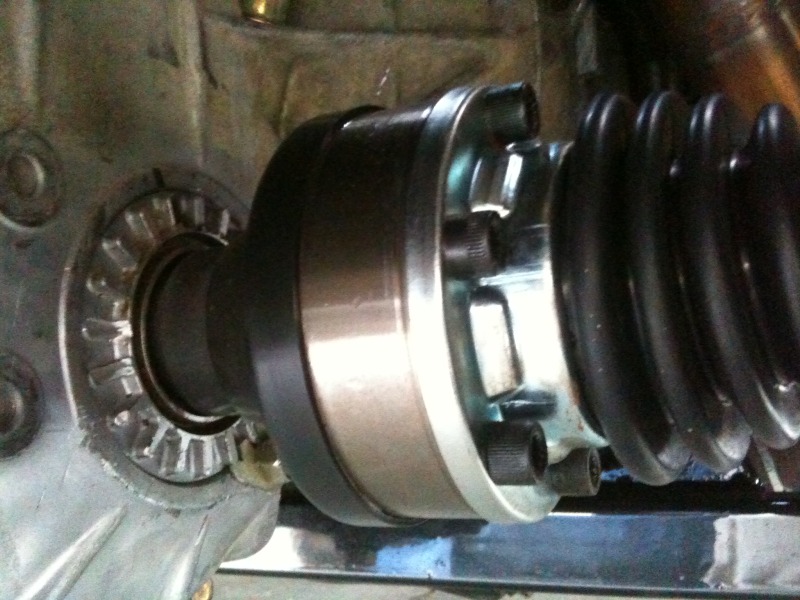

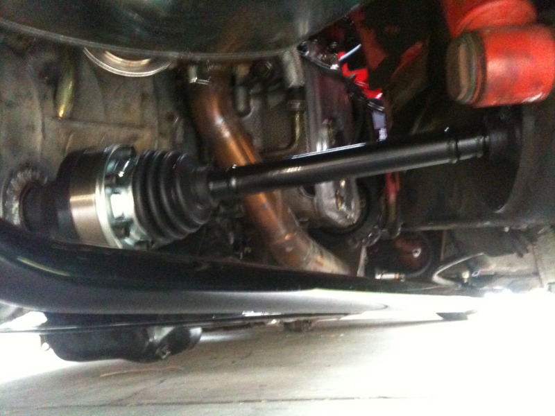

See the axles and those nice flange adapters Steve? You need to be proud! And thanks, Andy, for letting us borrow that camera!
(IMG:http://www.914world.com/bbs2/uploads_offsite/i379.photobucket.com-2618-1268855709.3.jpg)
A closer view of the flanges:
(IMG:http://www.914world.com/bbs2/uploads_offsite/i379.photobucket.com-2618-1268855710.4.jpg)

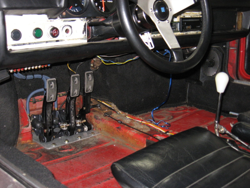

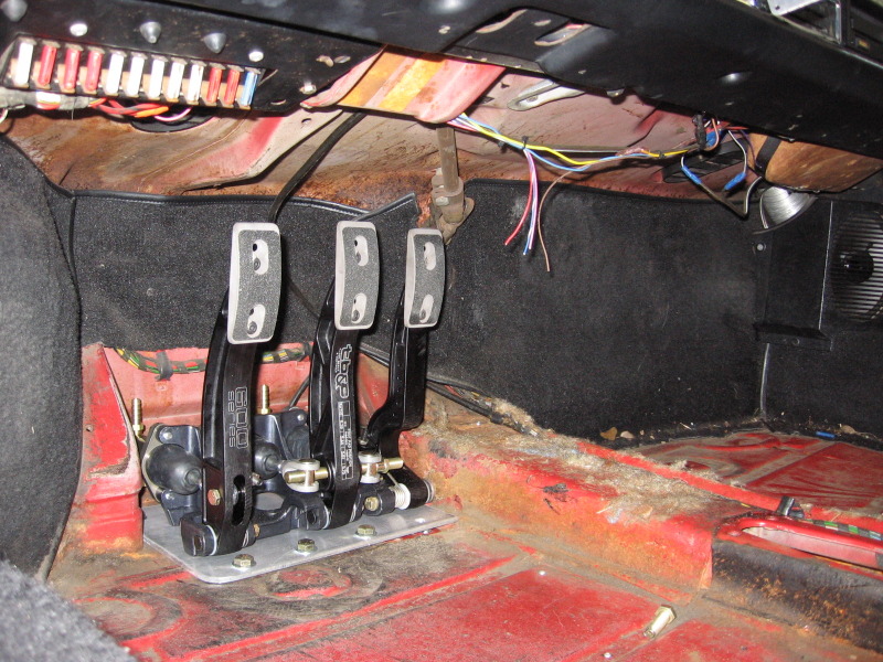

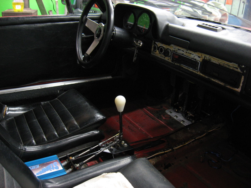

The Tilton pedals in place. Still some work to do on that interior. It should have been done already, but once that WRX motor was in it was so much fun to drive I yielded to temptation every time and headed up into the hills instead of working on it.
(IMG:http://www.914world.com/bbs2/uploads_offsite/i379.photobucket.com-2618-1268855711.5.jpg)
The shifter, cables and ECU. That will all be covered with an armrest/storage cubby.
(IMG:http://www.914world.com/bbs2/uploads_offsite/i379.photobucket.com-2618-1268855712.6.jpg)

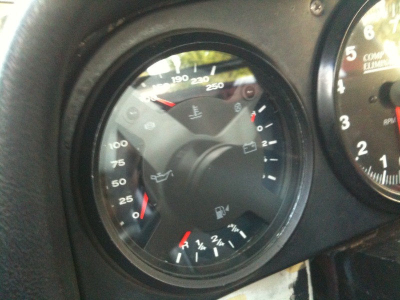

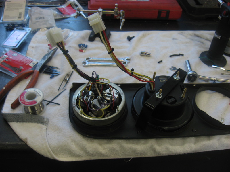

Going to get rid of the gauges on the console where they're hard to see, so will just need one quad gauge.
(IMG:http://www.914world.com/bbs2/uploads_offsite/i379.photobucket.com-2618-1268855713.7.jpg)
(IMG:http://www.914world.com/bbs2/uploads_offsite/i379.photobucket.com-2618-1268855714.8.jpg)

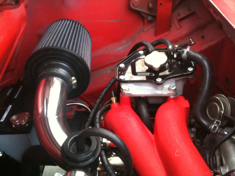

Engine compartment, now complete.
(IMG:http://www.914world.com/bbs2/uploads_offsite/i379.photobucket.com-2618-1268855714.9.jpg)
(IMG:http://www.914world.com/bbs2/uploads_offsite/i379.photobucket.com-2618-1268855715.10.jpg)

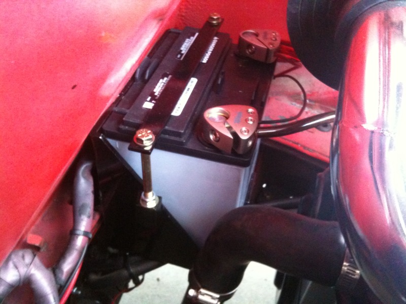

Miata battery hiding under the air filter. Smaller and lighter than a stock battery, with that lighter weight located down lower, too.

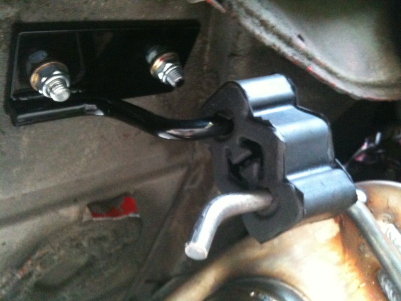

Talk about attention to detail, look at this powder coated muffler hangar. With nylock nuts even!
(IMG:http://www.914world.com/bbs2/uploads_offsite/i379.photobucket.com-2618-1268855717.12.jpg)

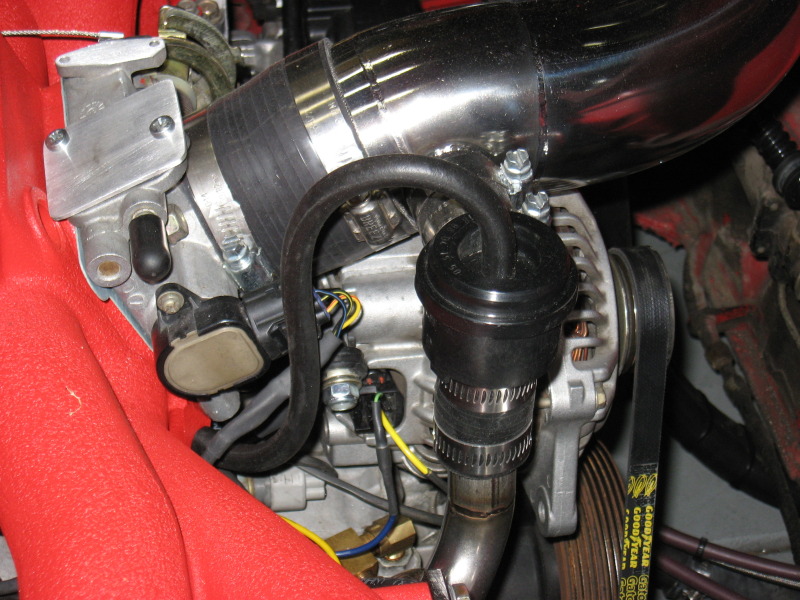

And the blowoff routed back into the intake instead of being vented. I can live without the “pfffttt!” sound, don’t feel the need to impress no ricer boys.
(IMG:http://www.914world.com/bbs2/uploads_offsite/i379.photobucket.com-2618-1268855718.13.jpg)

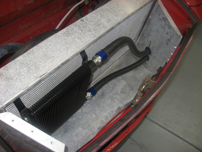

The forward intercooler heat exchanger, and still enough space for an A/C condenser in the future.
(IMG:http://www.914world.com/bbs2/uploads_offsite/i379.photobucket.com-2618-1268855719.14.jpg)

As part of their destructive testing program the kids took the car to a PCA autocross in Stockton.
(IMG:http://www.914world.com/bbs2/uploads_offsite/i255.photobucket.com-2618-1269561145.1.jpg)
Good news is that they didn't break anything. Bad news is that we're back at square one for suspension setup. They say the front end pushes badly at low speeds, and, surprise surprise, the back end goes liquid under power. Their suggestion is flares and big stickies, but that isn't going to happen. All I want is a narrow-body sleeper. So it looks like bigger 7 inch wheels on the front (it's now 6's and 7's) and learning how to drive it differently, moderating the power a little better. Then we'll tweak as we go along.
All in all it's great, a total success and a helluva lot of fun to drive.
