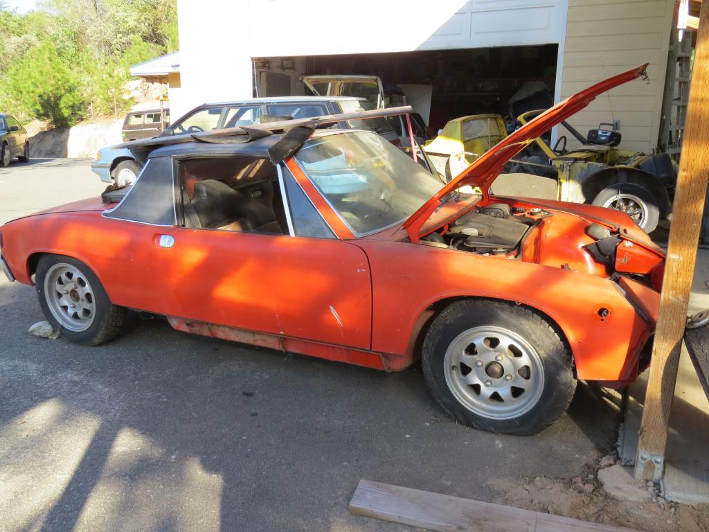

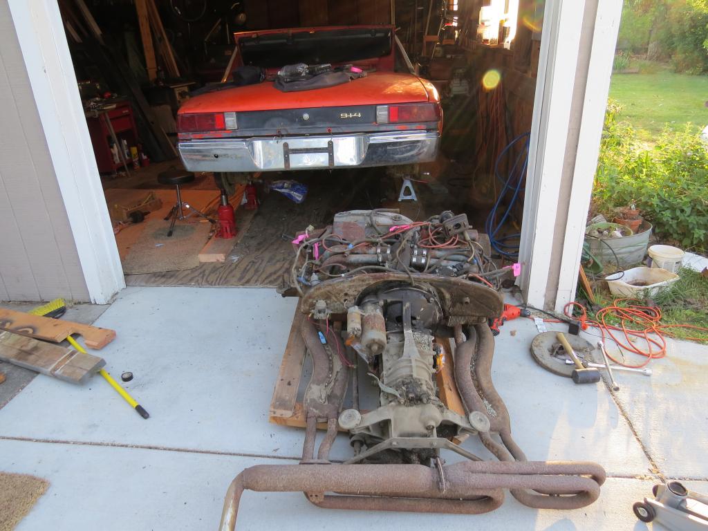

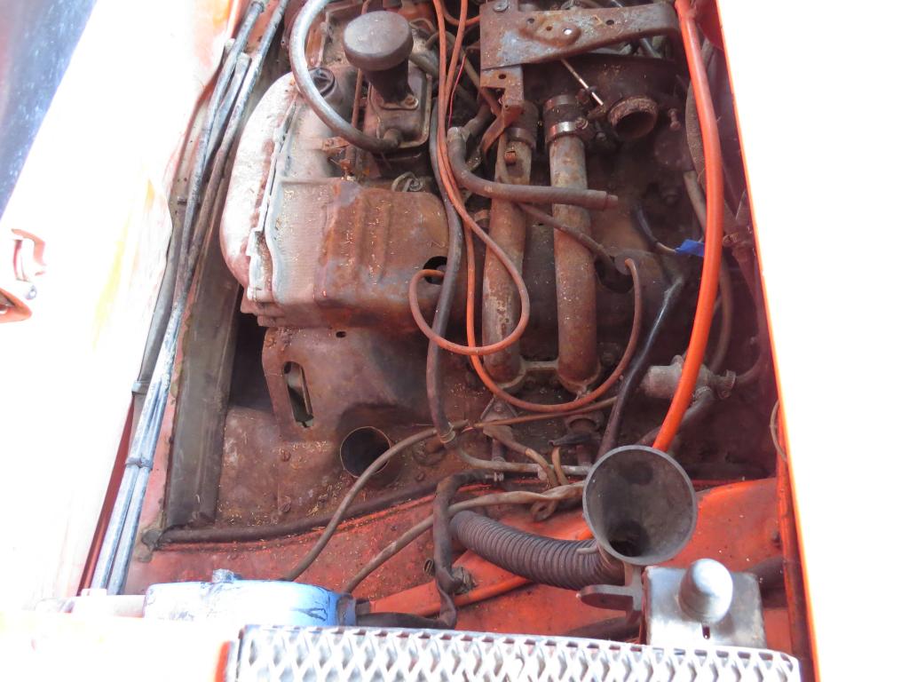

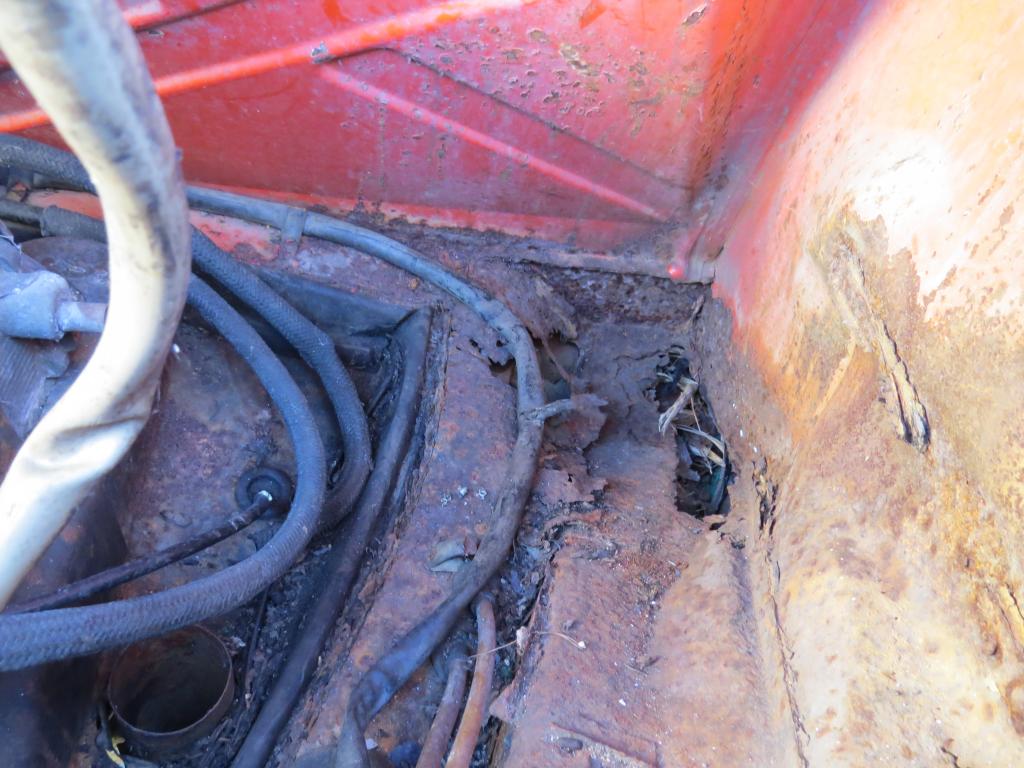

I've got a 1971 914-4 with the 1.7 in need of restoration. The body has some minor dents, typical rust not severe but needs work. Looks to be the original engine and transmission. Most of the parts are there, though corroded.
Manufactured 10/70
vin 4712904015
4259606 L21E Tangerine
engine W018107x
I would like to make it a Porscheru with the WRX 2.0 Turbo and Subaru transmission wiring harness and ecu. But, I have misgivings about transforming a car that could also be restored to the original. Let's say I would like to stay around $5,000 (maybe I'm dreaming here), first do the metal repairs and paint, then drop in the Subaru engine. Similar to Orange 75 Project, engine is in...
I am looking for a little better performance and I'm not sure the original 80 hp engine with a lot of work involved is the answer.
So, for the return on investment, is it worth doing a restoration, or as my wife says, "do what you want to do with the car"- that would be the Porscheru.
Restore or Suberize?
