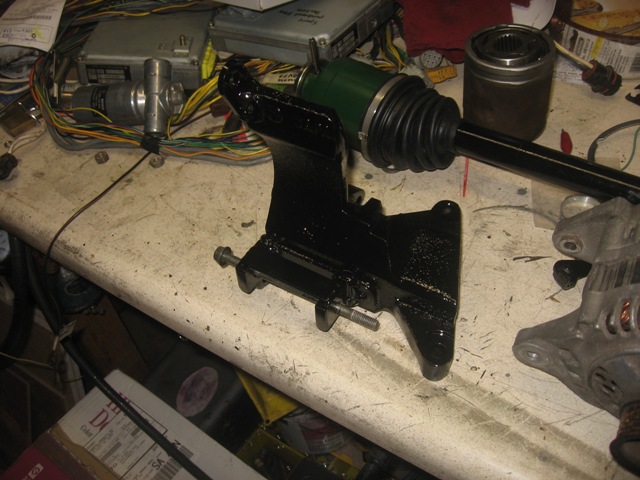

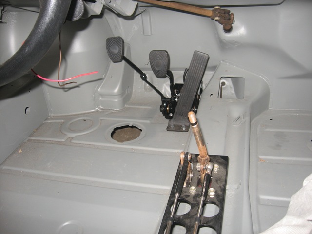

Been a while, and life's been in the way too much lately. But I've been able to work on a few things...

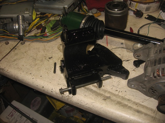

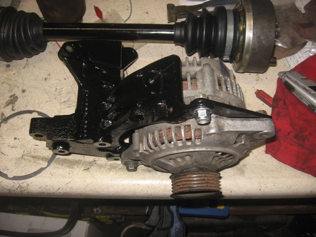

Below are some pics of the Suby Alternator/AC compressor mount that I modified to move the alternator toward the driver's side of the motor to allow 180 degree rotation of the intake manifold. I welded on ears to mount the alternator, and the belt lined up with the outer grooves on the crank pulley. Even though I hacked off a bunch of metal from this mount, it is still really heavy -- but it looks nicer after I powdercoated it and it should be rock solid.
I also rebuilt and powdercoated a spare pedal set. Here it is mounted alongside the new gas pedal from Mikey914. You can also see the powedercoated (but dusty) mount I built to raise the MR2 shifter.
The 911 axles that were shortened and resplined on one end by Dutchman Axles are in. You can see one of them on the workbench in the pictures above; they're comprised of cleaned/repacked 108mm 911 outer CVs and cleaned/repacked Suby Legacy Turbo inner CVs. I'll take a picture of the axles and post it here later. The SS fuel line from Tangerine are also in, and the modified fuel tank is mocked up, too. I hope to install the alternator, oil pump, water pump and cam belt/tensioners tomorrow. I'll then mock up the water hoses and finish up the fuel system in the coming days.

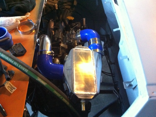

Haven't had time to update this thread in a while, but I have been squeezing in some time here and there. Also, my family gave me most of day in the garage today for Father's Day!

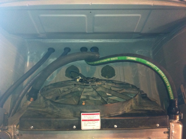

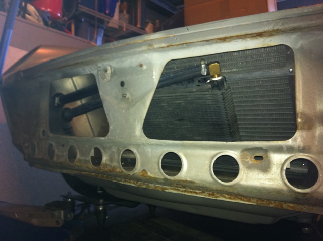

I found that the Vortech water-air intercooler won't work without some crazy hose routing, so I bought a Type 13 water-air intercooler from FrozenBoost as well as some aluminum tubing, silicone hoses & reducers, and t-bolt clamps. In all, that stuff ran about $275. Below is a picture of this work-in-progress. There's just enough room underneath for the air intake/MAF routing, but it is tight. I'll be running a plastic radiator fill-cap system from a Kawasaki Ninja 250 (it has 3/4" hose bibs to match my intercooler coolant system), as well as an electric Bosch water heater recirculation pump from a 5-Series or 7-Series BMW. If you pick one of these up, tell them it is a Heater Control Valve and you'll get it for less than $10; I picked up four of them over the past couple months to have spares.
I also finished up the front routing of the coolant hoses and IC hoses to the front of the car. I'm using 1.25" wired hardwall rubber Marine Exhaust hose to bring the chilled coolant from the radiator back to the engine, and 1" diameter to run the hot H2O from the engine to the radiator. It is a very tight squeeze to get the hoses over the top of the front aluminum suspension and under the steering rack (especially for the larger 1.25" hose), but this arrangement really maximizes ground clearance IMHO. As you'll see in the pic below, all of the hoses go through holes I cut in the front firewall. I picked up heavy-duty grommets online from Fastenal.
I'm using Gates 3/4" heater hose to/from the front-mounted heat exchanger and the IC. You'll see the routing in the picture below. You'll note that I haven't removed the rust and epoxy painted the front of the car yet; that area (and the rear of the car) were obscured by the rotisserie mounting bars. Something that is on my list of things to do...

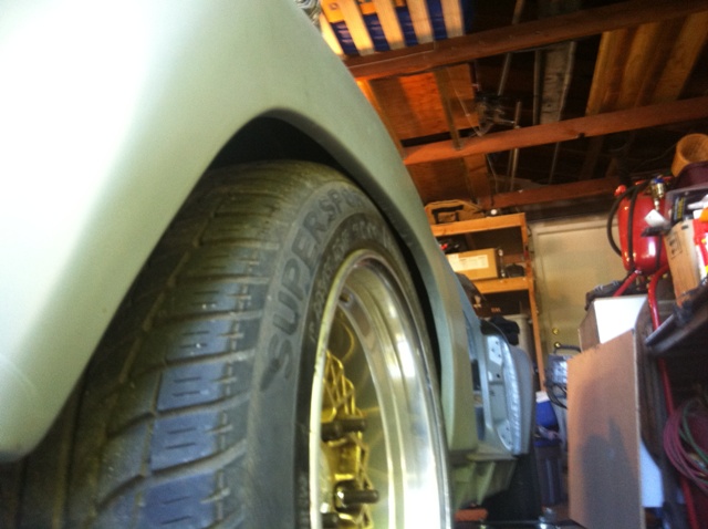

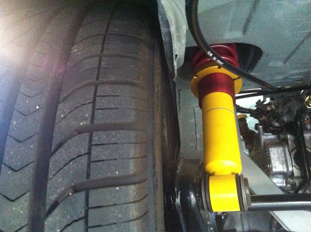

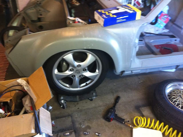

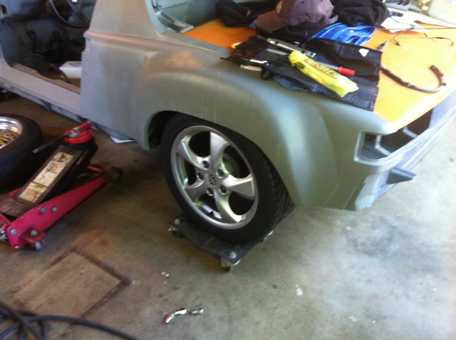

My good buddy's family took off for LegoLand in San Diego for week, but he didn't want to leave the keys to his Boxster in the house for his 18 y.o. daughter to do dumb things with (IMG:style_emoticons/default/blink.gif) So he told her he gave me the keys to do some maintenance on it (IMG:style_emoticons/default/piratenanner.gif)
I wanted to see how his 17" wheels would fit and look on my car, so I took some time to investigate. The fronts are 205-50-17 on 17"x7" wheels with ET of 55. The rears are 255-40-17 on 17"x8.5" wheels with ET of 48. My wheels are BBS three-piecers in 16"x7" and 16"x9" with 205-50-16 and 225-50-16 (junk) tires. The Boxster wheel/tire combos are 39/46 lbs (F/R), while the BBS combos are 32/36 lbs. The diameters of the Boxster wheels are 25"/24.5" (F/R), while the BBS are 24"/24.5".
Below are some pics. First is my BBS rear tire/wheel, showing how little clearance exists between the tire and the flare lip. No spacers are used with my BBS wheels, nor is the alignment likely to be close to good. But there is a LOT of clearance between the tire and inner fender well -- on the order of 1" on the driver side and 1-3/8" on the passenger side.
Next up is the rear Boxster wheel mounted, followed by a pic of the rear inner clearance. All of the Boxster wheels were mounted using factory Porsche 944 spacers, which are about 3/4" thick.
Obviously, the tire to inner fender well clearance is too tight -- I cannot even fit my pinkie finger up there. No camber shims are mounted up right now, so camber is maximized.
Finally, here is the Boxster front wheel mounted up (again, with a 3/4" spacer) -- which is about perfect in terms of clearance with these wheels.
As you all know, it is getting harder and harder to find good 16" performance tires (much less period correct 15" tires). So I might look for some Boxster wheels and try to sell my BBS rims to a 930 enthusiast. What do you guys think?

I wonder how well the frozen boost heat exchanger and fan would if you put it in the rear of the car. I was thinking about a canister style muffler on one side and the heat exchanger on the other side. I can't imagine it would be any worse than the air to air intercooler.
Why did you turn the intake manifold? Just for ease of plumbing? I have the renegade mount, but want to avoid using their intercooler mess (there must be 6 feet of piping).
I also have a hot rod air system that I plan on installing. I think the intercooler heat exchanger, condenser and radiator in that little space might over-do it.

QUOTE(pktzygt @ Jun 22 2011, 12:46 PM) *
Not sure about the heat exchanger in the engine compartment; I'd imagine you'd have to use auxiliary fans to cool it. Interesting idea, though. With that setup, I wonder if you'd take up so much "high" real estate in the engine compartment with the air/water intercooler and heat exchanger that it'd be a bear to get to any upper engine components from the top / engine lid. But I like the way you're thinking...
Yes, I turned the intake around for ease of plumbing. In hindsight, it definitely would've been easier to cut into the rear trunk... but I'm already losing so much of the front trunk with the radiator and hoses that I wanted to have some semblance of storage space in the rear trunk.
I might try to put A/C in my car someday, as it gets HOT here in the CA Central Valley. At this point, however, I'm just trying to get my car ready to roll on its own!!
