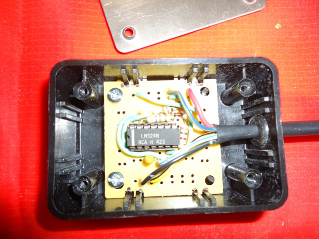

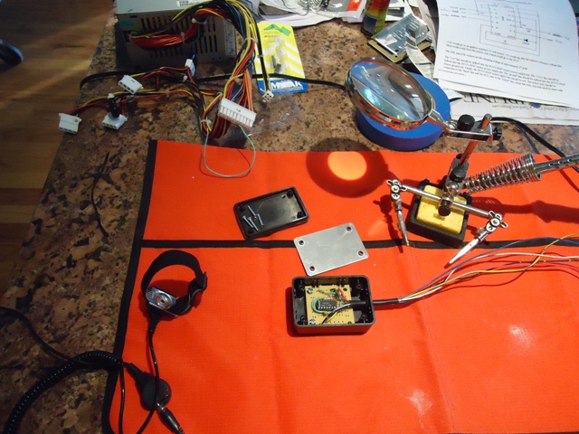

One other item that I finally finished up is a homebrew Fuel Cut Defencer. The stock Subaru ECU cuts the fuel at ~12 psi of turbo boost. Since I'm running an HKS electronic boost controller, I don't want the ECU to shut down the fuel when I crank up the boost -- instant piston meltdown. Basically, this system tricks the ECU into thinking the boost -- and therefore the maximum 5V signal from the sensor -- is at an acceptable level. Some call it a clamp, and it is mounted between the boost sensor and the ECU. Either way, I've got about $10 in this setup, saved myself about $75 and got to play with more electronic stuff.
