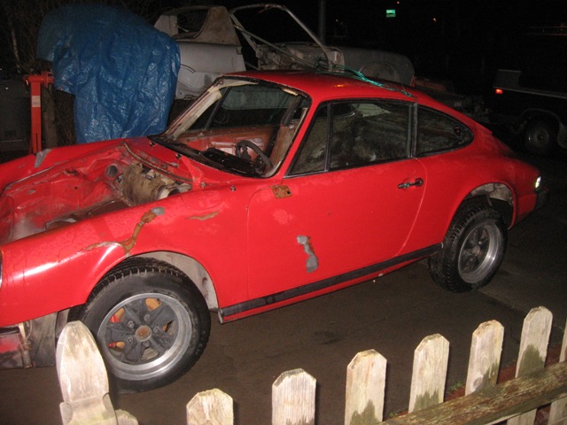

This is my second post, but I've been lurking on this fine website for a while now. I've wanted a 914 since I was in high school, but always seemed to stumble upon other projects... until recently.

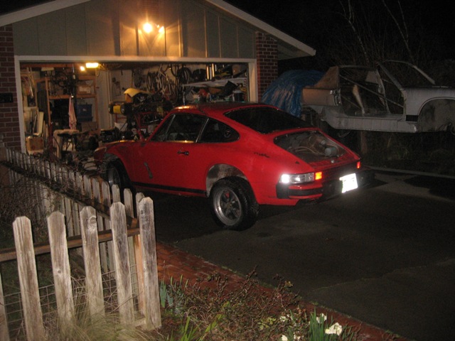

My neighbor gave me this 1973 Porsche 914 about a month ago. He told me he blew a head gasket and parked it in his parents' driveway in 1992. When his parents finally told him to move it or they were calling a local junkyard, he offered it to me since he knows I'm a gearhead. In for a penny, in for a pound...

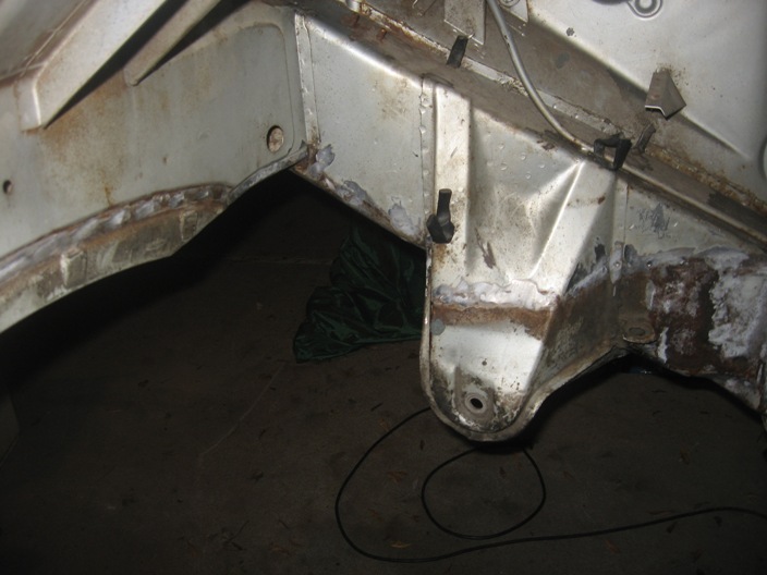

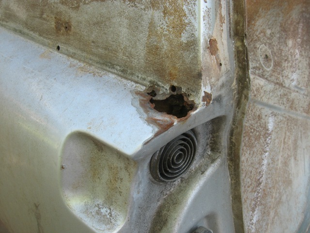

I hauled it home, knowing that it has some rust issues in the battery area and rear trunk. But it appears to have never been in a wreck and it is complete. It turns out that an exhaust stud pulled, so he coulda fixed it for a couple hundred and probably kept another 914 from languishing but I guess all things happen for a reason (namely, so I would undertake this project!).

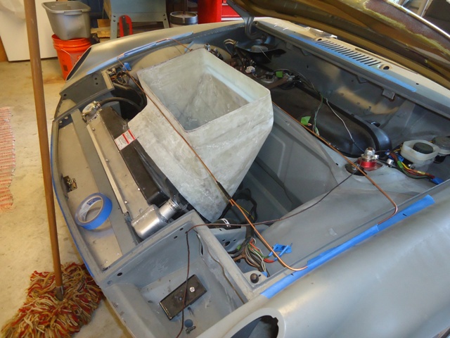

I sold the engine to a local Craigslister for use in his Meyers Manx dune buggy, and bought a wrecked but running 1993 Subaru Legacy turbo wagon. This is the closed-deck 2.2 liter engine, and 250 hp is easy with boost control and an open exhaust. I've already done a Subaru into a VW Vanagon and my daily driver is a 1992 Suby Legacy, so this won't be too much of a stretch for me. I plan to use the Suby 5-speed transmission (out of a 1998 Suby Forester) with the Aussie-sourced RWD elimination coupler and custom-mated 914/Suby axles.
I've got a suburban home with a crowded two-car garage (my 125 shifter kart and my daughter's FJA kart will likely get lonely!), a MIG welder, and a wide assortment of air/power/hand tools -- so the adventure begins! This project will likely take a year to finish, so please be patient.

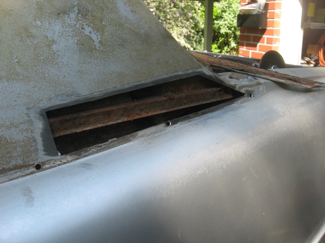

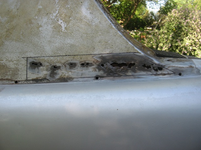

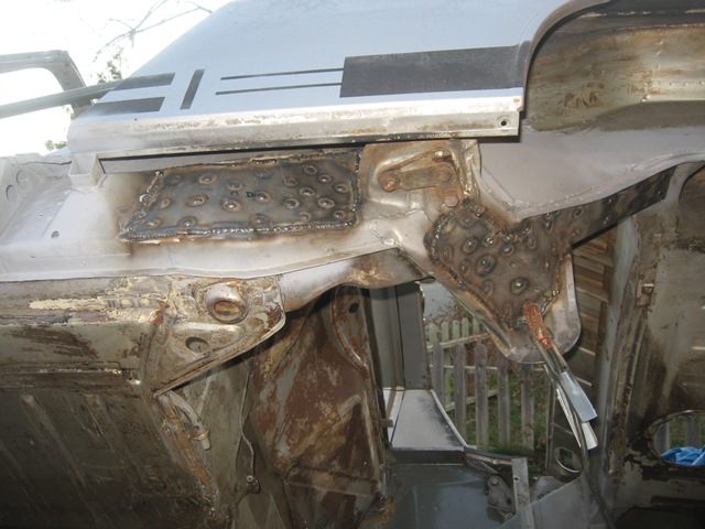

I've attached some pics of the car as found in the driveway, some rust areas and the rear trunk repairs I've started. I'll chronicle the build as I go, so feel free to chime in!

strawman   More pics of the rust in/around the battery tray a...   Apr 18 2008, 12:25 AM

strawman   Here are some pics of windshield/cowl area that...   Apr 18 2008, 12:33 AM

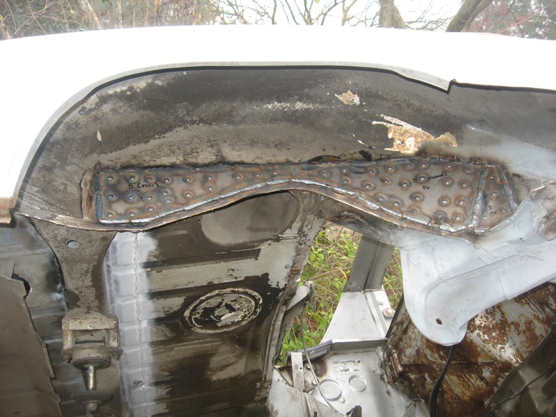

strawman   Okay, here are some pics of the rear trunk area. I...   Apr 18 2008, 12:41 AM
strawman   More trunk pics...   Apr 18 2008, 12:45 AM
strawman   More...   Apr 18 2008, 12:46 AM
strawman   And some more, with the AA trunk pan mocked up...   Apr 18 2008, 12:49 AM

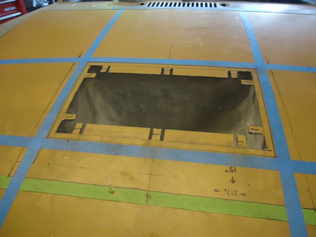

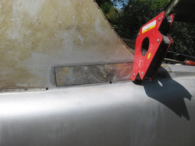

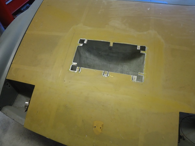

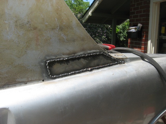

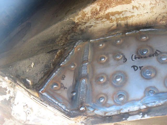

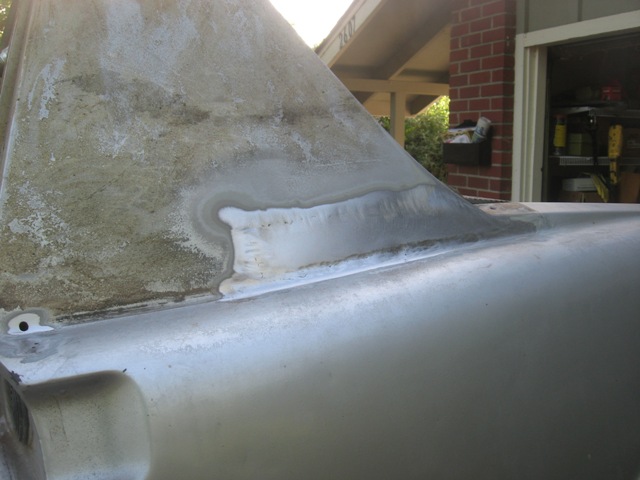

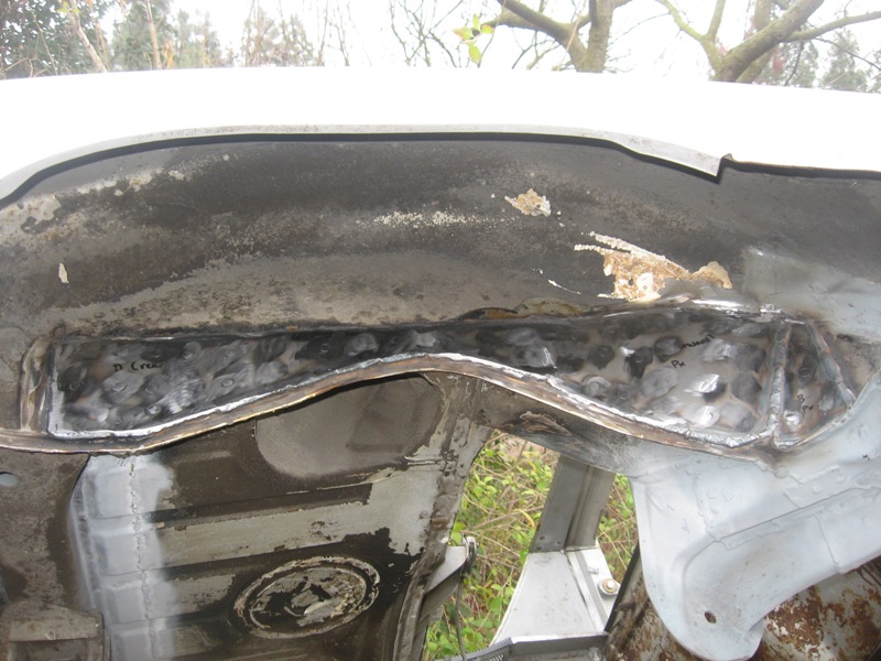

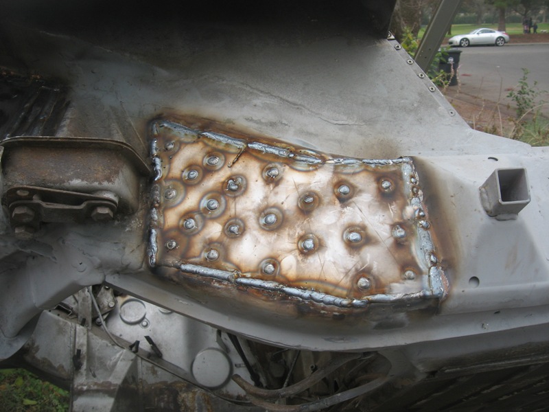

strawman   It has been a while since I last posted, but I hav...   Aug 16 2008, 09:40 PM

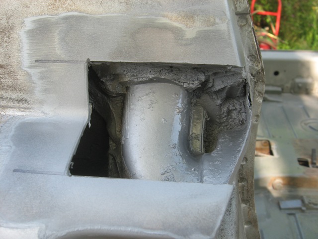

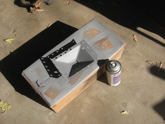

strawman   Next up is a pic of the patch piece, made of 16 ga...   Aug 16 2008, 09:59 PM
strawman   Here is a pic of lower patch piece, made of 18 ga....   Aug 16 2008, 10:25 PM

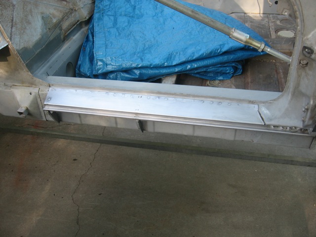

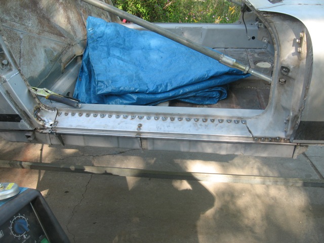

strawman   Been a while since my last post, but I've made...   Nov 16 2008, 11:16 PM
strawman   Next up are some other pics of the passenger side ...   Nov 16 2008, 11:21 PM
strawman   I sandblasted the entire inner long to get down to...   Nov 16 2008, 11:34 PM

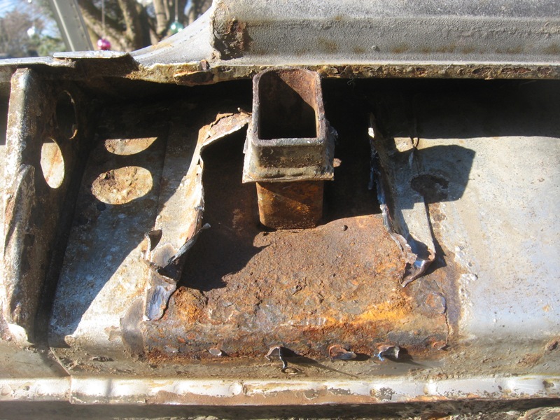

strawman   Next up is a pic of the jack post, followed by the...   Nov 16 2008, 11:53 PM

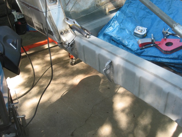

strawman   Had all of last week off work, but we had family i...   Dec 2 2008, 11:32 PM
strawman   On Sunday, I finished up welding in the rear trunk...   Dec 3 2008, 12:13 AM

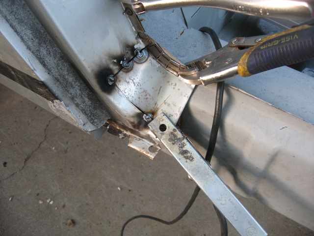

strawman   Been a while since I posted, and work/family has g...   Jan 10 2009, 10:38 PM
strawman   Here's some pics of the driver's side. As ...   Jan 10 2009, 10:47 PM
strawman   Finally, here's some of the trailing arm stiff...   Jan 10 2009, 11:02 PM

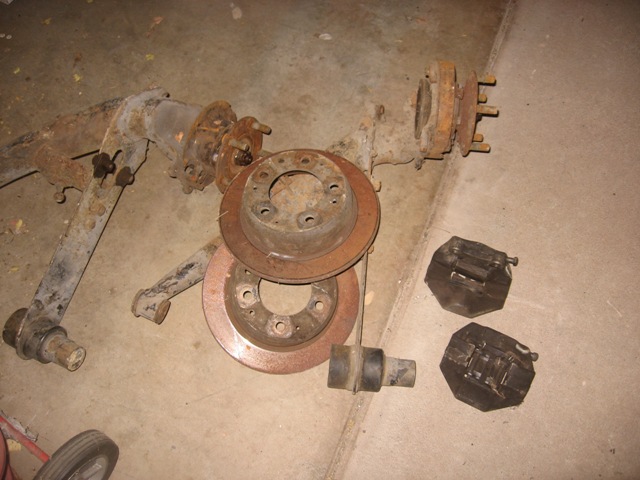

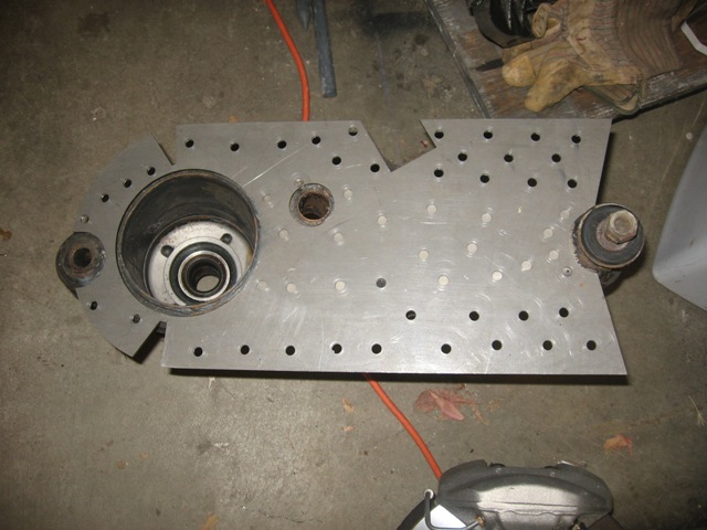

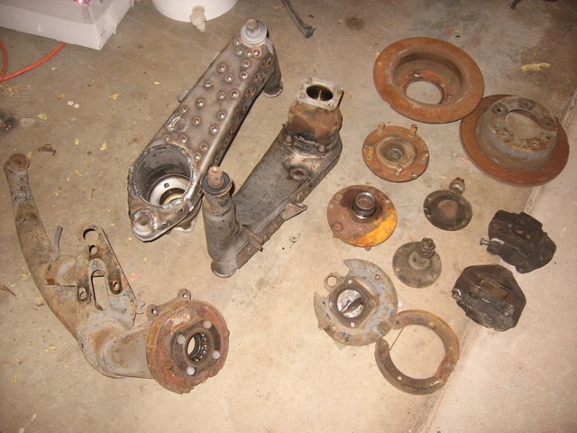

strawman   I bought a 1969 911 rear suspension/brake system t...   Jan 25 2009, 10:54 PM
strawman   I picked up a 1976 911 roller for parts a couple o...   Feb 18 2009, 11:04 AM

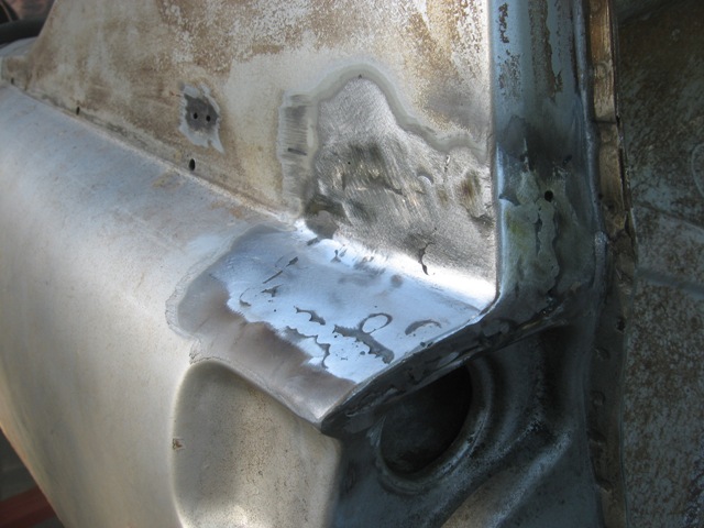

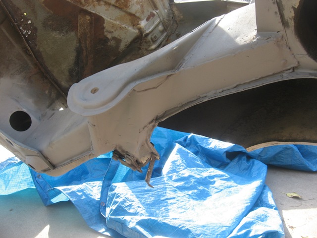

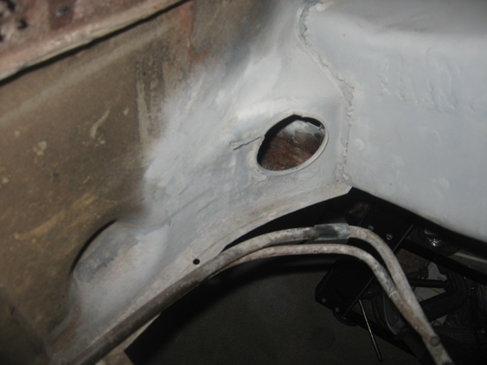

strawman   I knew there was a mess under the passenger side s...   Apr 26 2009, 10:30 PM
strawman   The forward/lower area of the passenger side quart...   Apr 26 2009, 10:48 PM

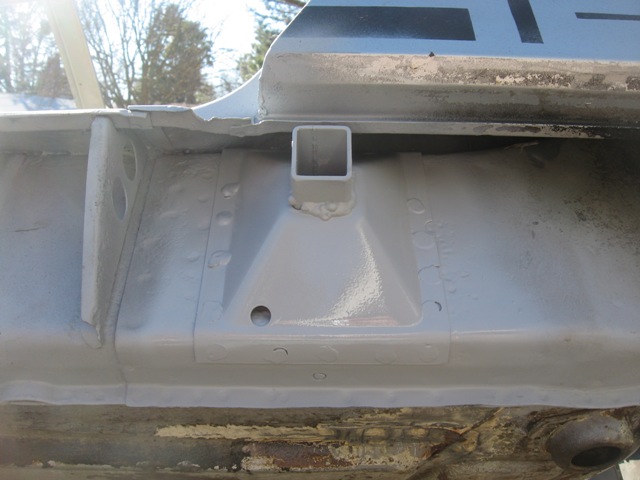

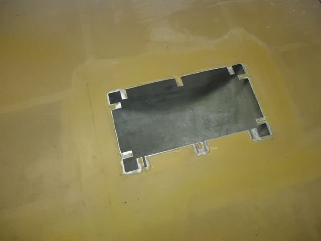

strawman   I finally got around to finishing the rear trunk r...   Oct 22 2009, 01:12 AM

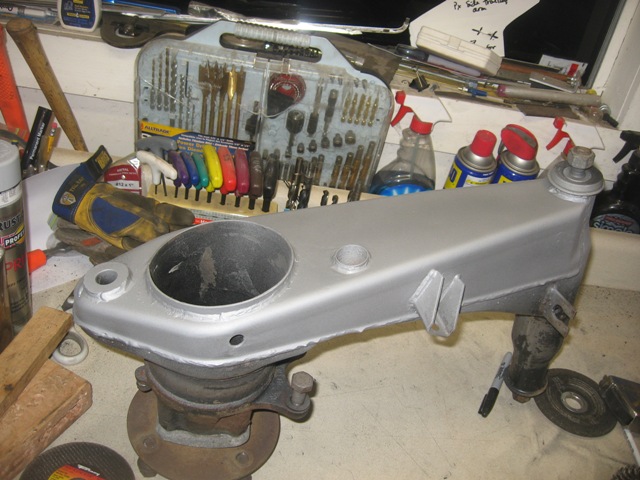

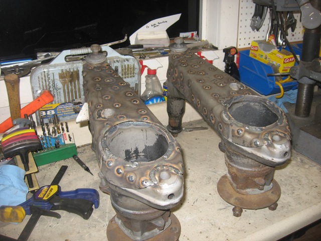

strawman   Finally took some pics of my modified trailing arm...   Oct 24 2009, 12:35 AM
