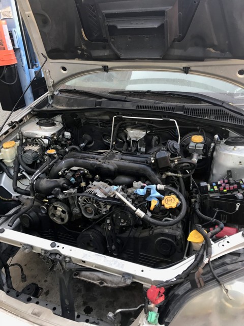

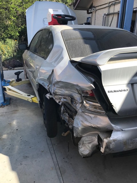

As mentioned in post #372 above, I bought a wrecked 2005 Subaru Legacy GT. I paid for $1,000 plus $100 to have it delivered to my house (on Saturday morning). It came with receipts showing a new turbo, water pump, timing belt and related tensioners in the last 2k miles. This is not quite the highly-sought after EJ257 out of an Impreza WRX STi, but it has 250hp from the factory and it is relatively easy to increase power through either an e-tuner (Cobb AccessPort, for example) or through a specialty shop with a dyno. Below is a picture of the damage to the car; the rear suspension was torn to shreds, but the car still drove up my driveway and into my work bay. It revs freely, has no check engine codes, and I let it idle until the radiator fans kicked-in. It shows oil drippage from one of the valve covers, but otherwise there was no drama.

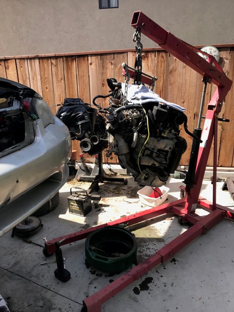

I spent the weekend tearing it apart, and putting away the parts I will need to swap this EJ255 engine into my 914. I plan to adapt the gauge cluster (replacing the 1998 Forester cluster I'm currently using) into a new dash pod, the drive-by-wire accelerator pedal, and I'll see if I can adapt the tilt-steering column and related factory parts (leather Momo wheel, headlight/turn signal stalk, cruise control, etc.). Obviously, the airbag won't be functional. I kept a portion of the Legacy's dash top to help mock up the dash pod, and I pulled the entire wiring harness (except for the wires behind the b-pillars). What a PITA!
I plan to adapt my current air-to-water intercooler setup, flywheel/clutch, Accusump, cast aluminum oil pan, and the exhaust from my current EJ22t engine. I'll keep the EJ255's rear inlet orientation so that I can run an A/C compressor (more on that later) and alternator in the factory EJ255 locations; I'll toss the power steering pump. If you'll remember from a previous post, I had to flip the intake on the EJ22t to avoid cutting into the rear trunk/engine firewall -- but the EJ255's intake is much more compact. Below are a couple of pics.
I then paid $150 to have it hauled away yesterday, although I filled it with all the car-related junk I've collected over the past six years from my various other engine swap projects (BMW S52 into 318ti, VW tdi into Eurovan, etc.) and other car rebuilds -- so it was money well-spent. I resisted the urge to salvage every last part from the Legacy GT that I could possibly sell on eBay or Craigslist -- that is becoming such a PITA lately that I just took what I needed, or that could be quickly/easily sold (5EAT transaxle, rear differential, climate control/radio pod, battery, one unbroken headlight). I also grabbed the under-wing 3rd brake light to see if it can be adapted to my 914.
Over the next couple of months, my plan is to replace all gaskets, seals and hoses on the engine while I continue to hammer the car at autocrosses and possible Buttonwillow track days to see what else can break. I'll also dig into the wiring harness; this time I plan to mount the ECU in the cabin rather than the rear trunk. Then I'll prep it for paint, test fit the new EJ255 engine, pull everything off the chassis and paint it. Stay tuned!

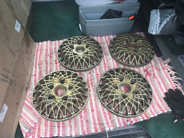

One more picture: these are the wheel centers from my BBS Motorsports E52 wheels. Central Coast Powdercoating is charging me $200 to blast these and coat in Gloss Black. Replacement hardware is coming (from McMaster-Carr), so my hope is to re-polish the lips/barrels, assemble the wheels and have 'em back together before the next autocross on June 16.

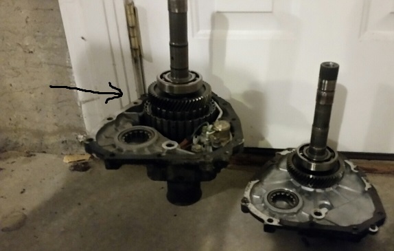

QUOTE(Mueller @ May 14 2018, 11:57 AM) *
Still waiting for someone to do a Subaru motor and auto gearbox in a teener! Can they be abused a little without blowing up?

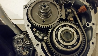

This would be cool. The biggest problem may be the electronics -- both the 4EAT and the five-speed 5EAT have a separate Transmission Control Unit that likely needs to communicate with the ECU. There is at least one company that builds 5EATs and related equipment to take abuse in the relatively heavy and higher-boosted Legacy GT/XT and Forester XT.
If I cannot sell the 5EAT that came out of my car in the next few weeks, I'll open it up (in the name of science, of course!) and see if it is possible to lock the FWD and RWD together. I'll also check to see what sensors are in each end.

QUOTE(Chris H. @ May 22 2018, 04:12 PM) *
In a stock Subaru with a 4EAT there is a fuse you can pull that puts the trans in front wheel drive mode.
There is Chris but all it does is disable the electric clutch that engages the driveshaft to the rear. It still doesn't get rid of the long tailshaft needed to couple the rear shaft so that's why I picked up the 2wd endplate and shaft/bearing assembly - drops right in.
[/quote]
Pull the tailshaft off the 5EAT and you'll see the electromagnetic clutch assy. You should be able to take the endplate and shaft assy from a 2wd and drop it right in - there's no way to lock up the automatic like there is the manual that I'm aware of. Check out the size of the electric clutch assy and necessary tailshaft...

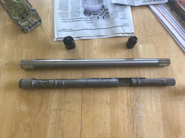

Below is a picture of one of the pair of gleaming new Dutchman axles shafts, sitting next to the mock-up. You can see that they tapered it down from the Porsche 911 outer CV spline to the smaller Subaru inner tripod joint spline. All told, with shipping of my parts to Dutchman, the cost of the axles and shipping back to me, it cost just under $700. The Hy-Tuf material is some sort of space-age, high-strength and low-alloy steel used for aircraft landing gear. So the axles are likely not the weak-point anymore. I hope to get the car back on the road this weekend. I also need to assemble my BBS Motorsports wheels now that I've got the centers back from Central Coast Powdercoating. More pics to follow soon!

Member No.: 7,958
those axles look real nice. I don't dee how anything will break now. A long time ago I corresponded with a well known tranny guy that was on nasioc a lot, and he thought the light weight of the 914 and the smaller tire footprint would sorta protect the 5spd 05 up manual tranny in this application. course if a person really tries to tear something up in a car he can usually manage that feat.

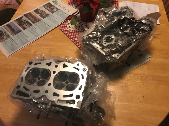

Well, I forgot to take pics of the heads before packing them and shipping them off to OutFront. But here they are all rebuilt-n-shiny as received back yesterday. OutFront shaved the heads two-thousandths to ensure they are perfectly flat, ground the valves/seats, installed new valve guides (extra $$), set the valve lash, and leak-tested them. With shipping and tax, I paid $823 not counting the $46 to ship 'em to OutFront last week.
This weekend I'll chase the threads in the block, install the new ARP head studs, place the OEM head gaskets, and torque these heads on. That will make my wife happy, since she doesn't quite appreciate "art" on the kitchen table like I do...
On other fronts, it turns out the SmallCar cast aluminum oil pan interferes with the stock "oil cooler" that is sandwiched between the block and the oil filter. Actually, after some research I found that this is a misnomer, because it is actually an oil warmer to quicken the clean-emissions warm-up time. So I removed it; the factory eliminated it in MY2007, too. To eliminate it, I purchased a factory plug to block-off the coolant passage in the block (P/N 11021AA121), bought a shorter threaded pipe to mount the oil filter directly to the block (P/N 15018AA050), and muscled the coolant pipe out of the water pump and tapped it for a 1/4" NPT stainless plug. That'll save about three pounds and also eliminated three small molded rubber hoses.
The bummer is that I stripped the M6-1.0 threads in the block for one of the oil-pan bolts... so I'll pick up a Heli-Coil kit today and fix it tonight. Thank gawd the engine is still on the stand!
