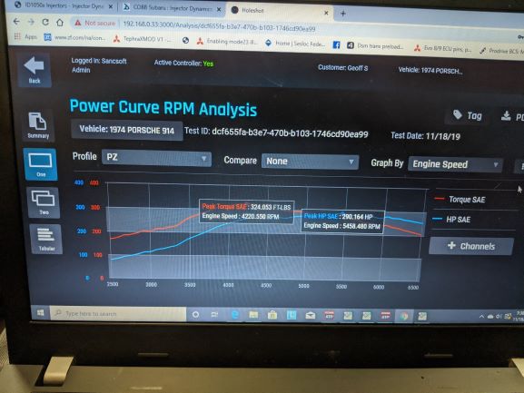

It still had some hiccups (poor throttle tip-in, hunting idle, etc.) during my first two drives so I took it to Pokrajac Tuning yesterday. I provided the ECU logs of these first ~10 miles help Mike with the initial tune. I had the chance to watch him with my car on his Mustang dyno, his earmuffs on and his laptop sitting on his lap -- secretly scared that he'd pop the engine. But he conservatively tweaked the tune over the next 60 minutes. My first pull was 250.10 ft/lbs and 242.12 HP. As shown the attached, he tweaked it to 324.40 ft/lbs and 290.69 HP at 18psi. He also provided two more conservative tunes on my COBB AccessPort: 1) wastegate/spring pressure, and 2) 15psi.
I picked it up during lunch today, and wow does it run like a scalded cat. I plan to drive it over the next couple of days to look for weaknesses, and to hammer it at the last PCA autocross of the year on Saturday in Santa Maria, CA. I'm running it on straight gas for now, but will wire in the new COBB flex-fuel module in the coming weeks. Of course, do I REALLY need more power? (IMG:style_emoticons/default/aktion035.gif)

325lbs of torque is MOVING!
Did the tuner tune with any E85 in the system?
Congrats on getting it running!

Thanks Andy for your kind words. The current tune doesn't include E85, but it is apparently pretty easy for Mike to add using his COBB AccessPro software setup. The fuel pump, lines and injectors were sized/installed with E85 in mind. The COBB flex-fuel module will automatically adjust the tune based on the percentage in "corn" in the fuel. I also installed a petcock on the bottom of the fuel tank to easily empty the E85, since it apparently gets "stale" pretty quickly if it sits. I merely need to replace the COBB flex-fuel module when it arrives next week and then pay Mike to put it back on the dyno for final scaling.

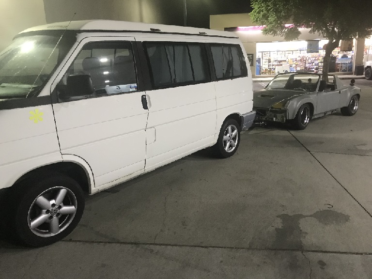

A pre-autocross pic of my 914 behind its TDI-swapped tow rig. I’ll provide an update after the race today.

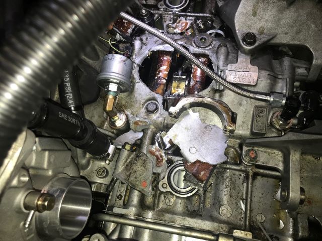

Well, that was short-lived! The first four runs were an absolute blast, with oodles of torque and instant acceleration. I experienced no flat-spots or other untoward tuning issues; it is a BEAST! Even the guy in the GT2-RS came over to see "what the heck you got in there?" In fact, I broke the tires loose in third gear (albeit on relatively cold tires) on a straightaway.
However, while in queue for my fifth run my oil pressure started to drop (30psi at idle, and only went up to 60psi at 3k rpm). Like an idiot, I didn't park it and decided to hammer it anyway. About halfway through the run, I heard the distinct sound of rod knock and then quickly a loud bang... followed by lots of steam. I immediately pushed in the clutch and drove through a wall of cones to get off the track ASAP. Once we verified it was not on fire, I found the motor was locked-up. So much for my junkyard motor...
I haven't done the post-mortem yet (I've been busy helping with another 24 Hours of Lemons), but it appears that I threw a rod through the top of the block and punctured the cast aluminum coolant crossover tube. Hence the steam mentioned above. I won't be able to spend any time with the car for a couple of weeks, but I've already ordered a new IAG Stage 2 short-block with a couple of upgrades. It includes a new Subaru case, 2017+ STI nitrided forged crank, forged rods and forged oversized slippery-skirt pistons, as well as an IAG windage tray. Hopefully my recently-rebuilt heads aren't borked, but I won't know until I tear it down. I'll send my BNR turbo in for inspection to make sure metal bits didn't get past the custom turbo filter (which, if full, could've starved it for oil!).
I learned a couple of things: 1) Duh, I really shoulda parked it when the oil pressure dropped, and 2) I need more traction. I will install an electronic oil pressure sensor that will pull timing/limit boost if it drops below a PSI threshold, and I plan to widen the rear flares to get more rubber in the back.

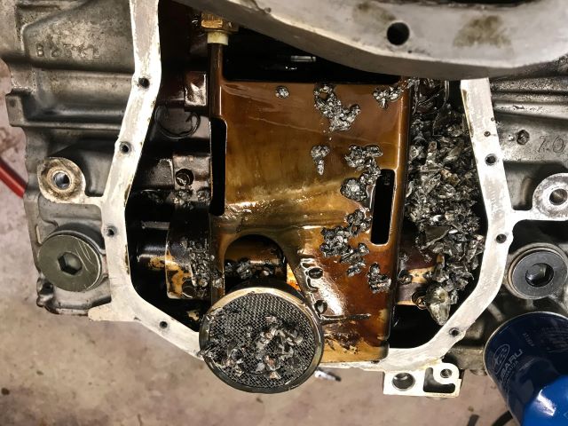

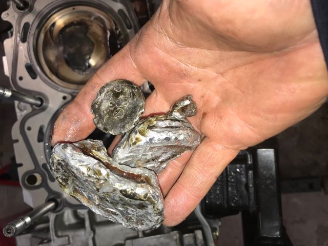

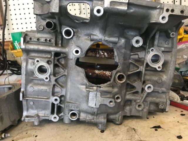

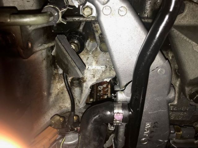

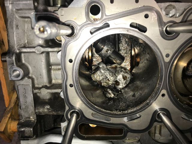

As mentioned earlier, I heard a loud BANG at (according to my datalog) 5,130 rpms and then steam poured out of the engine bay. The car sat for a few weeks while I ordered the new shortblock and other parts in preparation for a new heart.
After removing the intake manifold I began to see what actually happened. As you can see in the first pic, the aluminum coolant crossover tube is cracked and you can barely see the hole in the top of the block.
Here's a pic with the crossover removed; you can see the "custom venting" and several metal pieces laying about.

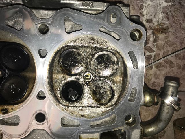

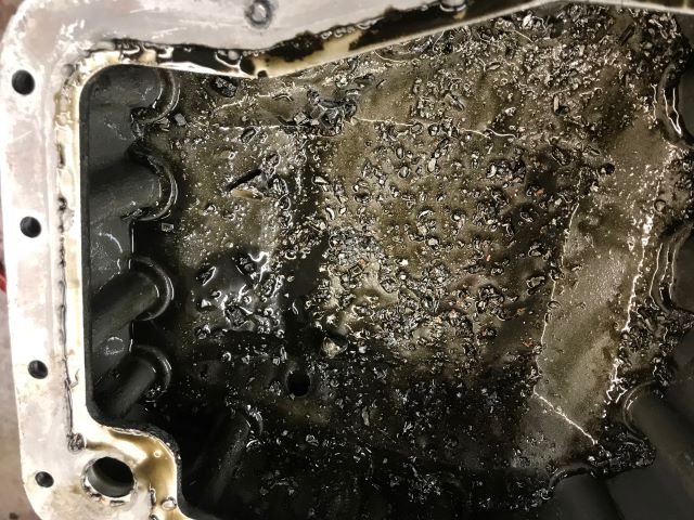

I pulled the drivetrain and placed the engine on a stand to begin the real tear-down. This is where you can see the real ugliness: that's what remained of the piston and one of the valve heads, and the upper half of the connecting rod sat at a weird angle. Check out the cylinder scoring, too.
Remember me talking about my totally rebuilt heads? Obviously, this head is beyond (feasible) repair.
Here's more carnage:
I don't have a pic of the turbo, but the hot-side impeller was damaged by all the metal pieces that shot through it. The intake was full of oil and small metal pieces, as were the cast iron exhaust manifolds. My brand new 11mm oil pump was surely damaged, too. Yuck.
So I sent the turbo back to BNR Supercars for a rebuild, and the 3-quart oil reservoir back to Accusump for a cleanout and reseal. I found a pair of used heads on Craigslist (after I had to send an Ebay pair back because the damage was not accurately described!). The heads I ended up using needed new exhaust valves, so I upgraded the springs throughout as part of the rebuild.
For grins-n-giggles, I separated the block to see more carnage. Obviously, the rod bearings were gonzo and the crank is junk. In my next post, I'll share the custom baffling I installed in the new block and in the oil pan -- and the hole in the now-empty block helped in devising the baffling solution.

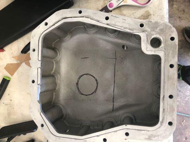

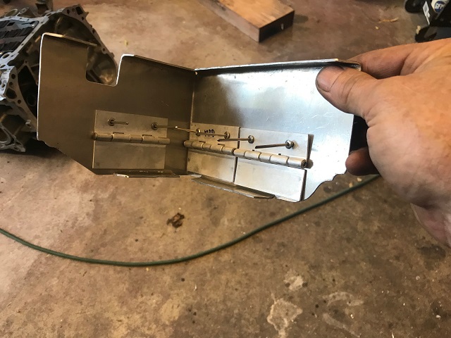

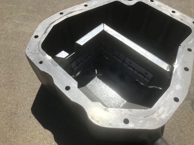

Obviously, the old engine was starved of oil so I worked with my tuner to prevent a similar fate for the new engine. Although my COBB AccessTuner can display oil pressure and log it, there is no shut-down like we have on the buses here at work. COBB says they're working on something to at least sound an alarm, but it looks like I'll need to closely monitor it. Speaking of oil, the Smallcar cast aluminum pan is great for providing additional clearance while only giving up 1/2 quart of oil, but there is zero baffling inside. Further, the modified Smallcar oil pickup is suspended (no bracing) and it sits near the front of the engine -- so all the oil rushes to the back of the pan under acceleration. Did I mention this thing is a rocket under boost? Yeah, that ain't gonna do...

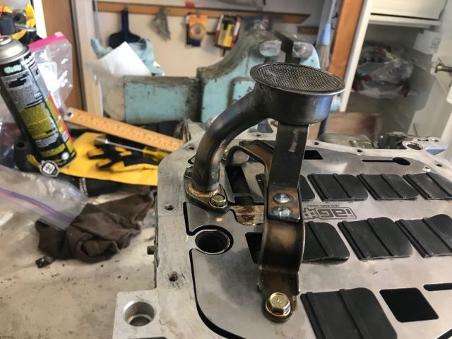

After cleaning everything up, I bolted the oil pick-up and pan to the bare "vented" block. Through the hole, I could easily trace the outline of the pick-up onto the floor of the pan through the block, which helped me figure out how to best baffle it.

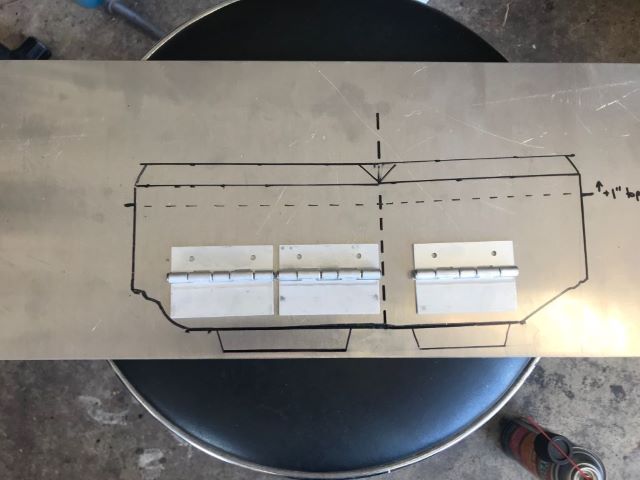

I bought a set of aluminum flapper baffles from Summit, which I installed in the custom-fit "can" around the pick-up. Below are pics of the mock-up and then as welded-in. As you see, I used flanges at the bottom to help with TIG welding, since I knew it'd be a challenge to mate the aluminum sheet and relatively porous cast pan. The flanges at the top provide some rigidity. I used SS rivets to secure the flappers to the walls of the "can." The holes behind the hinged section are barely smaller than the flap itself, so it flows well back into the can while returning oil constantly fills it.
The welds ain't pretty, but I filled it with water and frantically ran figure-8s around my driveway to make sure the fluid will stay inside of and return to the can (I'm surprised my neighbors didn't call for the guys in white lab coats!). Not very scientific, but I hope it'll work and save the considerable investment that I have into my new engine setup.
Finally, I wanted to shore up the Smallcar shortened oil pump pick-up; even the factory one has a bolted-on brace. So I bent up some scrap steel, cut-off the upper portion from the factory brace and welded it together. I then mocked up a rig to test for air leaks using old radiator hoses and clamps, some PVC caps, and pressurized it under water. It is tight! You can also see the IAG windage tray, which helps keep the oil in the pan and away from the rotating assembly.

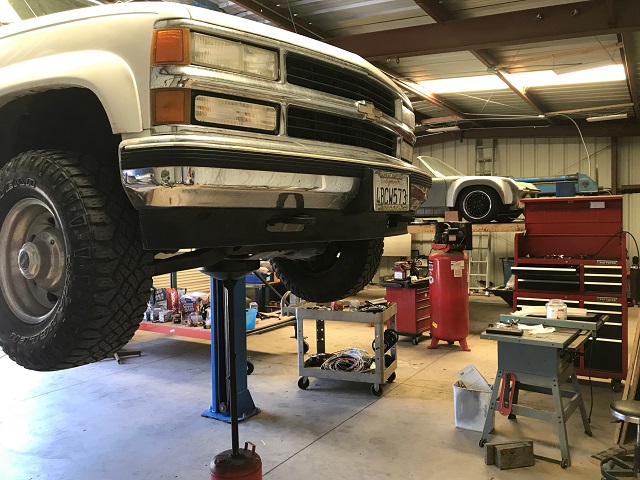

Final pic is of my new shop. Yup -- I have an old Benwil 12k lbs. 4-post lift, an Atlas 9k 2-post lift, and a shi**er in the corner. So far, I've installed twelve 17.7K-lumen LED lights (bright as WalMart!), wired up 38 pairs of 20-amp 110V plugs throughout, and three 30-amp 220V plugs for my MIG welder (each lift has one). Still need to wire in a 50-amp for my TIG, but I'm waiting for a new/larger panel that will be installed as part of the solar system in the next few weeks. The compressor will be installed under the lean-to. I bought a bunch of old pallet racking and an old Cat V50D forklift to help move-n-store big stuff. I still need to install the workbenches and small-stuff shelving. One small corner is reserved for my wife's lapidary stuff; maybe we'll spend more time together now? (IMG:style_emoticons/default/confused24.gif)
