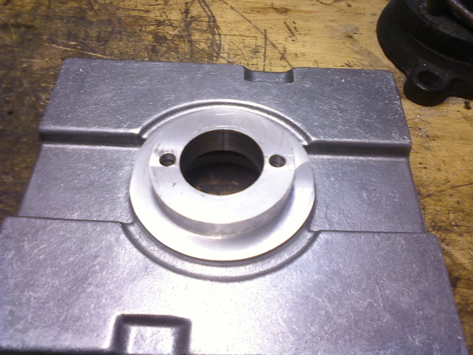

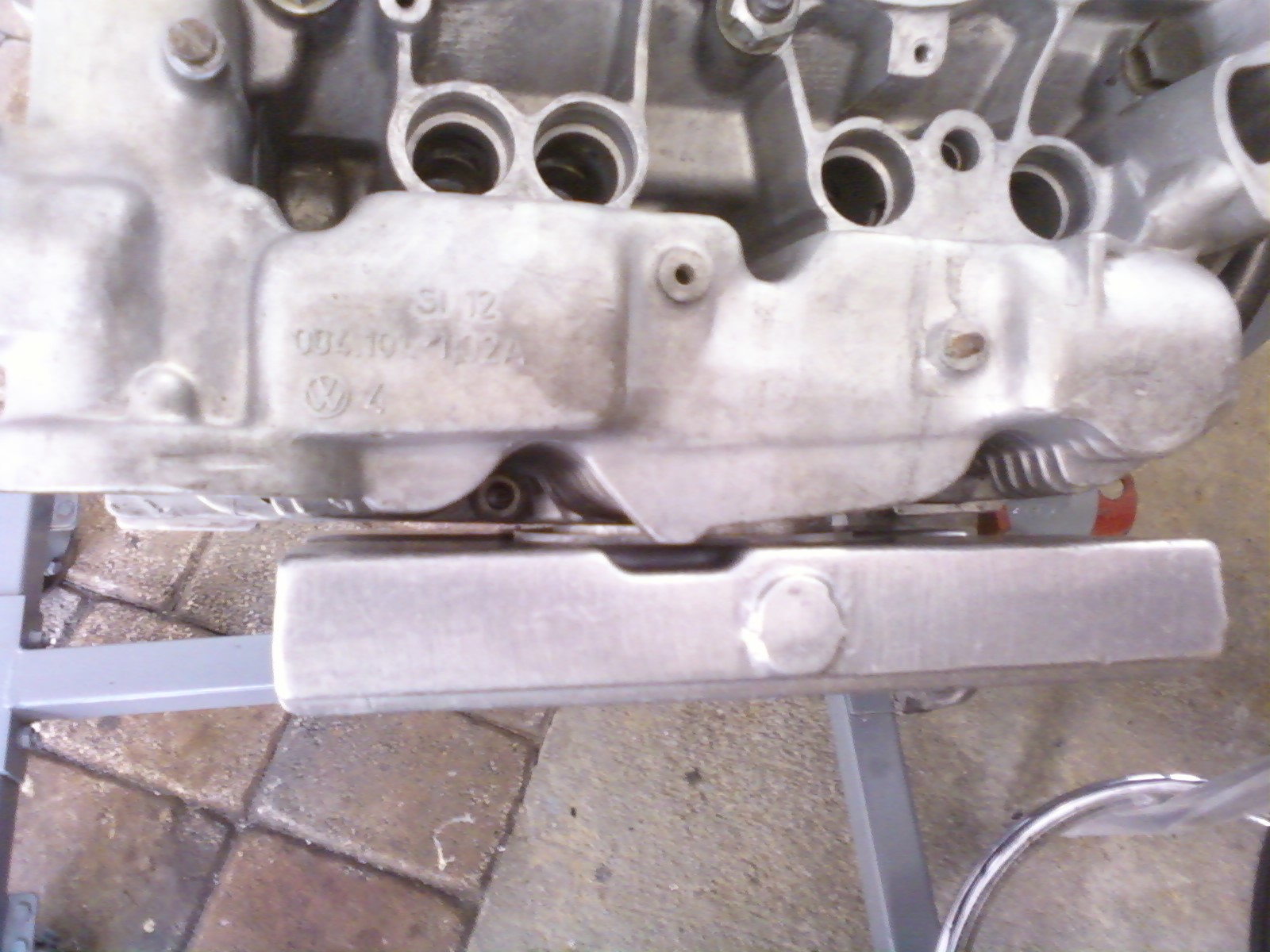

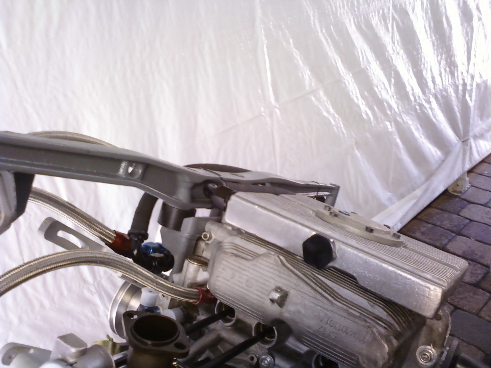

For what it's worth , I run a deep sump that I modified by milling down the mating
surface of the sump ( the round dia. that sits down in pocket of the case) . I milled
an angle on it , so that I could get as close to the bottom of the case , sorry I don't
remember the angle or how much I removed , here's a few pic's , I hope this helps
Bill D.
