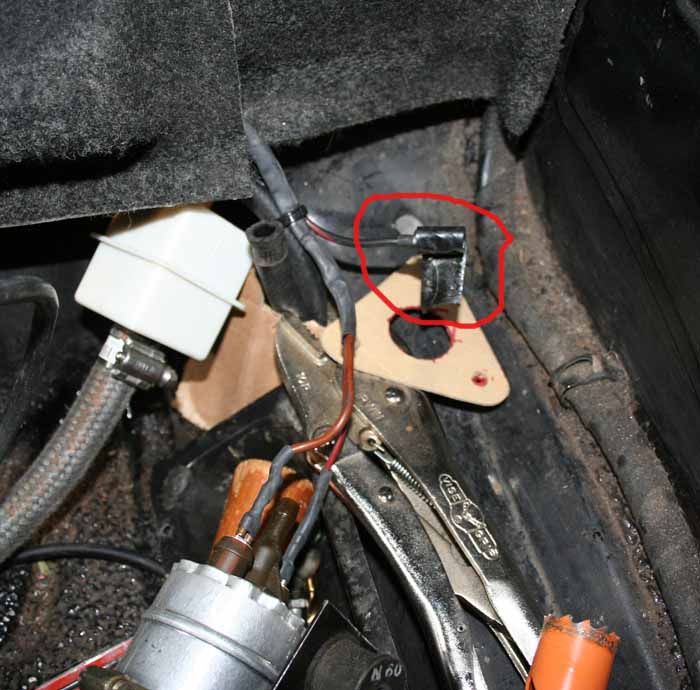

Finally got around to removing my gas tank so I could put in a front sway bar, and I'm happy to report that I didn't find any rust. Just pine needles,
and old wrench and some crappy work by whomever removed the tank before regarding not using the grommets for the brake lines and gas lines. After doing so I now have a couple of questions I'm hoping someone can answer: 1st: Here are the wires that go to my fuel pump, and a third (arrowed) that I'm hoping someone can tell me what it goes to? (It wasn't plugged in when I pulled the pump.) Attached image(s)

davep The third line should be the vent line that goes t... Apr 2 2007, 09:31 AM

Thank you for the responses. :beer1: This m... Apr 2 2007, 03:25 PM
McMark AFAIK, black/red is supposed to run the fuel pump.... Apr 2 2007, 04:51 PM
