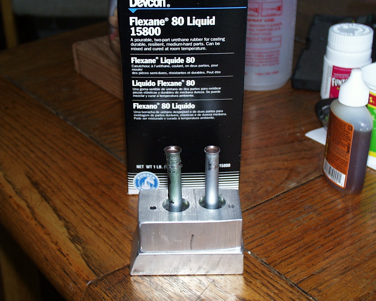

My tub is a '71 so it has separate holes for each line in the front. The holes are slightly oblong but I just used a grommet that was for a 1" hole and a 1/16" panel.
For the rear (you are going to think I'm nuts) I machines a mold out of aluminum to fit the firewall openings and for the 3/8" fuel lines. I used Devcon Flexane 80 to make the grommets.
I realy don't have any tips or tricks, they just slid in but like I said, the engine is out so having room to move around under the car was not a problem.

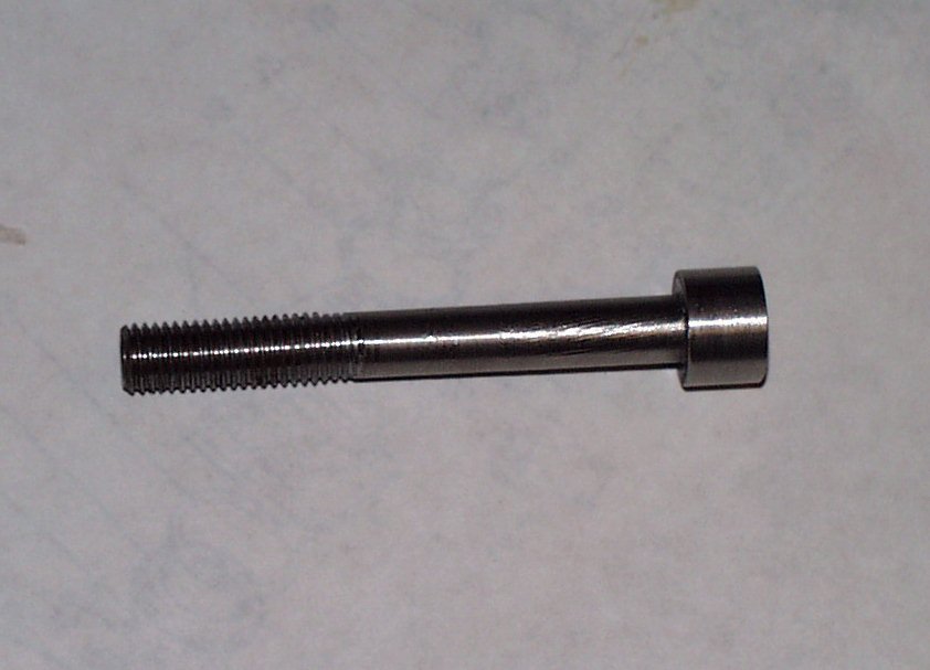

Just to re-enforce this fact (that I am nuts) When I rebuilt my front calipers one of the bolts snaped off. The bolt is a 9mm, try to find one of those in the U.S.! NOT - but you can buy 9mm taps and dies.
Well my solution was to take a 10mm bolt chuck it up in a lathe turn it down to 9mm and the run a die over it.

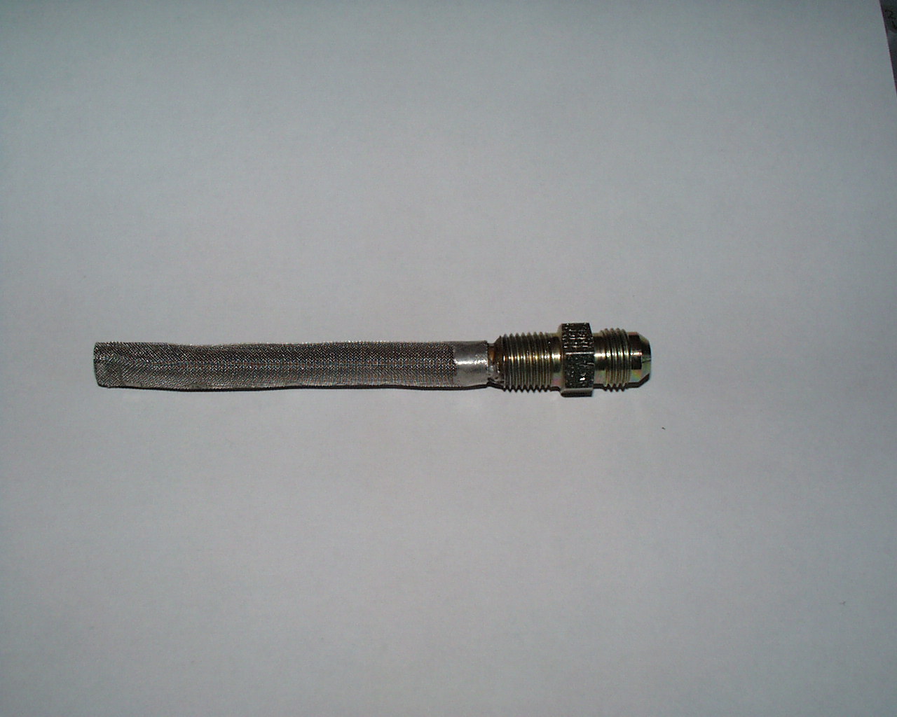

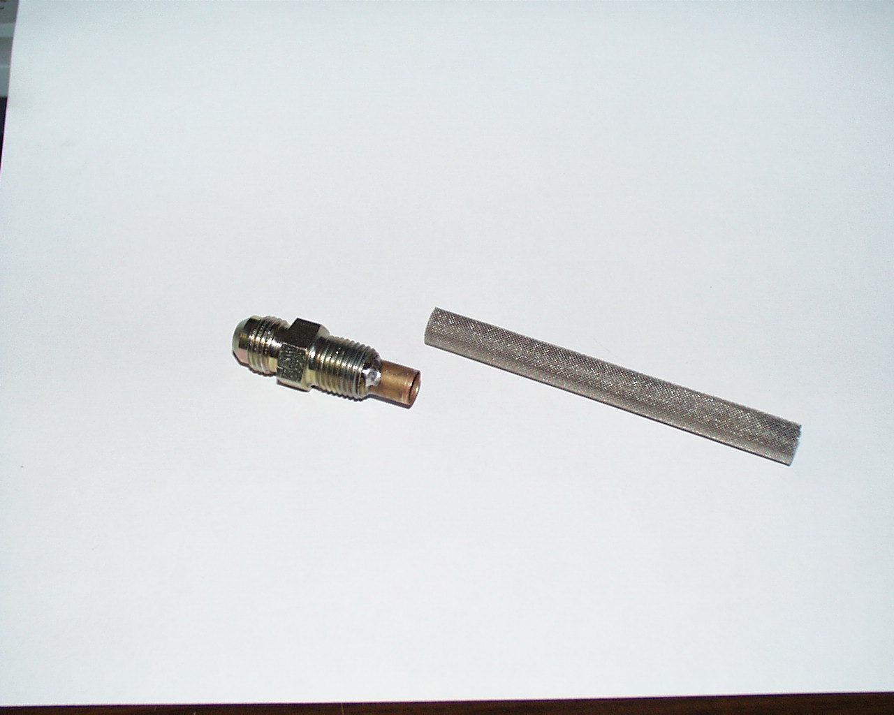

Here's how I did a filter screen.
Steel AN fitting drilled out to .345 in.
Short piece of .343 o.d brass tubing
Stainless steel wire cloth

Next - silver soldered the tube to the AN fitting and rolled the wire cloth into a tube
Phoenix-MN

Finally - Soldered the wire tube to the brass and crimped and soldered the end. It's rugged, removable, and easily cleaned. (IMG:style_emoticons/default/biggrin.gif)
