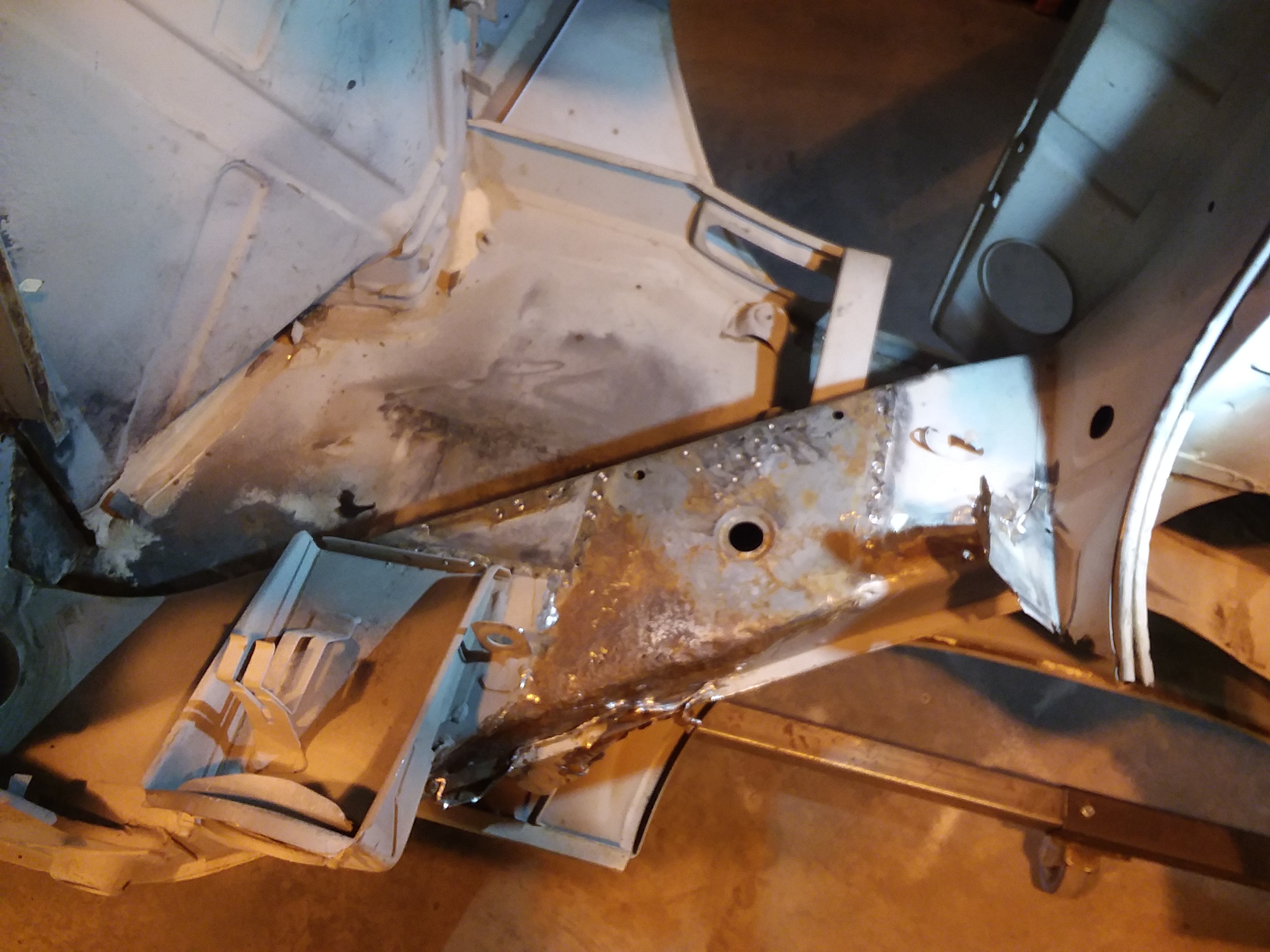

Have not been very active on the forum but still making progress. Don't have any pictures of before or during, but spent the weekend tearing out the rotted suspension. Now for some patch work and the me part us ready for install. Attached Image kooAttached Image

I feel bad. I've been so busy in the other room working with Matt. I haven't taken any pictures when go out and answer Taylor's questions. He did a great job on the suspension console removal. Looks like we'll have a little skin transfusion on the outer layer of the upper long.

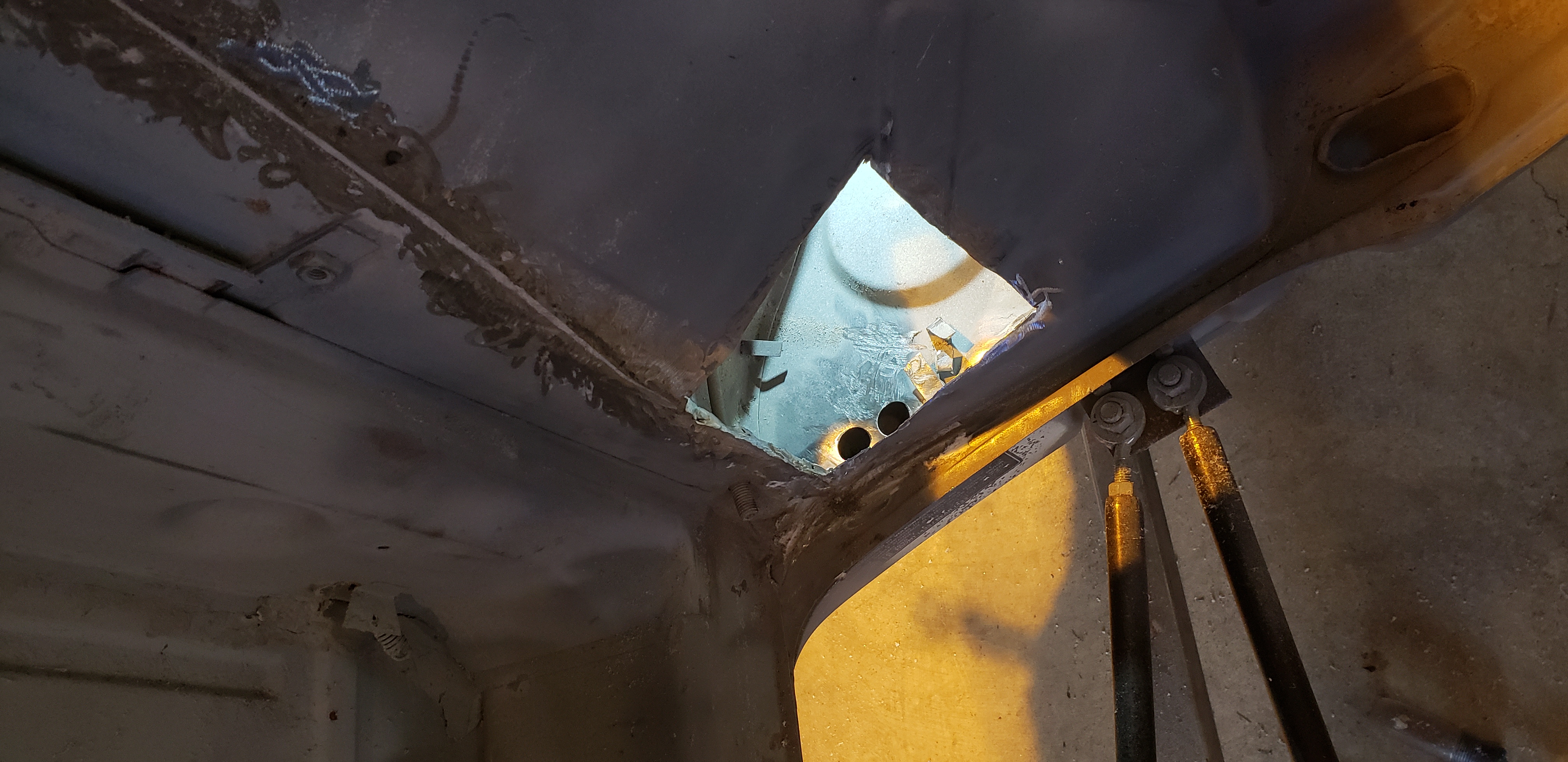

Some good progress was made this weekend on firewall patches. Attached Image

Prepping the donor. Attached Image
