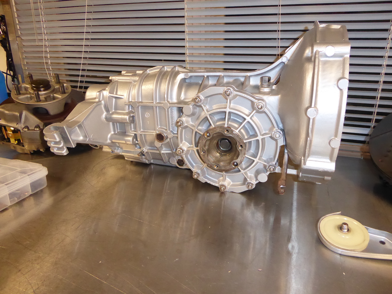

I just cleaned mine really good and painted.....If it come's off I'll touch up. Not a perfect solution but a stop-gap. MarkAttached Image

I cleaned & cleaned again and again, then painted using Zink Phosphate primer & Tempo engine enamel #207 It's holding up well !
