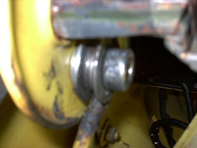

The spring is killer. Made my rollers spring rides on a ball bearing with fender washers as a guide and smaller washers to position bearing and alan lock ring to hold it on. Pic inc

QUOTE(DJsRepS @ Nov 7 2004, 11:14 AM)
Any better pictures? All I see is a yellow and gray blob. If you're having trouble with close-ups, hold the camera farther back and use the zoom function.

better camera and pic

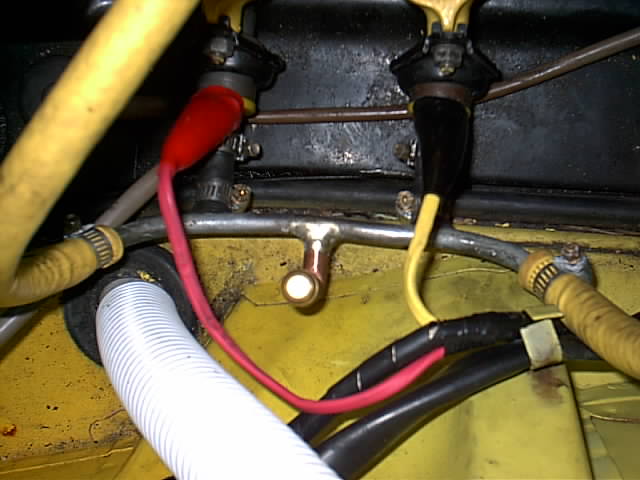

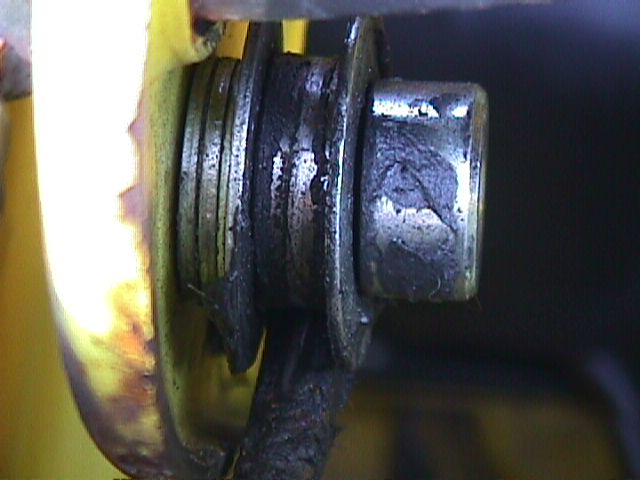

DJsRepS
post Nov 7 2004, 03:47 PM
Posts: 431
Joined: 4-November 04
From: Sarasota Florida
Member No.: 3,060
another pic

DJsREPS,
You really should replace those hose clamps on you fuel lines for the correct type (smooth). The type you have eventually will cut into your hoses.
HTH
