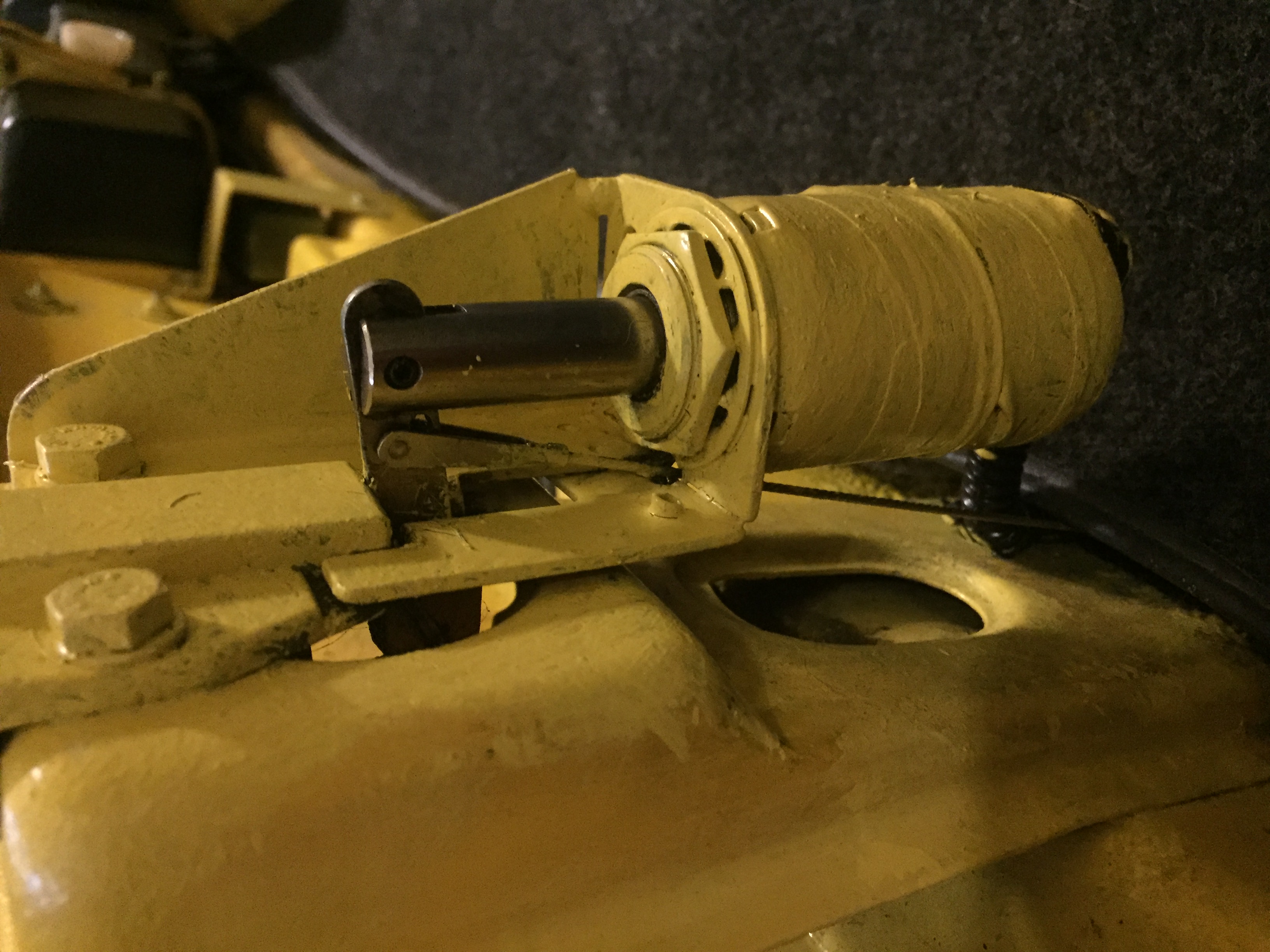

When I had my car wrapped the kids who did it did something to the rear trunk release and I am going in there today. So actually I can hear the solenoid triggering but it's not open, and I will fix that when I am in there. I have read the posts on here and have a pretty good idea how to do it, and have the proper tools. Just want to verify with anyone who has gotten into the rear trunk through the engine compartment.
1) I am assuming you go through the holes that are covered by the plastic caps (guessing strut holes), but how does one who is, shall we say "not as svelte" get in there to get the ratchet back there
2) I have also read about drilling a hole beneath the solenoid and triggering the release that way (Which I am thinking about doing, since I need to put the idiot release in since the DAPO didn't but a failsafe on it).
Anyone got any suggestions since I want to not only get into it today, but also put my new chrome bumpers and bumper tops on this weekend, and I know I need to get into the trunk to do the rear bumper

Yeah, already tried that, which is what I had to do on occasion before. I think they set the solenoid too high, so it's not releasing the latch. I can hear it triggering, but even when pushing on the trunk it won't release. Trust me, the LAST thing I want to do is to have to go into it the way I am, I have been putting this off for about a month or so now.

In response to item 1)
however many extensions you have to put together to reach back there from the opening in the engine bay and a 10mm swivel socket. Unscrew the two bolts that hold the lower latch assembly. OR....... if you can get a long stiff wire in there an reach the lever on the solenoid to try and pull down on it.
Either way it is a big PITA to do. Once open add a wire and drill a hole in the trun floor and drop the wire through there.

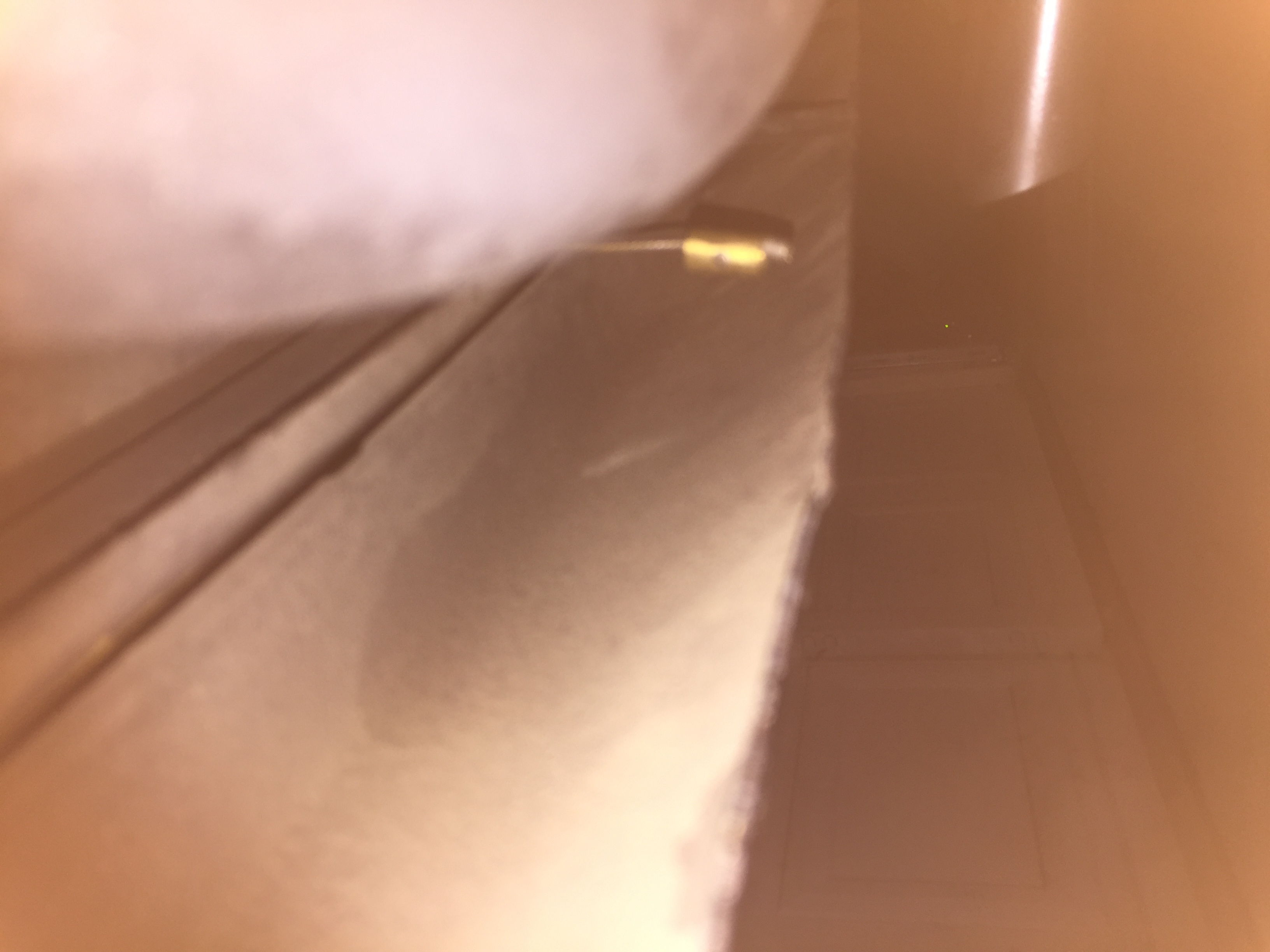

I have a rear reflector lens, so I can not use the original push button. I STRONGLY suggest the you add a small cable attached to the release arm in the trunk and run it through a small hole in the bottom of the trunk. Have the cable end up where it cannot be seen from the back of the car, and put a small pull tip on it, see pictures. I guarantee that at some point the solenoid will stick or the battery is too low and it will not release the trunk lid when you need it most. The cable is a backup that you can always use to open the trunk.
[/quote]
Yeah, I am gathering it's a huge PITA, and yes, the idiot release will be added as soon as it's open. Guess the one thing I need is the swivel socket (which I was wondering about due to the angle)
Yeah, I know, one of those things that I meant to do after I bought it in November, but since it always opened for me I didn't stress too badly on it now. What is it they say about best laid plans? Thanks for posting those pics since I wasn't too sure on how it connected into the solenoid.

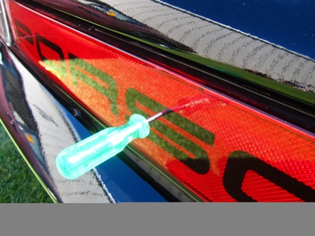

since you have the rear reflector - it is relatively simple
- just drill a 1/8 or 5/32 hole exactly at the top center of the S in P-O-R-S-C-H-E
- push a long thin ground off tiny screwdriver thru it & it will hit the oem lever
i keep a "push-driver" for that in my car at all times

Larry, that worked like a charm!. Took like 30 seconds. For anyone else who is looking for this in the future, instead of grinding down a flathead screwdriver, I just used one of my allen keys that has a handle on it.

QUOTE(Robnxious @ May 21 2017, 10:46 AM) *
here's a picture

If you go this route?, place masking tape over the area where you will be drilling so the plastic will not scratch the rear Porsche lens when it spins on the drill. The reflector is very soft and scratches easily. Go very slow with a smaller bit then go to your end size. Take at easy.
