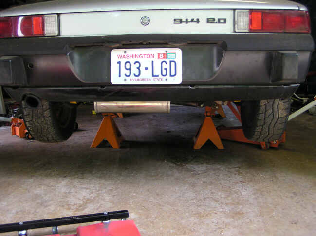

I couldn't find Mile's drawing of a cam (it magically made everything make sense to me) so, I decided to try my hand at it.
First, jack the car up so it assumes the usual and comfortable position of a 914. Resting securely on jackstands. I won't get under it without jackstands cause the thing jumps off of jacks. I have a dented long on the driver's side and a dented rocker panel on the other side to prove it
