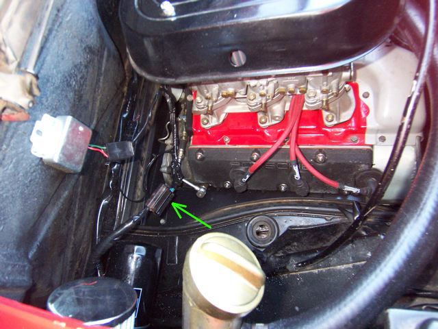

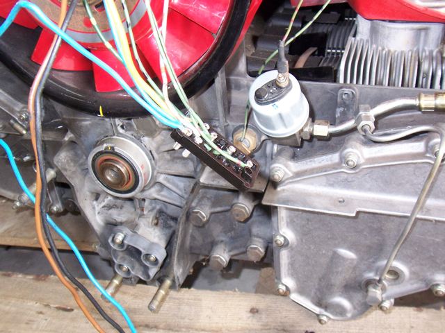

Here's a picture of the male 14-pin on Waide's engine harness.
I have the cap removed so I can rearrange the pins to match the 914.
I then removed the 14-pin male connector from the 914 harness where it used to plug into the firewall side of the relay board and replaced it with a female with the pins arranged to match the engine pin-out.

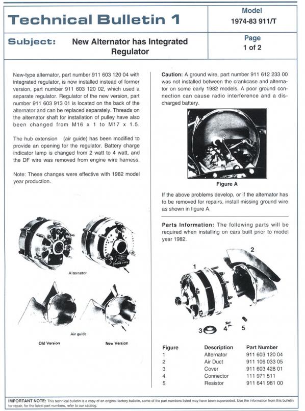

If you get the Porsche Technical Bulletin 1, Model 1974 - 1983 911T, "New Alternator has Integrated Regulator" on replacing external with internal ..... it will tell you exactly what to do.****
**** Just in case you want to retain the /4 relay board.

Can you post it?

QUOTE(Eric_Shea @ May 16 2007, 01:51 PM) *
Can you post it?
I'll see if it will scan tonight ...... don't have a scanner at work (that's hooked up)

QUOTE(Eric_Shea @ May 16 2007, 02:51 PM) *
Can you post it?
Series9

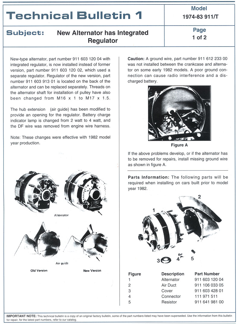

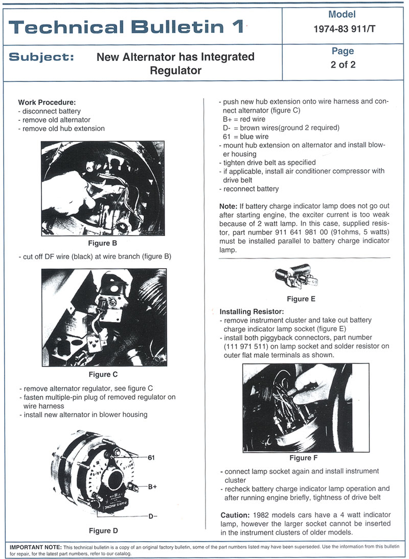

post May 16 2007, 03:12 PM
Lesbians taste like chicken.
Posts: 5,453
Joined: 22-August 04
From: DeLand, FL
Member No.: 2,602
and:
