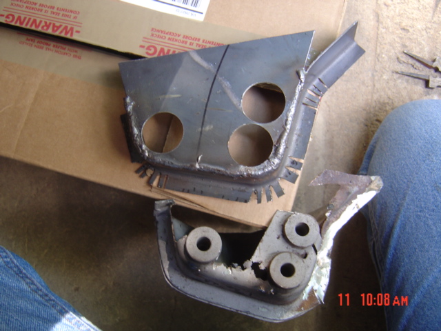

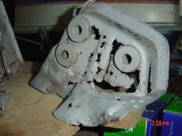

I've been going through my pics to organize them and found these and figured it might be werth posting for those who haven't experienced a console going south. First pic is for clarification of what you will be looking at

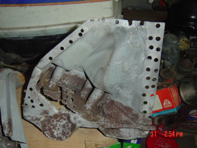

Next pic is after removal and sandblasting. Believe it or not this piece looked fine on the car,all of the rust was actually fused together forming a solid chunk and the paint had not come off. This is a result of the metal rusting from the inside out. This will also give you some idea of how important it is to check these areas and just what sandblasting can do for you!! This console also was NOT collapsed, I had no idea it even needed repair until I began to fix the hell hole!

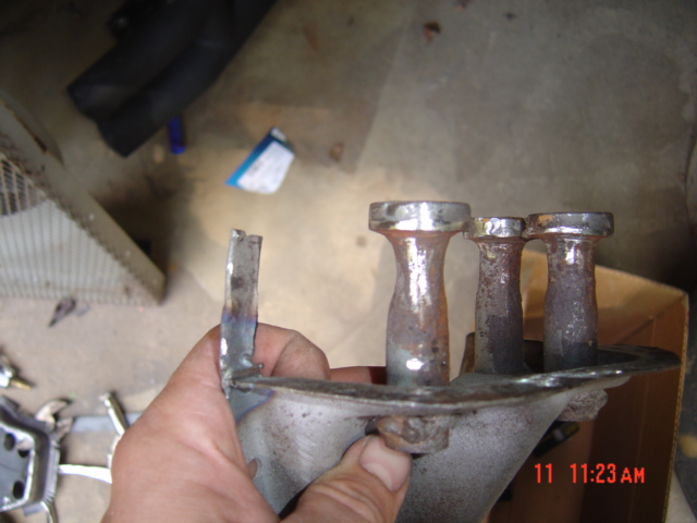

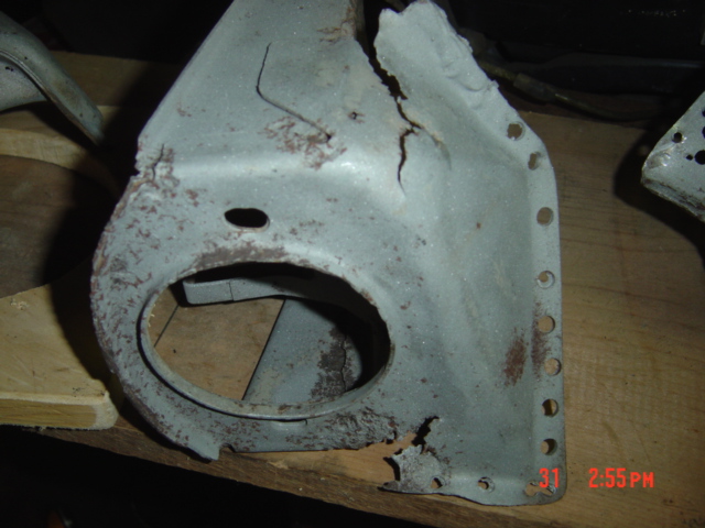

Pic of the inside . More pics of the hell hole/console/upperwall/long repair can be seen here

youch! I've given mine a thorough looksee a few times but you are scaring me again.

This is a good shot of what happens inside. All three of the "support tubes" should be even all the way through but rust has clearly eaten away at the bottoms of all 3. Had these rusted through the whole area would have then pushed upward causing the console to collapse. I didn't actually measure but would guess the thickness to be about 3/8? wall tubing to give you an idea of how much is missing.

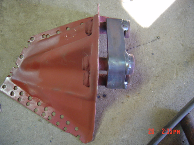

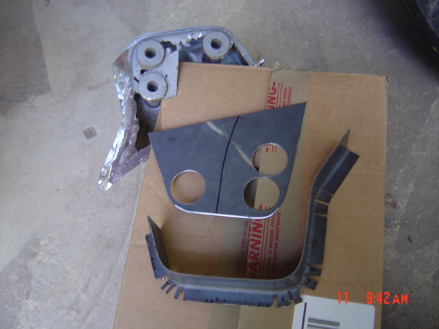

Now for the fun part fixing it all. I must first say that this car is not a "restoration" but will be a nice driver for my dad so I am trying to keep costs and time down. Therfore many of the repairs won't be as nice as what I do at werk but will be done using materials i already have and quickly BUT solidly so there is no need to worry about the safety or return of rust. That siad here we go. First shot is a piece of 1/4 thick flat stock bent to the shape and welded at the ends of the tubes as well as along th shaft on both sides creating a stronger than stock repair. I also sandblasted everything again and took a piece of 40 grit to the tubes to get them nice and shiny.

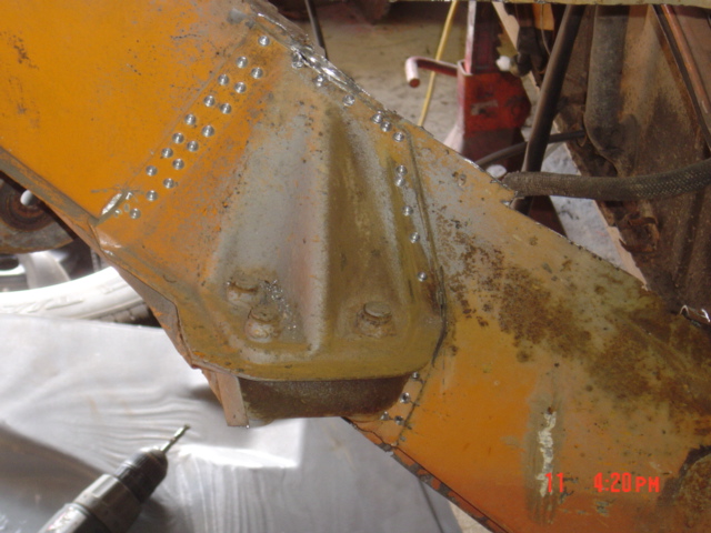

This was done with some 16 gauge sheet I had, simply make a template from construction paper and transfer to the metal and cut!

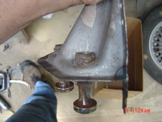

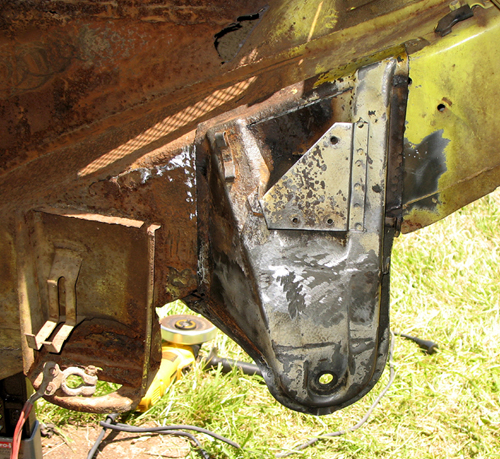

Last pic I took here. I have since finished welding the pieces together and now it sits.......If I ever find time to werk on the car again I will take more pics of the finished console. Obviously there are still a few things to take care of before it is reinstalled but th console is pretty much done (IMG:style_emoticons/default/smile.gif) Before installation I wil be painting the inside with a coat of etch primer then a coat of sealer to give it uber protection

I apologize, but what is the suspension console? Even with your clarification picture
at the beginning my mind can't figure out where the console and the suspension meet. (IMG:style_emoticons/default/blink.gif)

QUOTE(smontanaro @ Jun 2 2006, 11:22 AM) *
I apologize, but what is the suspension console? Even with your clarification picture at the beginning my mind can't figure out where the console and the suspension meet
Take a peek underneath your car, just behind the rocker panel, right in front of a rear tire. You'll see the three bolts in that first photo, but from the bottom side. Where the front of the rear trailing arm bolts to the car.
