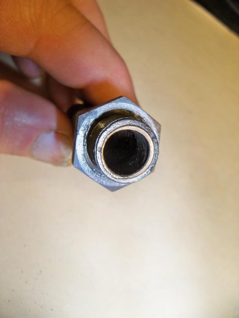

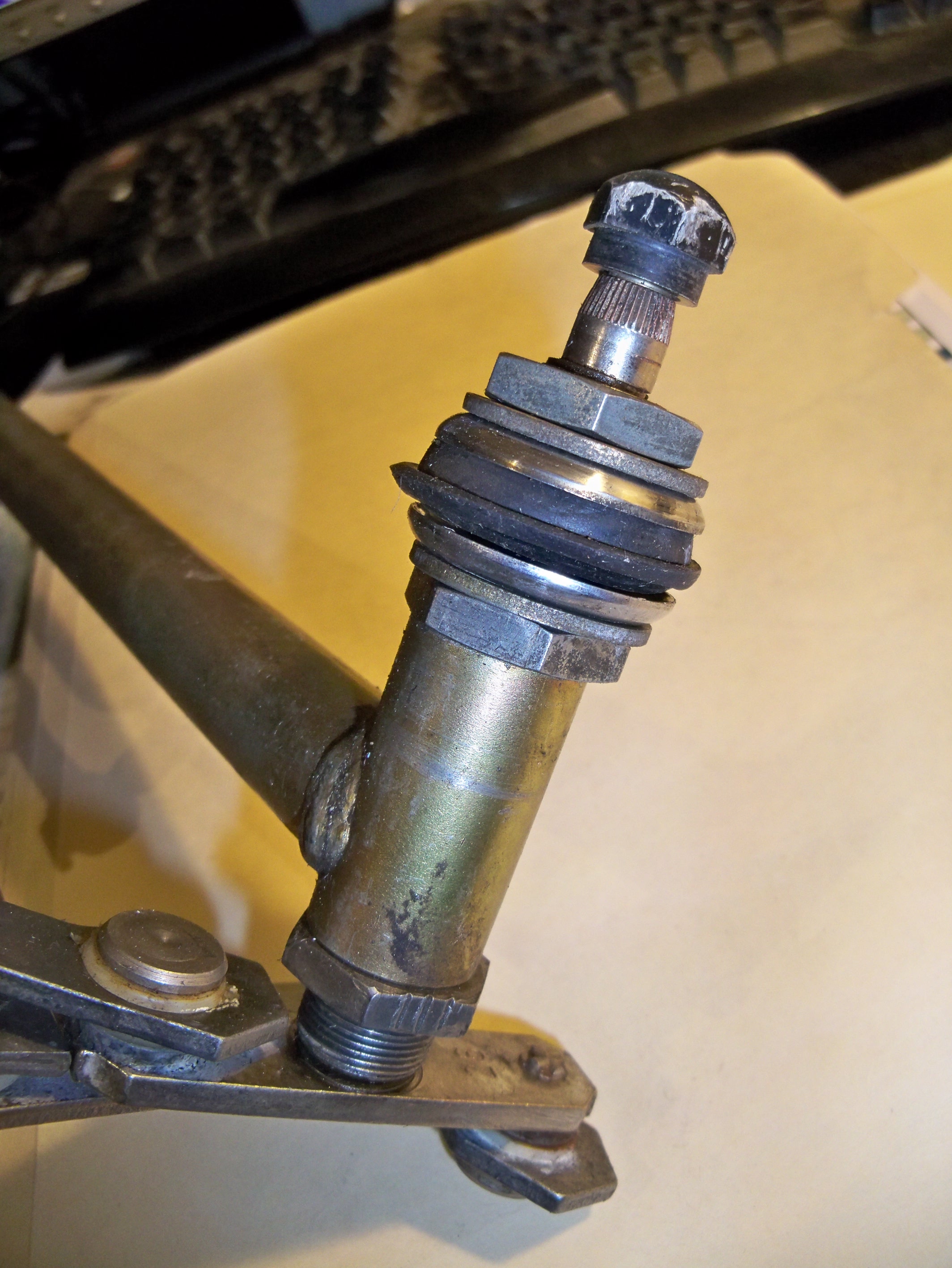

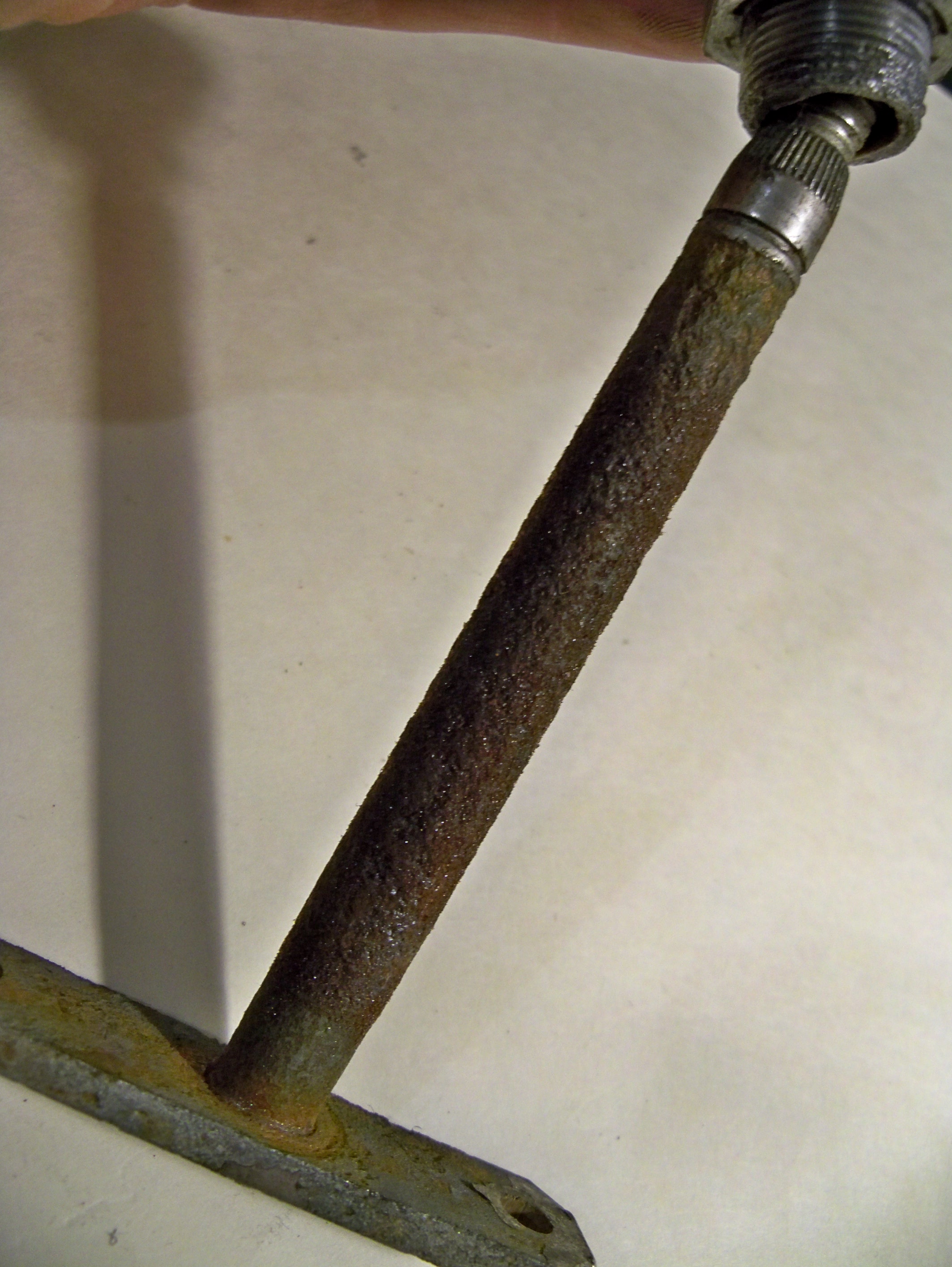

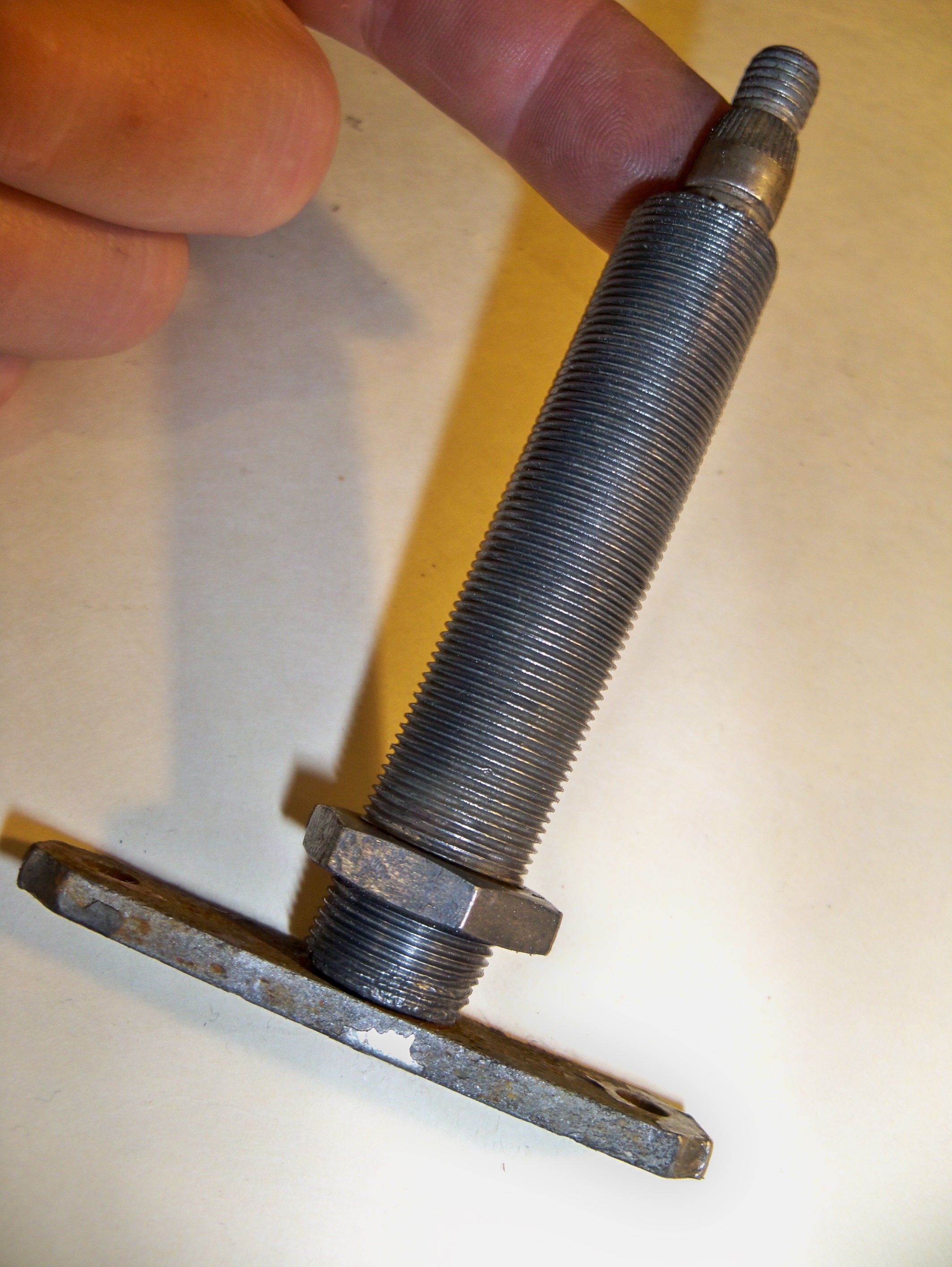

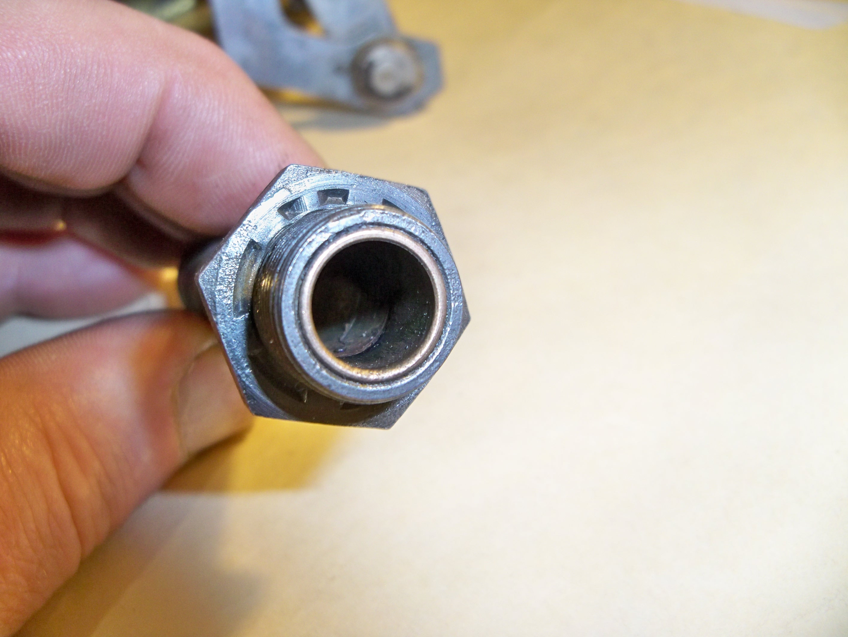

So ... one side of the the offending assembly
The shaft & collar separated from the linkage assy (for pictures)
The hidden ugliness (IMG:style_emoticons/default/sad.gif)
What the compromised shafts do to the collars overtime (the other side was worse)
what the collars are supposed to look like
(IMG:style_emoticons/default/rolleyes.gif)
Root_Werks

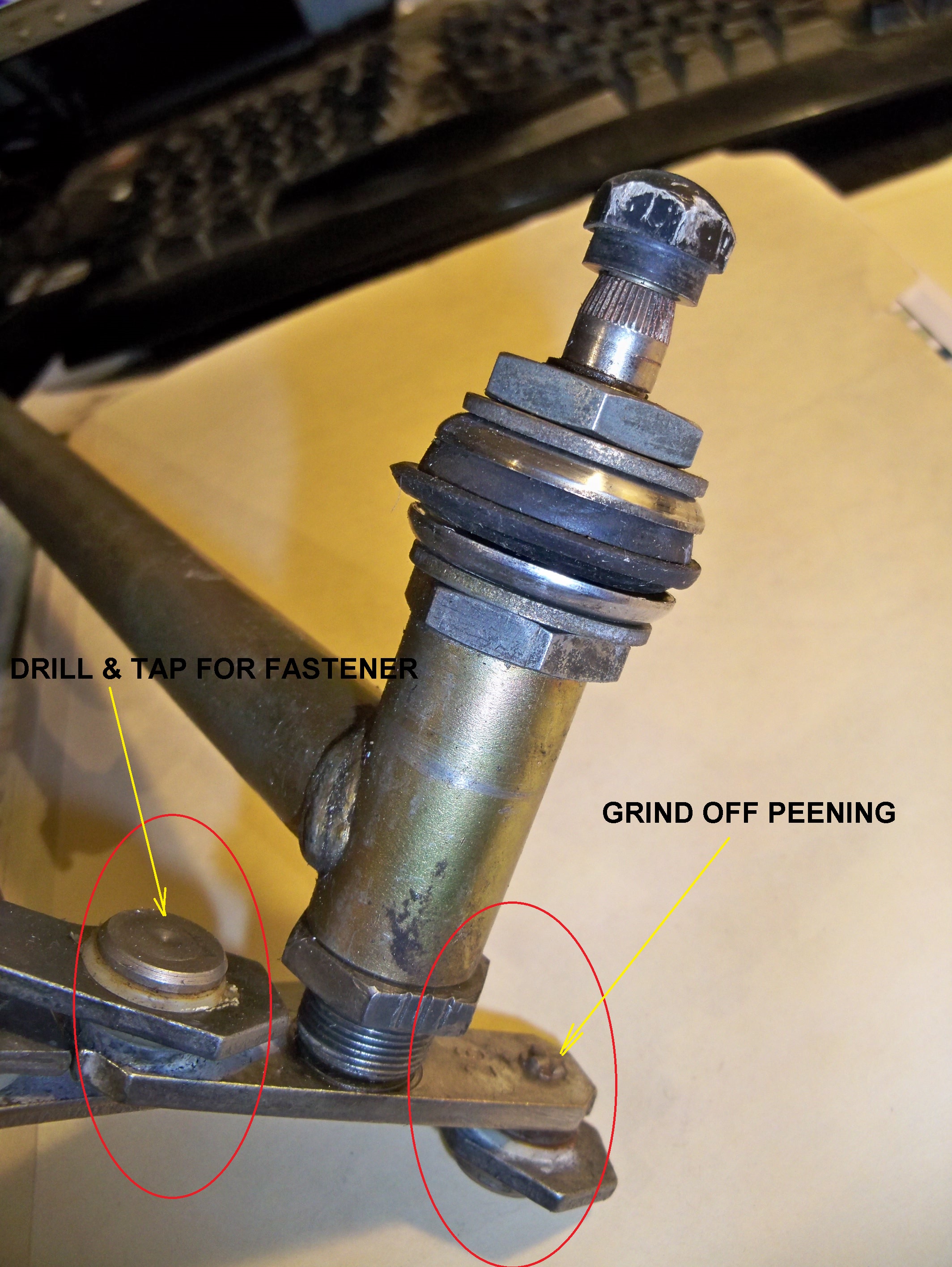

@914werke
Rich, can you post some pics of the fix? What do you do? Sand smooth as best as possible, grease and good to go or get new shafts bushings etc.?
914werke
post Apr 22 2022, 10:08 AM
Posts: 11,404
Joined: 22-March 03
From: USofA
Member No.: 453
Pretty much find a new rack.
I had a couple of (lrg) tubs of racks and tore apart maybe 8 or 9 to find 2 or 3 that were still in good shape. The shafts have to have a fairly tight tolerance in the bushed collars otherwise the wipers will wobble exacerbating the problem.
The other challenge is that racks were not designed for ease of rebuilding / re-bushing.
What I did in figuring out how to "rebuild" them was grind off the peened swivels from the shafts then drill & tap those (what I call) swivels so I could reattach good shafts.
Ultimately a LOT of work. better off finding a rack that is still not worn/rusted to sh*t.

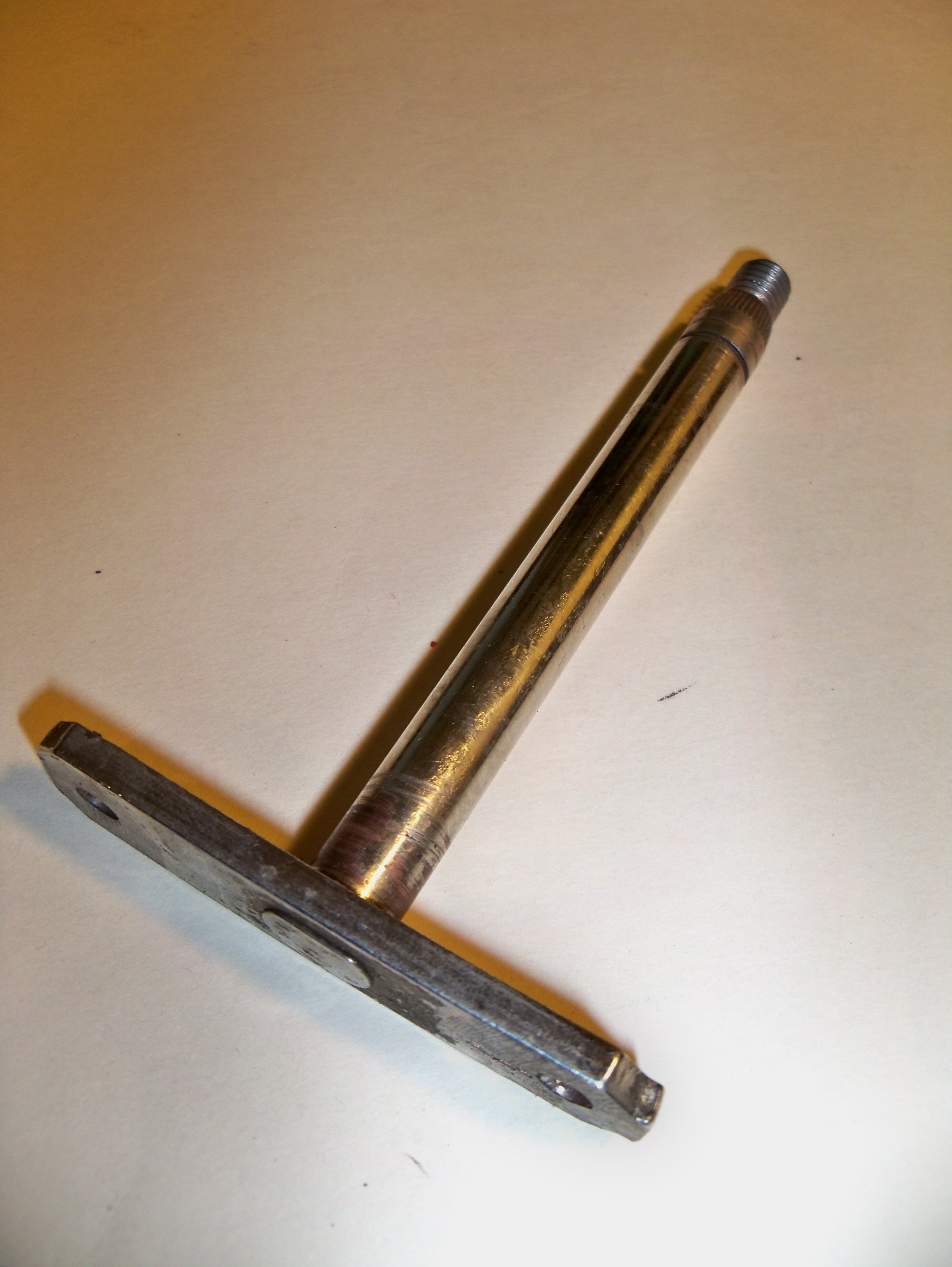

BTW this is what a shaft is supposed to look like
