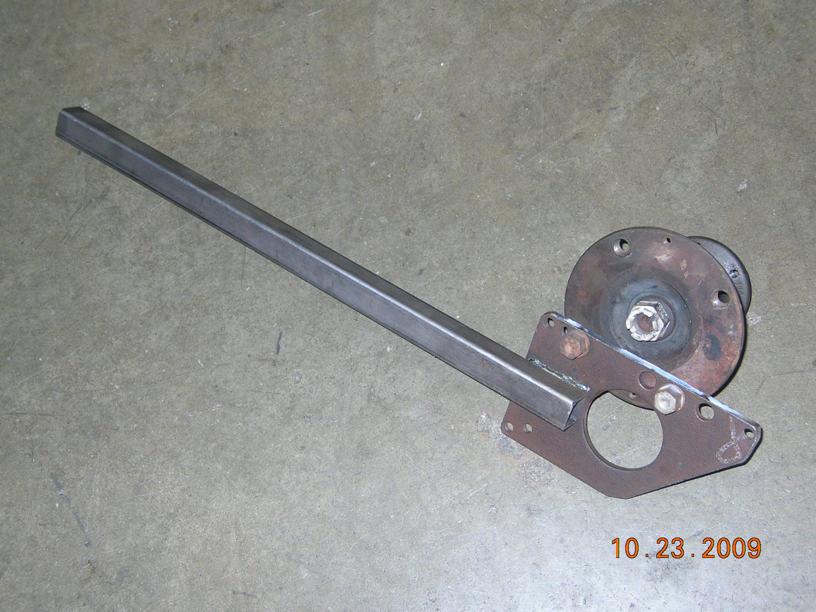

Sorry to hijack, but I was going to start a similar thread myself, except I think I did things in the wrong order. I have no brakes attached, and the tranny is out of the car and I am trying to get the dang nut off now. Any suggestions on how to keep the hub from spinning other than putting the tranny back in and the wheels back on and taking it off jack stands?

This is the tool I used to remove these from a parts car. They will hold the hub against the ground while you use a long breaker bar.
They're called a Helping Hand Tool

I use a 4 ft long piece of 2 inch angle iron, drilled for 2 lug bolts. Propped against the ground, it provides plenty of counter force for the socket, breaker bar, and "extension" (cheater). My bar is drilled for numerous applications, such as flywheels, 4 and 5 lug drums/rotors, front pulleys, and such. The Cap'n

I forgot to include in my post that you do need to have some way of holding the hub stationary.
I also drilled angle iron to fit over the studs on my 914-6 to hold the hub stationary by having the long end resting on the ground. When I went to remove the nut, it did put a slight bend in the bar as well.

Problem solved.....36mm welded onto an iron bar with a slight angle to clear flares.
