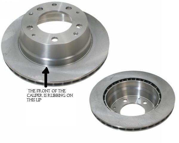

Thanks for the reply Jeff. I would think shrinking this raised area would weaken the integrity of the rotor (see attached picture)? My car is mostly a track car with a cage, so e-brake is not to important. Also I want to use the M Calipers because I can than match the racing brake pad compound of the front calipers wide "A". I am using Hawk Blues, and currently Hawk does not make a pad for the rear 914-4 calipers that I know of.

Eric,
I have a J-west brake bias valve, so I will not be using the stock proportioning valve. will a 5 mm spacer help my caliper from hitting the raised part of the rotor made for the parking brake?
No. It's not made for that application.
As Dave says..., all of those calipers take the same pad. The early 914 front is the same casting as the 911 rear.
So... the caliper you want to use that won't fit, has the same pad size as the one you should use and will fit. The one you should use has a proper 38mm piston and will get you closer to perfect brake bias.
You can still use the fancy biasing valve if you'd like. You'll just have the proper caliper for the job. All good, no downside.
