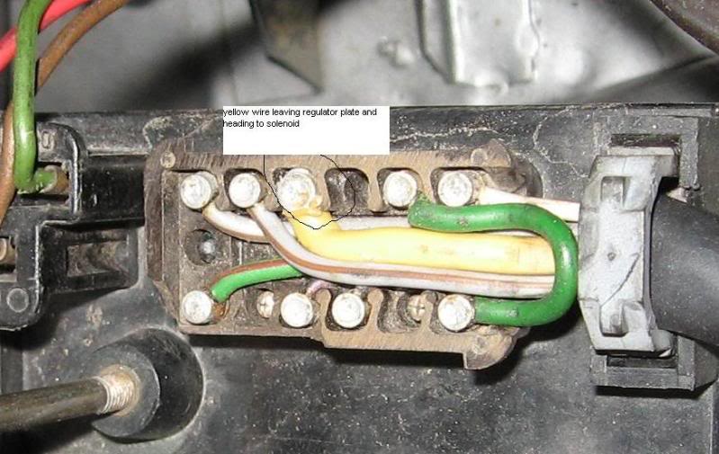

ok there is a green wire in the lever it looks like it switches ground... I have a green wire near the dizzy which I originally thought was the fan according to how I was reading the wiring diagram... I tested it it has no power regardless of lever position , so there must be a relay.. that the lever green wire triggers, I must be missing it it when I'm looking at my diagram.. is it on the the relay board?? I slid in a couple of relays in my empty spots. I dont see a breakdown in the diagram of the relay board and what relays do what,,, I'm sure I am overlooking something

I believe the auxillary fan runs off the same fuse on the relay board as the fuel pump. IIRC it's the rear fuse. Does the blower motor work if you apply 12v?

yep blower works I had it directly to battery for testing... ok found the wiring diagram on the board and the relay clicks if I pull the lever... but I think I should have power at terminal #11 I don't???? if I pull the relay there is power on the socket.. and the relay clicks but no power to terminal 11 ... What am I missing? (IMG:style_emoticons/default/wacko.gif)

Have you tried swapping out the relay with a known good one?
The rearmost relay and rear fuse are part of the blower motor circuit.

Check you tubes up front. I have found that a shop-vac on blowing mode can get junk out of the long tubes. Also check to see that the vents up-front are working.
Depending on the year model you may need a jumper on the relay board that jumpers the fan. It's the green jumper wire in my photo below. Ignore the writing it was from another post.
