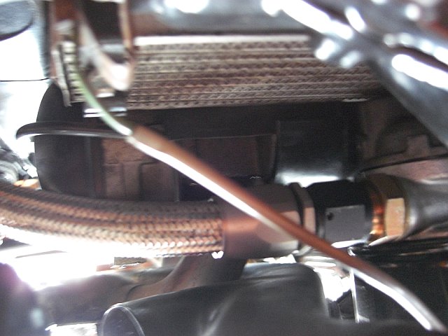

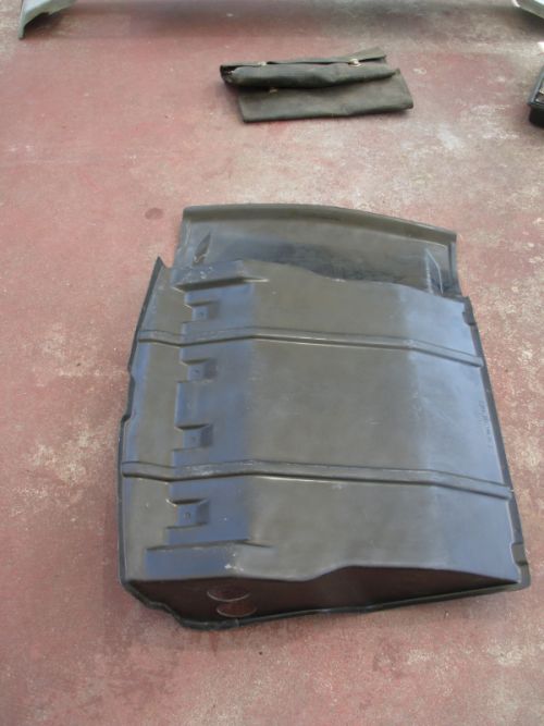

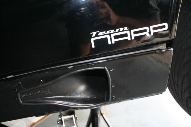

Cooler under left side of trunk. I have a very low airdam in the front with not much air going under car, so installed a scoop in the left rocker panel with a 3 inch duct for the cooler. Got rid of the Home Depot cowl and fabbed one out of sheet metal. I also used the sandwich plate adapter. The one I used has a thermostat built in.

more pics

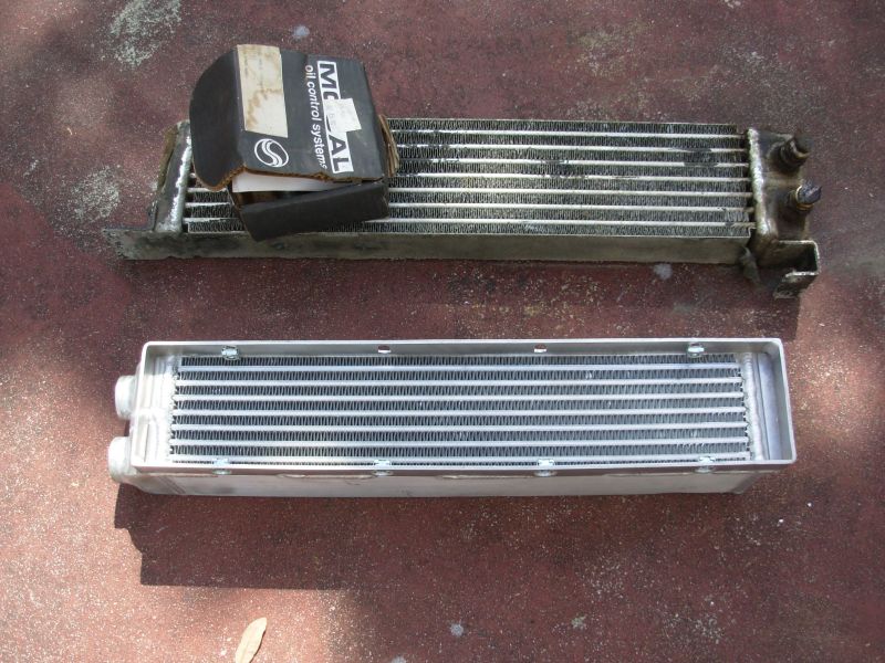

What engine? Is this the small filter behind cylinder #6, the stock filter on a six, or are we talkin' a four cylinder car? Perhaps there's something useful here in any event. As you can see the 993 doesn't have a console mounted cooler like earlier motors. Instead there's a small filter there. Mocal thermostat...
Note: I took off the fan BTW. It cools just fine by convection.
Note: This is an auxiliary cooler. The main cooler is front mounted. The original Earl's cooler (above) sprung a leak (7 yrs later) so I replaced it with a B&N cooler with slightly better BTU removal.
More light...
I'm about to add a transaxle oil cooler behind this one in a couple of weeks so I'll have to add a fan to do them both. I've used -10 plumbing. The trans cooler will use -8. Hope that helps.
Good Luck!

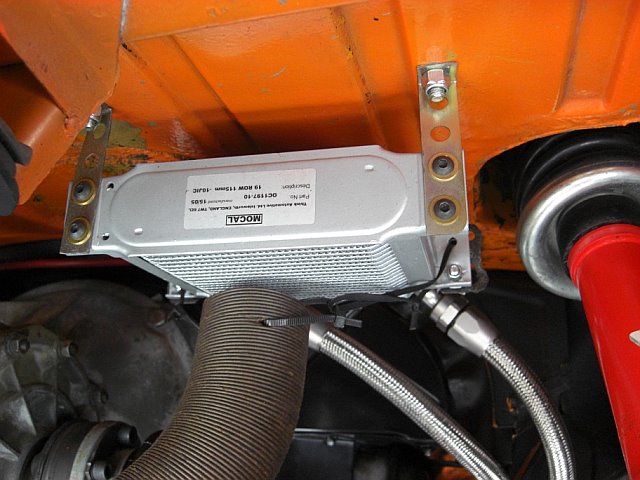

I've done this twice, works "ok" for street, but if you plan on track or bigger motor I'd do front.
Orange car I went maybe one size too small on the cooler 9 row maybe? Ducting was for mock up made a small difference.
Plate adapter with built in thermo, everything was ordered through BAT.

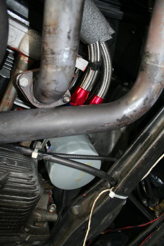

Here's my set-up: Full flow oil, remote filter, by-pass thermostat and simple oil cooler. It all sits on the right side of the transmission since the left side is taken up by the Tangerine exhaust. It's only for street use but I've never seen the oil temperature exceed 2/3 scale on the gauge. That was on a 90+ degree day, stop & go traffic. It's never exceeded half-scale under full load pulling steep hills on the same 90 degree day. The next step would be to add a draw through fan if I needed to. Normally the oil temp gauge runs well below the middle.

zx-niner, wow that is clean. Talk to me a bit about your full flow system. I was toying with this idea, but I don't know much about it.
Where is you filter mounted? Looks like it is attached to the head; what remote mount did you use? and did you use the CB performance oil thermostat?

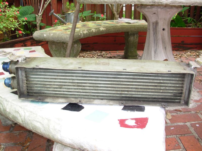

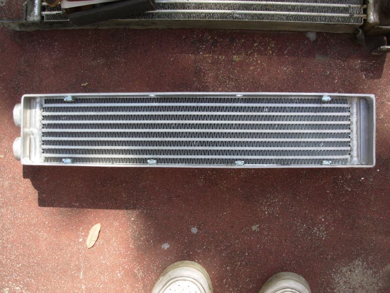

a REAL GT Cooler
a Replica GT Cooler
the Replica GT Cooler under a RX-7

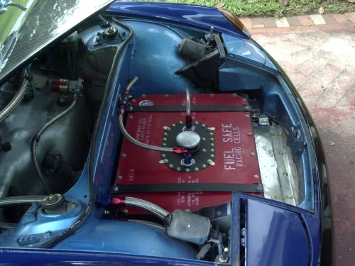

Here is a shroud I made for a front cooler (didn't have much room up there with the fuel cell)

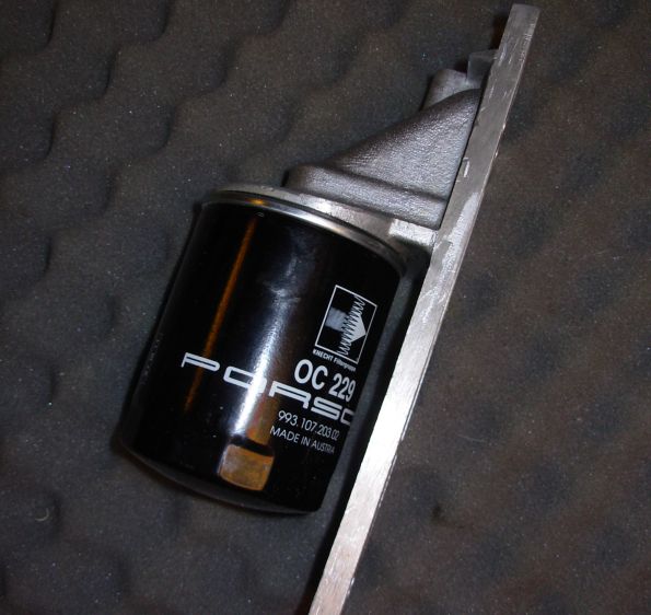

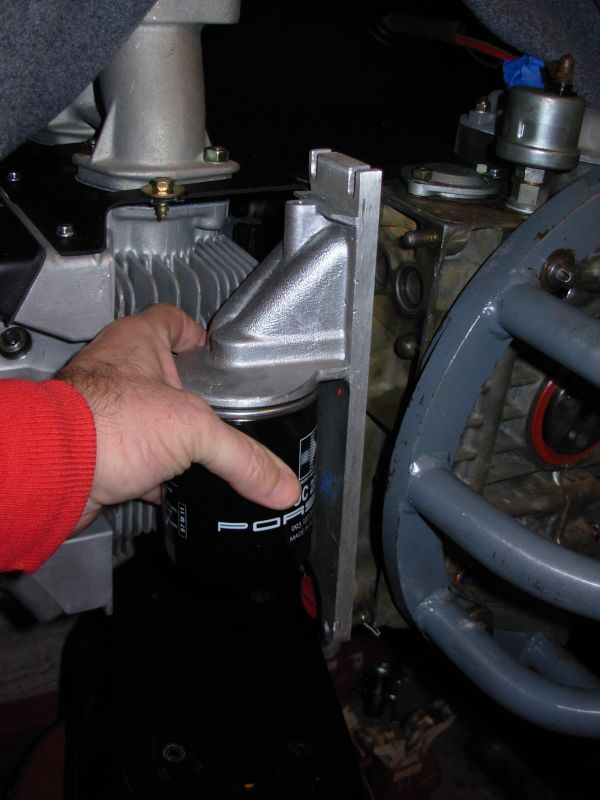

Here is the 993 Oil Console that someone else mentioned and where it mounts to replace the stock Oil Cooler on a -6 ( This Console can be used on other 6 cylinder motors besides the 993)
