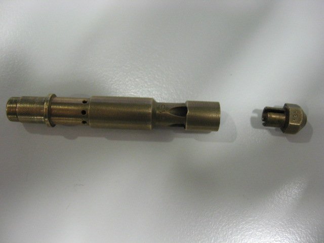

QUOTE(tornik550 @ Aug 11 2010, 09:29 PM) *
The main jets were at 160.
Just for clarity, are you sure you changed the main jet and not the air correction jet?
In the picture below, the main jet is shown away from the emulsion tube on the right. The air correction jet is still attached to the emulsion tube on the left.
(IMG:http://www.914world.com/bbs2/uploads_offsite/uploads.turbosport.co.uk-9101-1281581607.1.jpg)
