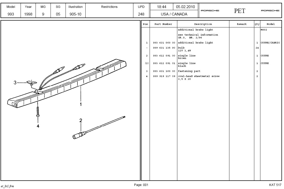

narino
post Aug 13 2010, 02:08 PM
Posts: 234
Joined: 14-August 07
From: Los Angeles, CA
Member No.: 8,001
I think this is the part number if others are looking for it.
993 631 060 00
Though it was almost $300 bucks on PP. yikes! If someone finds a cheap source please chime in.
