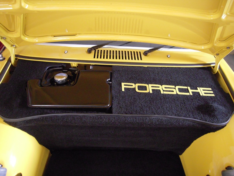

Here is a picture of the cover over my gas tank. I used two pieces.
Jack

Jflash914 that looks very nice and in line with what I was thinking of doing.
What did you use and do you have any tips ?
I was thinking about using 1/4 MDF and felt to match the felt in the trunk. Iwould like to use one piece but I think I may have to use two separate pieces to fit well.
I will be covering the rest of the trunk with felt like Porsche did with the 916.
To answer the other question I will be keeping the CIS.

Wow Jack, that looks great !
With no spare, mine looks positively cavernous (I'm sure I could fit a few dead zombies in there).
