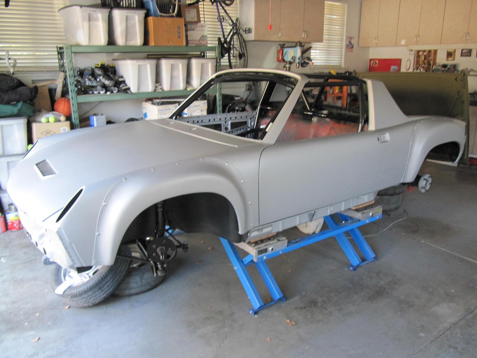

So I have been working like a dog at work, on the house, with my kids, wife and not in this order. The last 20 months have been when the majority of the work has been done. I do enjoy the post here and try to contibute, but I just haven't had the time to make a progress thread. What may or may not be seen in the pics: chasis stiffening kit, engman kit and suspension console reinforcement of my own design. This console reinforcing was detailed on the club site and is in the classics. This car is being built for mostly track use, but I intend for now to keep it street legal...or at least appear like it is. The car started life as a 1972 1.7 I bought for $300 complete with 86k total miles. I got it to run with the replacement of one seal and a used head sensor. I bought it for my ding dong brother who later said he didn't want it. It made sense for me to convert this car for track use rather than butcher up my very nice 75. As luck would have it, about 6 months later I purchased a very wrecked original 70 six with a 3.0L in it........

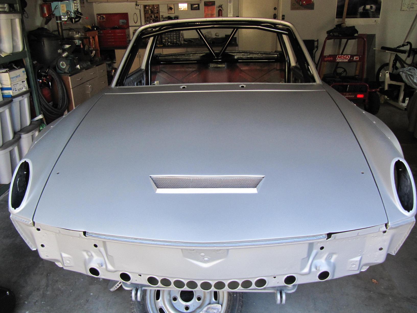

The body on this car is very straight, just uglier than crap. Hood was rusty and dinged up, but it mostly worked out. I made steel panels and welded them in place of the headlights. I intend to put some HID bulbs in the turn buckets

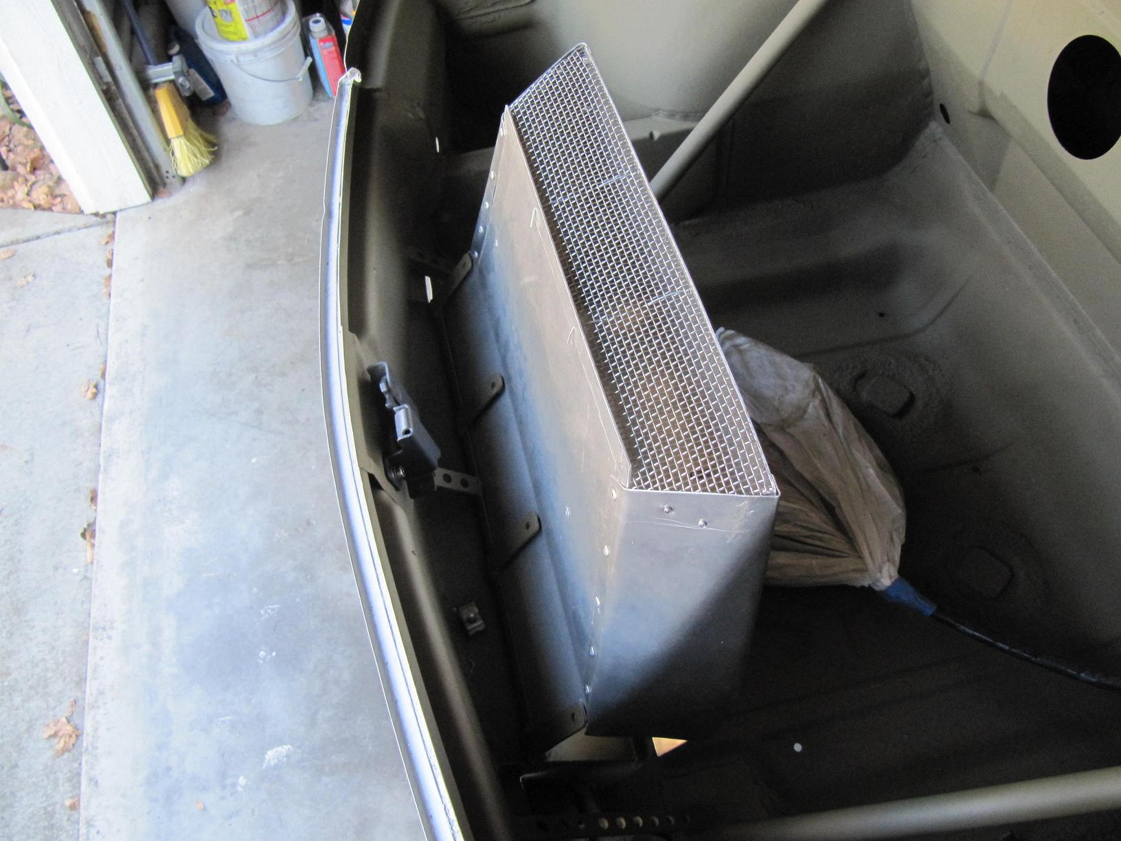

I have an RX-7 cooler with a shroud that I built to vent up through the hood. I will get to these pics prolly another day.

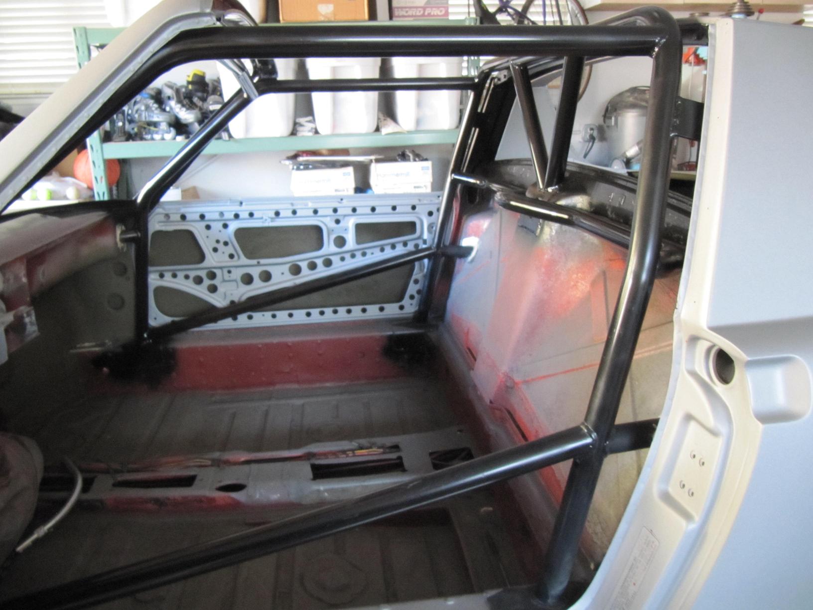

The cage is from Tangerine racing with some other bits I added tying into the front and the rear suspension.

I have some more time to post pictures correctly. The car was painted last month a matte metalic silver. This paint is a polyurethane and looks awsome in the sun. In the garage it looks a little dull. Basically it looks like glass beaded aluminum! The paint is from TCP Global in San Diego. Hot Rod Flats is the color line.

I thought the big rivets, silver paint, and the holes I drilled in the car lent itself nicely to an aviation theme so I'm running with it.

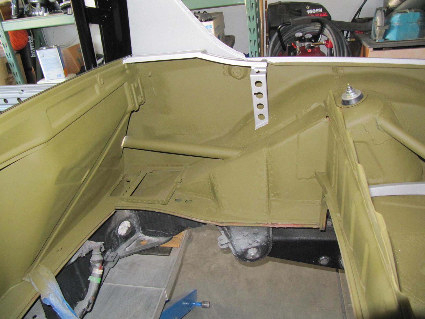

A dozen spray cans of olive drab was easy to do in the front/rear trunks, inside the doors.

Here is the front trunk with my "deluxe" home made shroud. This was fun to do.

I owe some credit to Sir Andy for the how I cut the front lid for the exit. He posted a drawing how he was going to cut and bend the front of the hole up and the rear down for venting out his hood. The exit area is more than twice the intake area. I placed the exit towards the front of the lid after studying the aerodynamics project that was going on at San Diego State? that shows a lower pressure area on the front portion of our trunks ahead of the turn buckets. Will it work.......well see.
