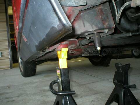

watsonrx13
post May 20 2004, 03:44 PM
Posts: 2,735
Joined: 18-February 03
From: Plant City, FL
Member No.: 312
Wayne, I use the donuts on the front. This also shows how these jack stands fit perfectly into the donuts, I got a set at Sears and another set at Walmart.

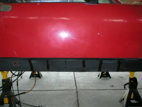

watsonrx13
post May 20 2004, 03:45 PM
Posts: 2,735
Member No.: 312
Here's a shot of them holding up the rear.

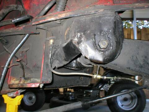

watsonrx13
post May 20 2004, 03:47 PM
Posts: 2,735
Member No.: 312
Finally, here's a shot of all four. I have had the car on these jack stands for about 6 months, I've removed the engine, transmission, front and rear suspension. The car is very stable using the jack stands this way.
