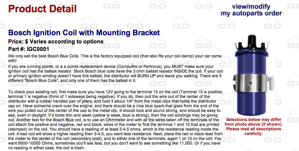

Aftermarket coils will burn points up quick. The Bosch coils have built in ballast resistors. Also worn dizzy bushings will eat points.

No condenser or (bad) low resistance condenser burns points. Running a coil without an internal or external resistor burns points. Nothing special about the blue coils. below is some info about testing the internal resister of a coil, courtesy of aircooled.net.
