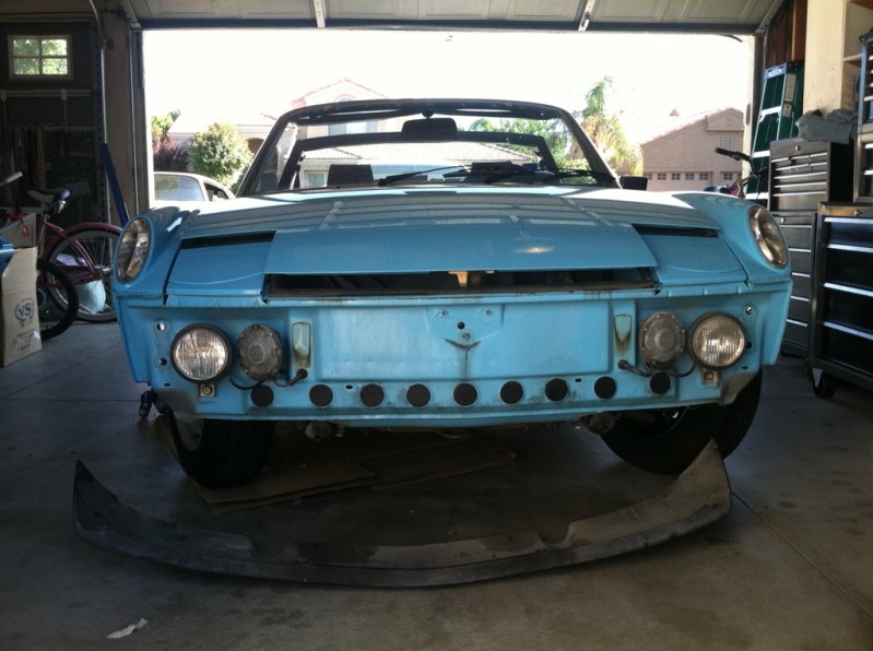

. Removing valance, bumper and lenses for cleaning. I like to remove all brightwork for a thorough clean, polish and wax.

That is incredibly clean behind that bumper for a car that hasn't been "freshened".
From where I sit, I see no rust!
Take some Simichrome (brand) polish to those horns and revel in how nice they'll look behind the fog light grille.

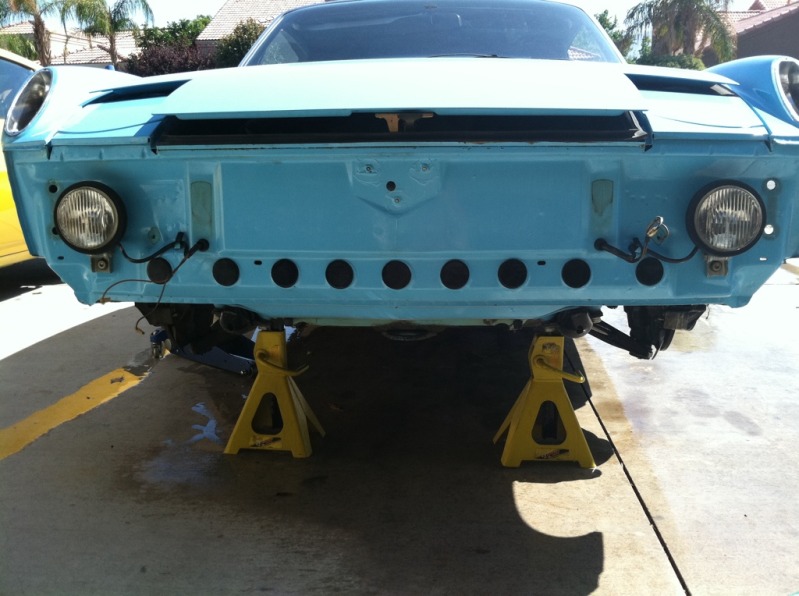

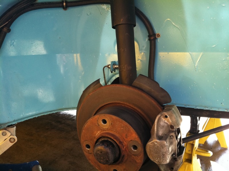

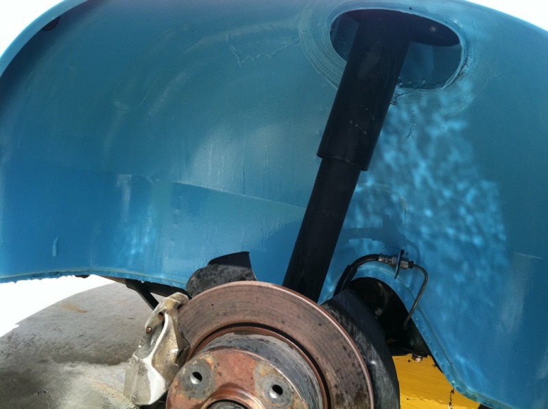

FInally got a break in the heat so I could get back to work on Oly Blue. Cleaned inside front wheel wells today, and behind the bumper.

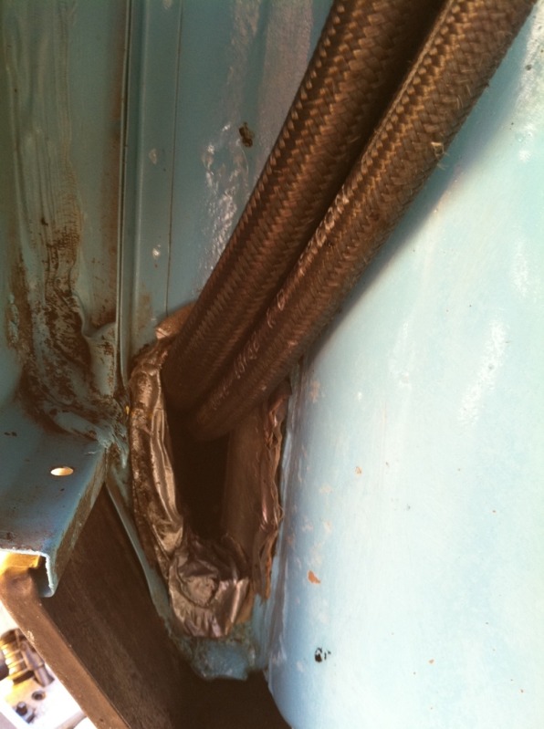

Question for you,. These are the a/c hoses running through into the front trunk. They come out of the side channel with a big wad of duct tape around the hole to protect the hoses. Should I leave it as is, the way the dealer did it, or try to clean that up sonehow, maybe with a proper rubber grommet of some sort??

Can I ask what products and process you're using to do this? The results are looking really great! I'm curious as I'm in the same situation with mine and am willing to put in the work if I can get results like that!
RFoulds
post Sep 12 2011, 02:25 PM
914Rennsport
Posts: 870
Joined: 10-August 09
From: La Quinta, CA
Member No.: 10,656
Sure! Just Autozone store brand Engine Degreaser, a couple of smaller scrub brushes, and a kitchen scrubbing pad for the tar. I tried GUNK brand degreaser and it was not nearly as good.
Just spray the degreaser, wait a minute, scsrub and rinse. It won't all come off the first time, I think it was 3-4 application in each area. I work in a small areas at a time, maybe a sqaure foot is all.
Be careful not to get the degreaser on the rocker panels. it doesnt do well on that flat finish.
Once done with the degreaser and rinsed thoroughly, I wiped it down with Mineral spirits which removes any residue.
Keep in mind though, this car has only 25,000 miles, so there really wasnt a lot of mess to start with. I will take before and after pic on the back ones.
(IMG:http://www.914world.com/bbs2/uploads_offsite/img.photobucket.com-10656-1315796417.1.jpg)
If it were me, I'd find some proper sized grommets & do it the way the dealer should have done it. Of course, maybe they did it right & subsequent work changed it.
You'll want to get or make them split grommets, otherwise you have to discharge the freon, disconnect the lines, string thru the grommets, then recharge the Freon. Ergo why somebody later working on the AC may have cut off the original grommets (if there) & replaced with duct tape.

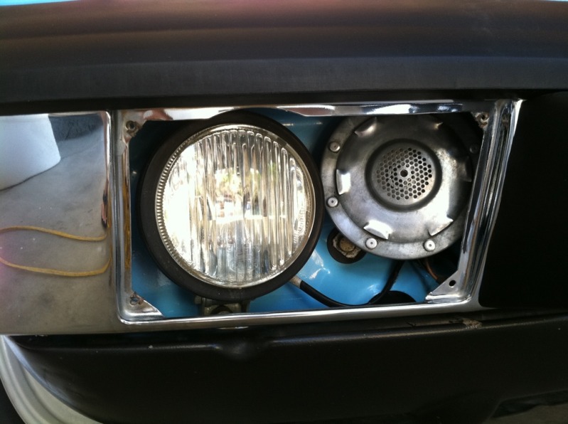

(IMG:http://www.914world.com/bbs2/uploads_offsite/img.photobucket.com-10656-1317156117.1.jpg)
Here are the horns and lights cleaned and reinstalled.
eric9144
post Sep 27 2011, 03:02 PM
Posts: 2,796
Joined: 30-March 11
From: San Diego, CA
Member No.: 12,876
Looks beautiful! Did you replace the lenses on the fogs or were they just in that good of shape? (IMG:style_emoticons/default/drooley.gif)

QUOTE(eric9144 @ Sep 27 2011, 02:02 PM) *
Thanks! No replacement. originals were unmarked, no chips at all. Just needed cleaning. Worked for an hour on the grilles so far. they are very good condition, again, just need cleaning. no easy way to get into the corners between each little louver.
Using mineral spirits and 0000 steel wool so fay has done wonders for it.

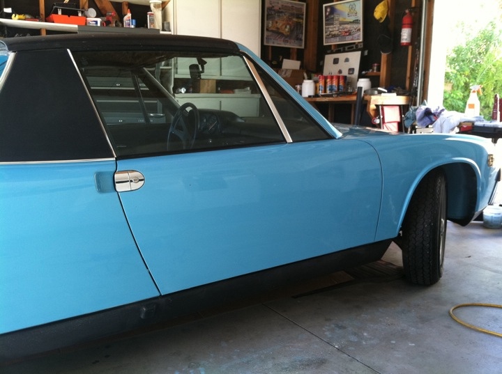

A full day of careful work on each side to remove all residue and hints of the side stripes. wet sanded with 600, then 1000, then 3M light compound at 1800 rpm, then 3M finishing glaze at 2400 rpm. Not a hint of stripe residue.
Finished it off with Menzerna FMJ at 2000 rpm, and P21S carnauba by bare hand.
